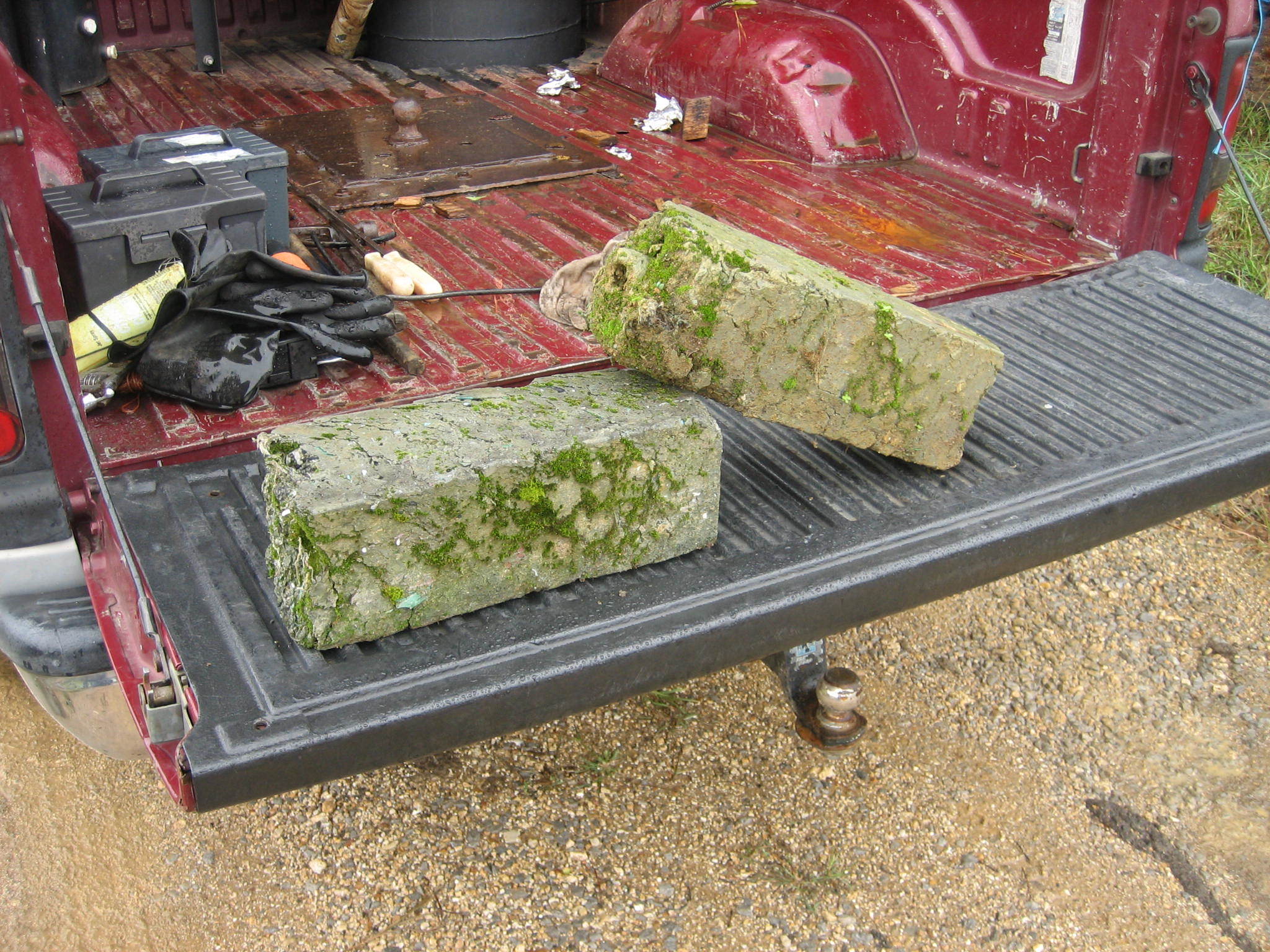

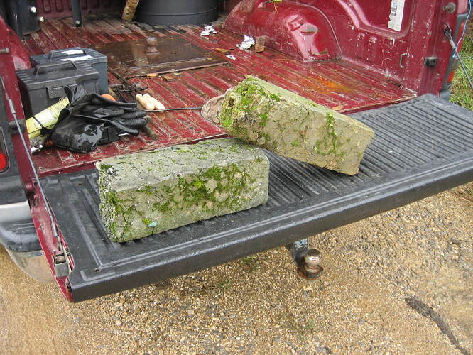

Back in 2008 I ran some fuel test for a company up in TN. The fuel was compressed ( pelletized ) municipal waste ( garbage ) . It included anything you put in the garbage except steel . They had a machine with magnets to remove the steel but it left the aluminum in the fuel .
Most of the driving was done with 3 inch diameter chunks . The fuel did OK if mixed with wood , I drove the 91 dakota several hundred miles testing .

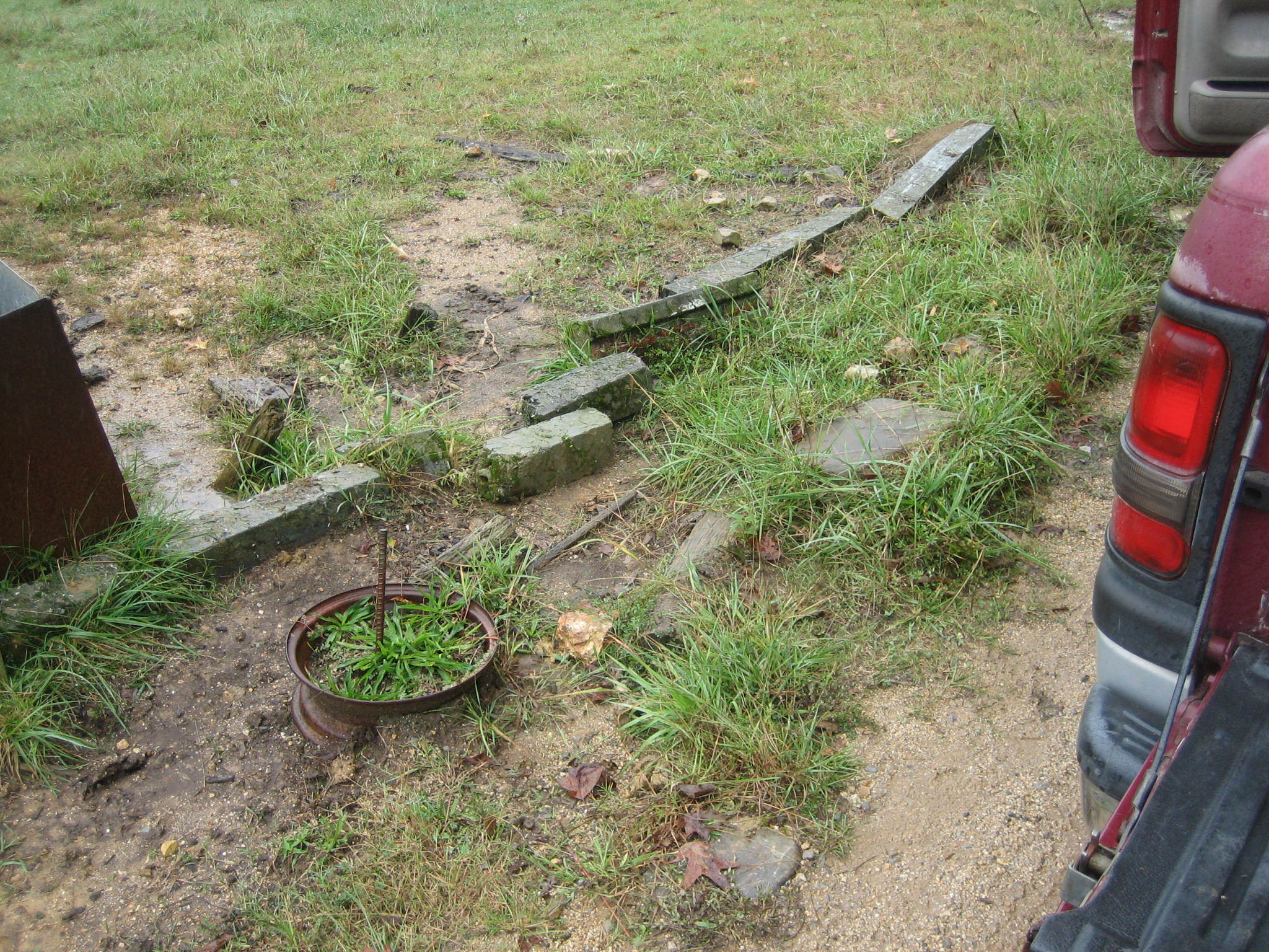

Also I would ax some fist size pieces from huge lengths ( picture below ) . Second pic shows left over pieces thrown out to help with soil erosion .
