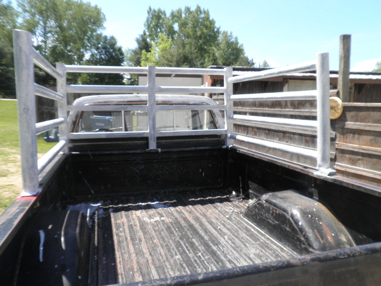

I got some white primer on it till it gets heat tested before painting.Working on truck, mig a few holes in tin before painting,its been in michigan 10 years too long for my idiot bondo stick.solid texas truck otherwise.IF MY PICS ARE TOO BIG LET ME KNOW, I will try and down size, or just delete after judgeig the cooling area,THANKS
Looks good Kevin, the pics are just the right size. Remember, all the paint you put on the rails will act as insulation. Iā€™m going to sand mine back to the galvanize. This last week I was limited by not enough cooling in the rails. (Black paint + sunshine) The rear PVC fittings would go over 200F, so I would back off, and add a little gasoline.
Thanks carl on the paint thickness, I may have too burn some off before painting,couldent stand the rusty pipe,and the shiny galvinized,maybe silver paint would work ok too transfer the heat out.and add pipe too back of the box, WHAT footage of pipe on your dakota,THANKS

Looks good Kevin. Do you have a way to clean the rails?
Not yet still gathering varios size fitings, i like the srew in type fitings other than the hay filter check port.THANKS on the looks good,I think its close too welded,but not without a lot of scribeling, by the time i found the loose switch wireing i had the rack finely welded.welded good than cool, then good and so on,BBBBBBBBB.
