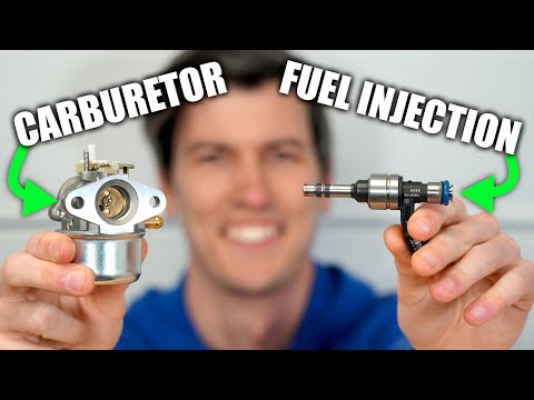

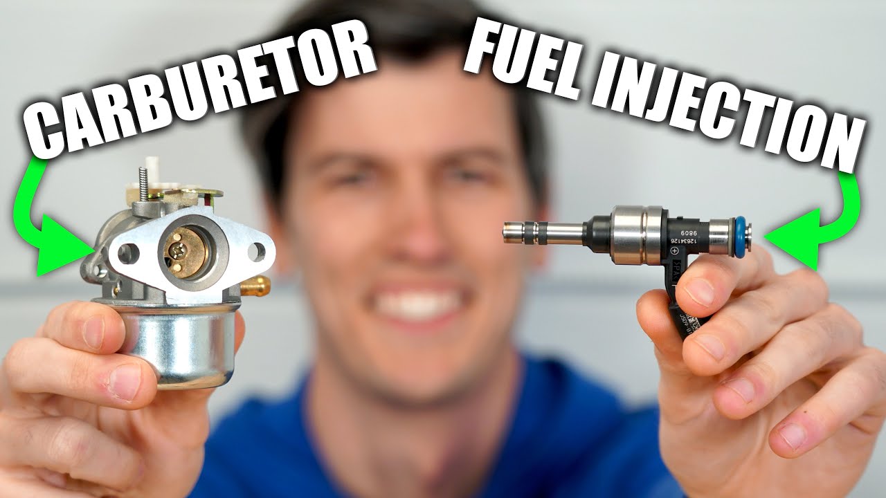

A good video about fuel systems.

PS . Also I just learned from the above video that I may be cleaning my intake valves by letting the motor have a little gasoline now and then .
