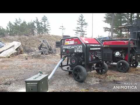

Regardless if its just gasoline or a multi fuel set up. Woodgas is adapted the same way. You dont need to modify anything, you just need to remove and replace the air box with an adaptor you can feed the gas / air mix hose to.
See my video here,
