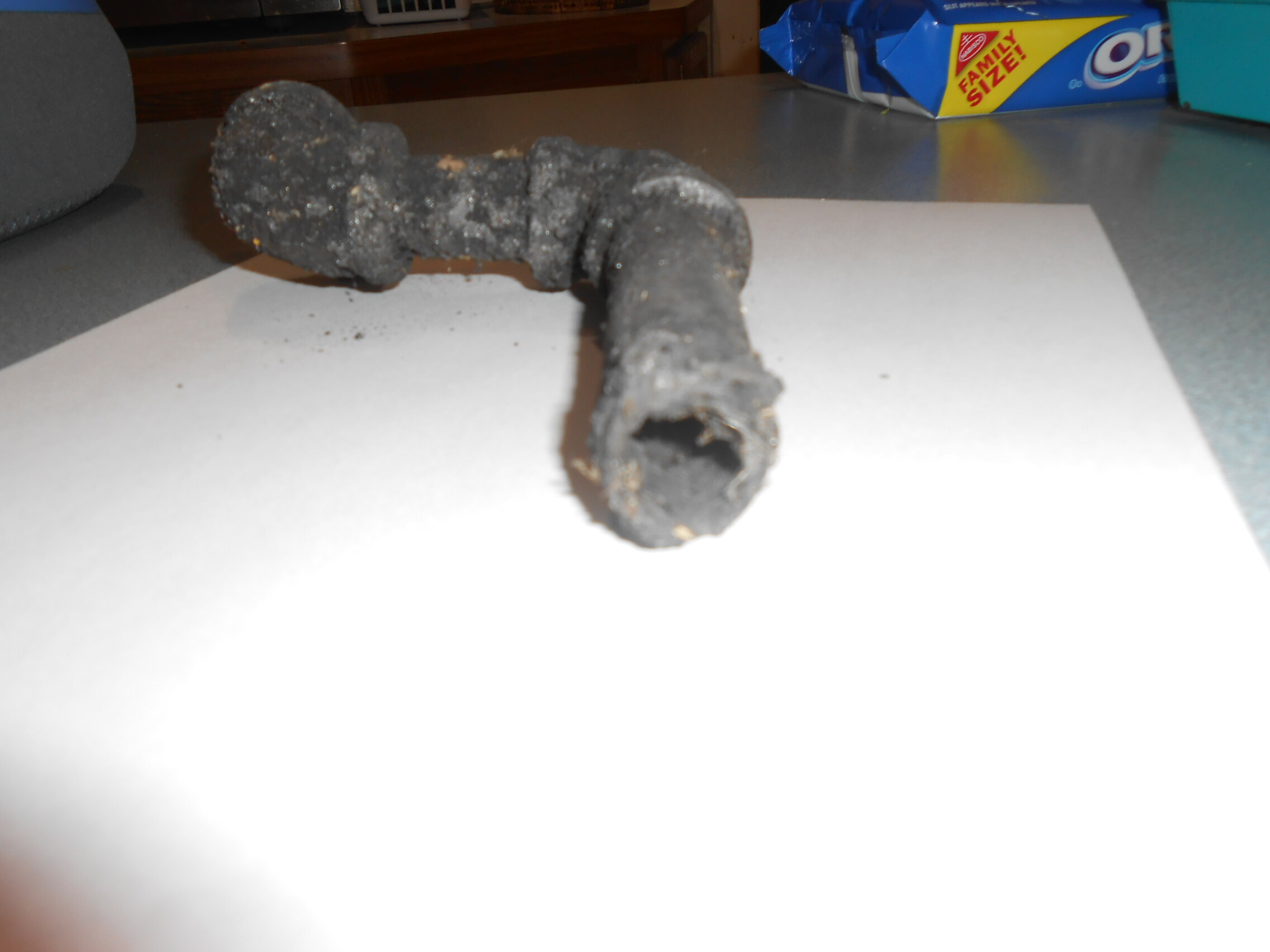

Pipe I had as single nozzle for gasifier . As a fix for leak that caused all gas to burn in gasifier .
Fixing that caused many more leaks , results of which I am yet to experience . What , were and how much .

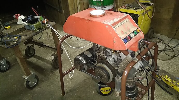

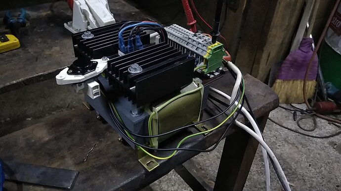

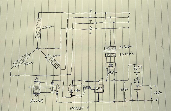

These days I occasionally dealt with the regulation of the voltage on the generator, I used a three-phase transformer, where I get 28 V with a rectifier at a generator voltage of 3x400V. The regulation is taken care of by the regulator from the car alternator, to which I have to amplify the output with a mosfet transistor
