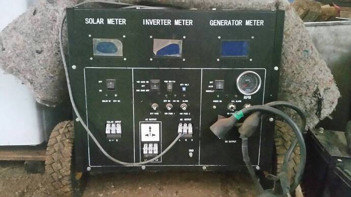

Hi all, does anyone know anything about Power Jack inverters on Ebay? They get mixed reviews. I am looking at 10k inverters.
Yes Al , both Brian and myself use PowerJack inverters , they must be the LF versions though , i have 2x8kw units and Brian has a 5kw unit , they are all ups and battery charging Lf units and are all sat out side undercover but NOT in sealed room and so one of mine did spit the dummy after 4 years use when cloud came rolling in and board got damp ., but i contacted Power jack and they sent me a new board ($100), but really it wasnt needed as it was just the mosfets that needed replacing .they cost about $90 , ,
The latest Powerjack units are a million miles from the early junk they shipped out , these new units are much better at standby current and will take a hefty over use for short time spells without too much damage , they also use VERY heavy torroid transformers .
i give mine the thumbs up for price ,the ups side works well if you want that part of it , and the battery charging side also works well for me , all be it a little less than the advertised 100 amp , but then again maybe i never take my batteries down that low they can accept the 100 amps , oh well still a bargain as far as mine go .
Ignore the fancy LCD screen telling you how much power its making or saving ect as its not really uesfull , what it really needed was a amps output /input and voltage input /output , i just bought cheap power meters and shunts from ebay in the end to do that job .
If you can grab one of these i would highly recommend it , PowerJack call it a smart charger .
i won mine on ebay over 2 years ago ($600) , i have a change over switch on my utility board and can flick it over to my own power source from the mains coming into this unit, and this runs on 24 volt battery banks that are charged via solar and with a 8KW inverter /charger when they go down below a set point there is a small engine in the back that fires up automatically and start charging the batterys back up while generating enuff power to carry on using the unit , very quiet it is as well
