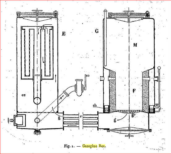

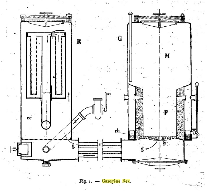

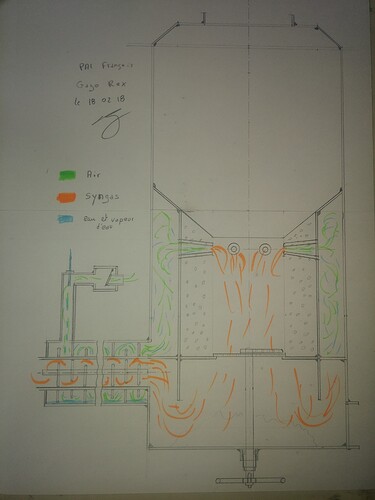

the first photo is a 1930s rex gasifier, this type of gasifier is specially designed for carbonite, and the second photo is the project of the recumbent bike gasifier with motorized trailer, its independant design is three times smaller than the original.
Hi Francois,
I like your sketch of the gasifier for the bike. Especially the way you use the heat of the gas to preheat the incoming air and water/steam.
You can only use about half of the heat of the gas to preheat the air, but if you use it to evaporate water a higher amount can be used.
With a downdraft gasifier tar in the gas should not be a big problem. In Sweden, this types of charcoal gasifiers were quite popular because there was often not top quality charcoal available.
Looking forward to see it!

can you explain ? why only half of the heat can be used?![]()
Hi, Trigaux!
26.3.2018
Only 37,5% ! Of the outgoing physical heat can be theoretically returned;
Because the outgoing gas has so much bigger volume (carbone addiction and water reduction)
At 0* Celsius the ingoing air (by volume) is only ~60% of the outgoing gas!
That is, both ingoing and outgoing “gases” = 0*Celsius! For the volume measure.
Hi Trigaux, hi Max,
thanks Max for answering faster and more exact than me.
Trigaux, this is the answer, heat and mass/volume balance.
For a better heat economy, you can preheat your charcoal, which is easy in an upstream gasifier. Or, like Francois, use the heat to evaporate the water and maybe superheat the steam before it enters the hearth.
Regards, Til
thanks to you both, Max and Til .
When the air is preheated, do we have to enlarge the section of the nozzle to compensate for the pressure loss caused by the expansion of the air?
is it possible to preheat coal in a Gilmore style without heating the gas coming out of the gasifier?
