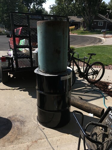

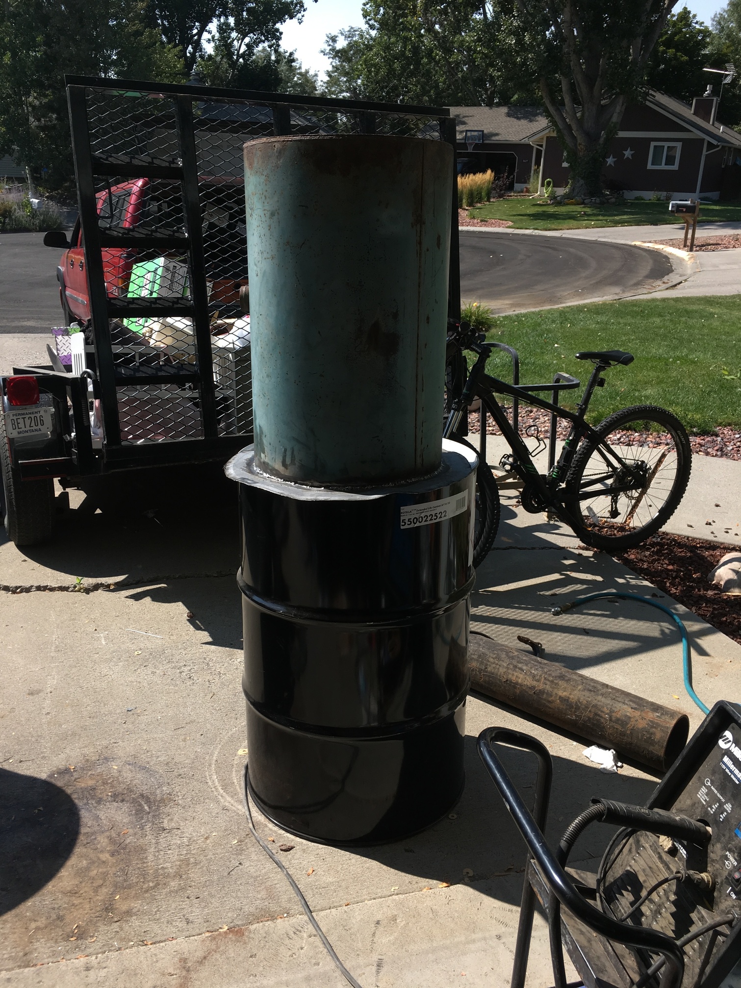

This is my first attempt at a gasifier, and basically I’m scared of screwing it up. In the FEMA manual it says I’ll need about a 16" x32" + to run a 350. My question is, does the firetube need to be necked down into a reduction zone? Or would it be better to maintain the 16" at the bottom?
Which would e better?

The primary problem with the F.E.M.A. design is it is a “floating zones” system. Without zone defining air jets; without a constriction all-gasses-must-flow-through zone defining area as you use a FEMA it will zones-float making too much wet, sooty, tars laden produced gasses.
Your picture shows well you are willing to cut, grind, Fab and weld. This is good. You are a NOW-DOer. This is even better.
