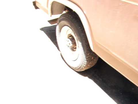

a few yars ago my 1984 f-250 3/4 ton 4x4 would not pass smog so i took the hole lot apart and rebuilt it on a diesel frame witch made it so i dint have to smog it and i deleted all the emitions it now has a carburator one wire HEI ignition watch the video i think its what your after 351 w but the same will work on a 460 =)
