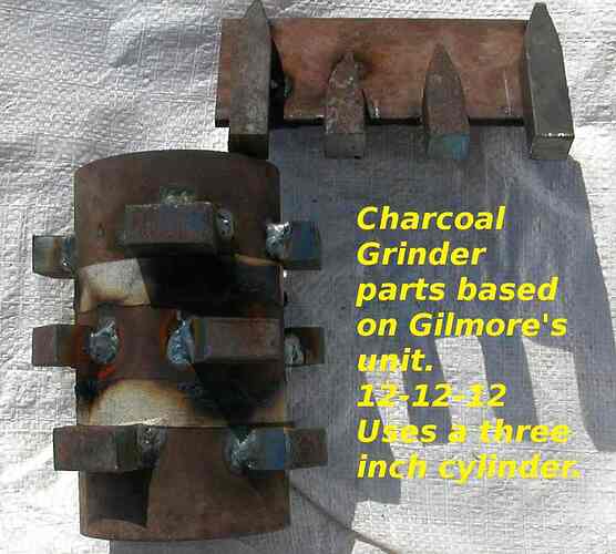

You guys who have already built grinders, how much space have you left between the nubs on the drum and the stationary fingers?
Andy, I TIG welded some RR spike pieces to a 3" pipe, and then used RR spikes for the teeth of the comb.! Here is a photo of Gary’s set-up, I believe.
Gilmore_grinder|175x275
Looking at the second photo (the one I built), I would guess 1/8" on either side of the tooth for clearance?
Mine is hand cranked, and is located near the path from the house to the shop. I hold my breath, crank for a minute or so, and continue on to where I was going.
Yep, 1/8" or so each side.

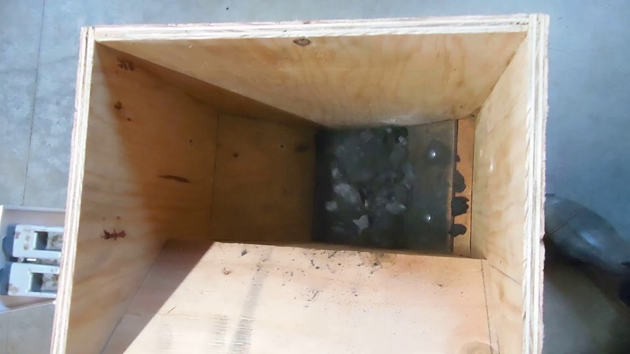

Ok, here is my grinder set up in its home location
Andy; If you put another “beer” sign on top of the 2x4 that hold the sifter, would it act as a chimney and pull the dust up and away? Tomc
Andy that’s a nice grinder!
