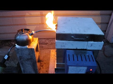

Science of charcoal activation
This is a wery informative video on charcoal activation.
This information is wery important for charcoal gasification. Our gasifiers defenetly meet charcoal activation criteria in the reduction part of the glow lobe. What l am asking my self is does injecting water together with air in our gasifier allso aids to porosity of the char? In this case, this is a nother advantige to water vs EGR injection. Greater porosity equal greater surface area equals faster more complete reactions in the gasifier.
