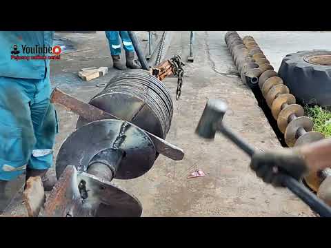

I came across interesting video on YouTube. Guys making conveyor screw. Maybe some inspiration.
I found this today, really got me inspired to start building one.
Yes, it popped up a few times on the forum. Still figuring out how it works and how to determine chipsize. Feed along the axis or on a almost 90 degree angle. The Laimet feed is almost dtraight on the axis. I think you need more power then but chips are smaller.
The first most important thing if diy is an equal distance between the srewblades, I think. If not done correct a lot of power is lost here?

Well i got my blanks (flights) cut out a while back. Havent done anything else with them so far … im thinking i should chuck them up in the lath and put a bevel/cutting edge on them before attempting to press them open into an actual flight. I went way bigger than I needed too but still thinking just maybe i can push wider stuff threw it.
Im going to use a 1.5" shaft. My plates are 3/8" thick and i cut them out at 13" diameter…yeah, i know. They are quite large! But that was the size of the square plates i got my hands on and i can always cut them down.

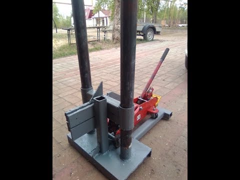

Hi Chris, I don’t suppose you have had time to work on your screw chunker until you get the head gasket fixed on your Dakota, but how are you planning on bending the flights? I have been doing a lot of research, and I think I am going to build some like this:
It seems to be the simplest way I have found and looks pretty easy to make. I am using a 2" shaft I found with 10" flights. I am thinking 2 1/2" spacing between the flights. I agree with Rindert on re-cutting the flights after they are welded to the shaft, but I still might partially bevel the edges on the lathe beforehand, just to save on the grinding.

Many ways to skin a cat, as they say. This guy’s seemed easiest to me.
I had seen that particular video way back but recently when i went looking for it i coudnt seem to locat it… so thanks for reposting it Garry.
I did end up finding this one.
So im sure i will fab up something relatively simler to one of these methods. Either utilizing the wood splitter or shop press w/bottle jack as the source of power/leverage.

I ended up going with 13.5" flights at 3/8" thick, because i had access to the material. I also came up with some 1.5" shaft material and a pair of 4 bolt flange mounted bearings. Again, what i managed to scrounged up.
I agree with you on the pre-beveling of the flights before pressing them. Thats my intention as well. Only because i feel it will be quicker and make it so there is less material to remove when it comes time to put an edge on the newly formed screw.
My flights are already cut out, have been for months, i thought i had a picture to share but apparently not. I Will post them and more on my progress when i get started. That way there is documentation on what to do…or not to do for others that are interested. :grimacing:
Well I am going to call this a success. I built this this afternoon. It is similar to the one in the video I posted a few posts back, but I used a piece of threaded rod instead of a hoist. The main center piece is 1 1/2 by 1 1/2” solid steel left over from a previous project. I used the bearing tool you are supposed to use when installing wheel studs to eliminate a lot of friction on the drive nut.
I only used maybe 10-12 ft pounds on the wrench to bend it this much. Granted this was only a trial with 1/8 inch steel, but I think it should easily do 1/4”.
When it was on the bender, I had it about 2 3/4” between the edges, but it shrank back more than I thought.
