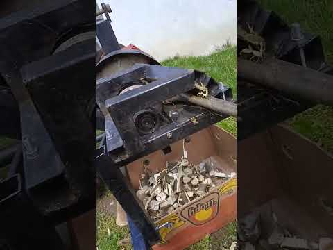

after reading the comments. He is using 12mm(0.472441") x 250mm (9.84252") blade on an 80mm (3.14961") shaft. And because he said he had to hammer the blades out some, and they are now uneven. it makes me think it is only welded on at the ends since it is just a prototype. And I think he means he changed the angle from 15 to about 35 degree when he did that. The tractor is a Universal 445 with 42hp (claimed) at the 540 pto.

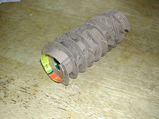

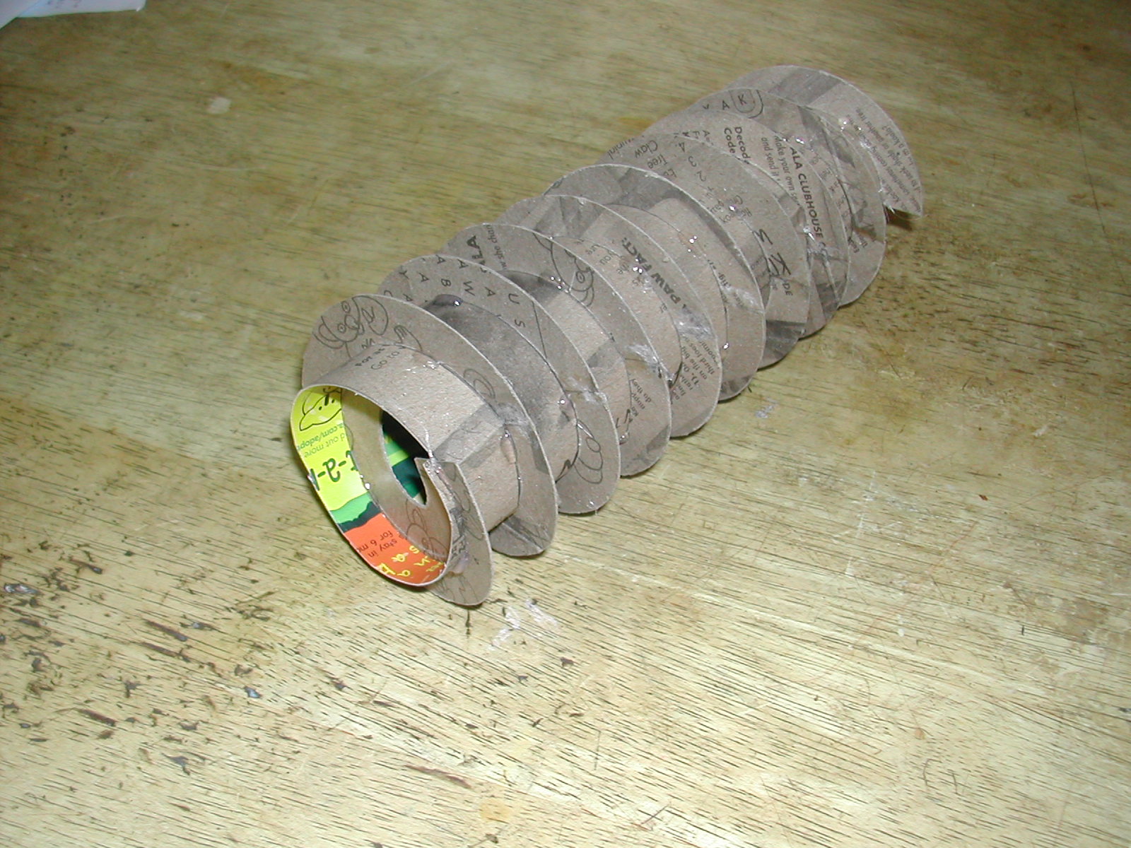

The math isn’t that hard. The old carpenters that used to make spiral staircases and handrails worked it out for us. Handrail radius calculation.
Thanks Rindert, but what if the isnt a cylinder but a cone? More like tha Laimet?
The mental picture behind the calculations, in both cases, is a right triangle that has been unwrapped from its basic shape. Whether it is a cylinder or a cone you can use this to determine the arcs you will have to cut. Determine the length of the hypotenuse. This will also be the arc length. Since this will represent 360° of rotation you can determine the radius.
I recommend making cardboard models before cutting metal.

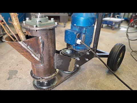

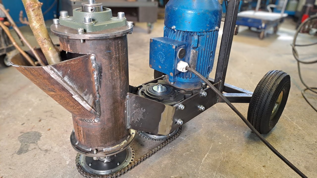

any guesses on how long the steel tube is? the only dimensions he gave was 150mm for the initial auger flutes, which is 5.9".
I would say no more than double of that length
Freight shipping from Ukraine to United States would be insane I bet.
Great find SeanO’

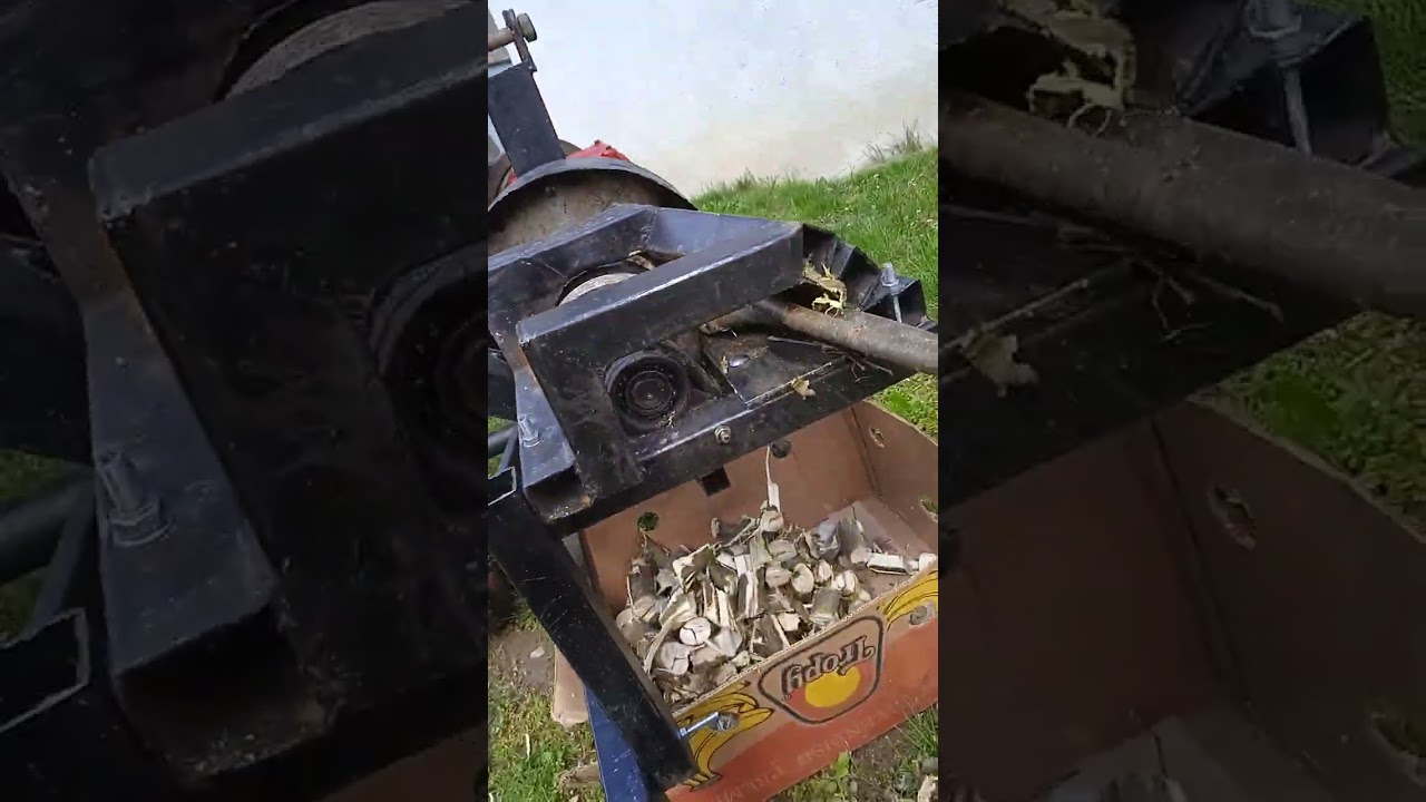

Skip to minute 52:00 to see it work.
He’s got it set up just right for speed and bits size made.
It really eats up the spread out, branchy stuff.
no idea. I would guess 500 bucks, if they can even ship it this far. Then I have no idea about European PTO sizes/speeds, 3pt connections and such. I personally would feel safer with at least a 2:1 reduction in speed.
About 60rpm, and a fairly small motor which didn’t seem like it was struggling at all.
