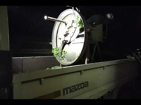

Me? Only blabbering and want to stay as close to sawdust as I can. My friend uses a Laimet for willow (ok) and Laurier ( not ok). He complaines about jamming. On the other hand, mine will be electric. Switch direction and problem solved.

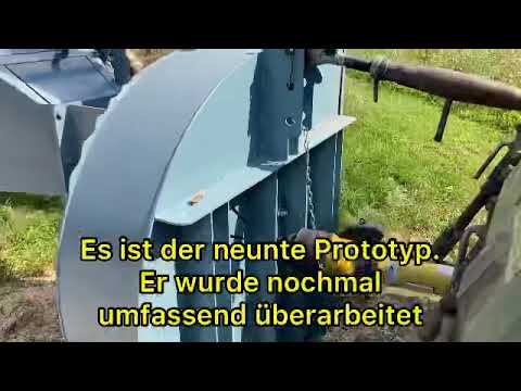

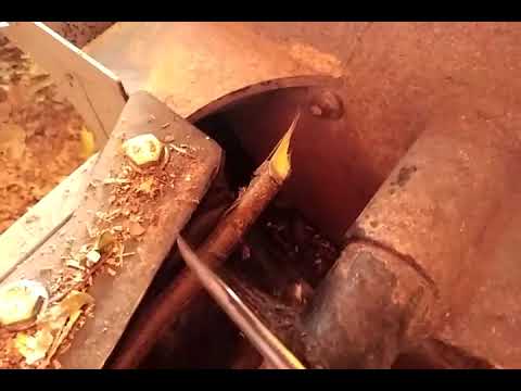

I think that only two spirals would be enough for the device to grab the wood and move it forward. If you look closely, a smaller cutting knife is installed at the end, which is essential for cutting thin twigs and fibers, well, less spirals also means easier drive and a quick cut at the end in the style of WK chunker.
I added this knife at the end….

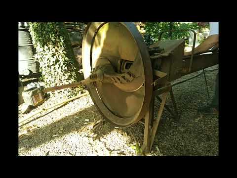

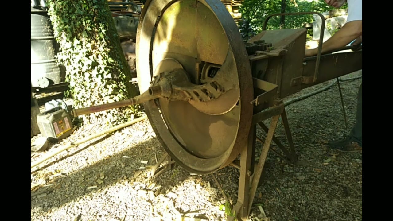

Joep, I bought this for 100 Euros, for the pleasure of seeing how it cuts wood, first the bar is 34 mm, then 48 mm, well, the manual drive at a thickness of 50 mm is not easy, but it still works. The device is more than 100 years old, the wheel probably weighs more than 100 kg, the machine would probably fit well with Giorgio’s historic tractor,… :grinning_face:
