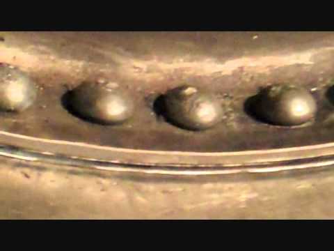

I had to learn this for a class I took in the Army. Plugging holes with a caulking chisel. Now I save all these weird chisels I find around here, because I know this was a steam powered industrial site and these were actually important tools in their day.
I have always wondered how they sealed the seams on those riveted boilers Bruce. We use to have tools that looked alot like that only somewhat bigger. We called the hell dogs. Used to bust the heads off rivets. Rivets were obsolete years before I started working Iron. Still a lot of guys that had worked in the rivet gang. A lot of interesting stories.
