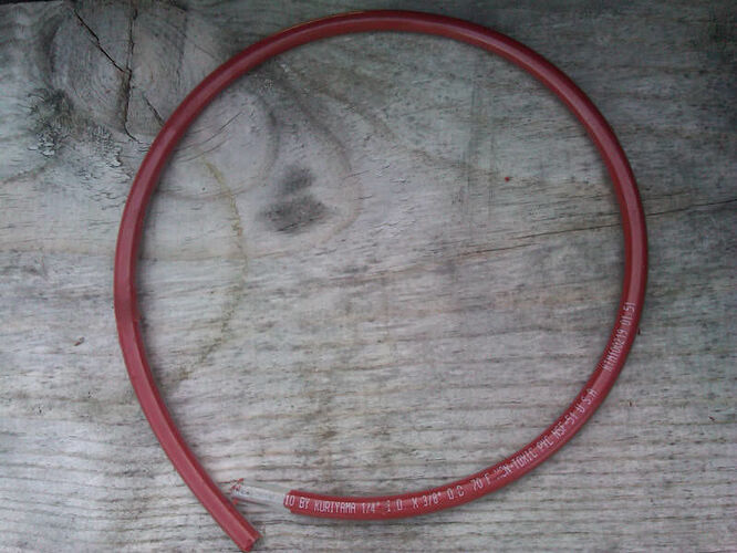

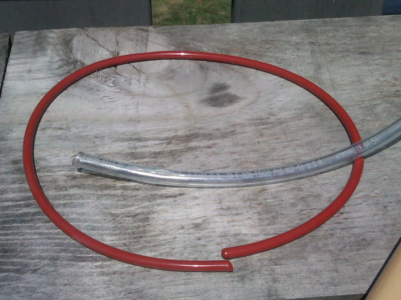

Here is another way to make high temp silicone gaskets. I used a piece of 1/4" ID tubing (3/8" OD) and a brand new tube of high temp silicone to make a nice rope gasket .
Just trim the end of the applicator, insert the end into the tubing and secure the connection with tape so that the pressure will not cause a blowout. (I used really sticky aluminum tape, but duct tape would probably work too). Now squirt the tubing as full as you can. It takes a lot of squeezing to push the bead of silicone all the way through the tube - I literally had to stand on the tube to get the length that I needed. Finally, open both ends of the tube so that the silicone can dry. I left it outside in the sun for a couple of weeks.

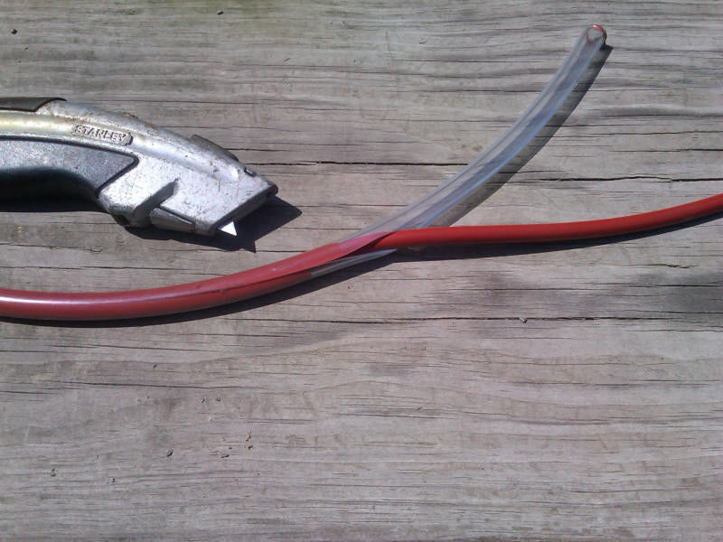

After drying, I took a utility knife and adjusted the blade and carefully made a split all the length of the tubing, being careful not to cut much into the gasket. Than pull out the silicone rope and there you have it. A perfectly formed 1/4" round high temperature silicone gasket.
