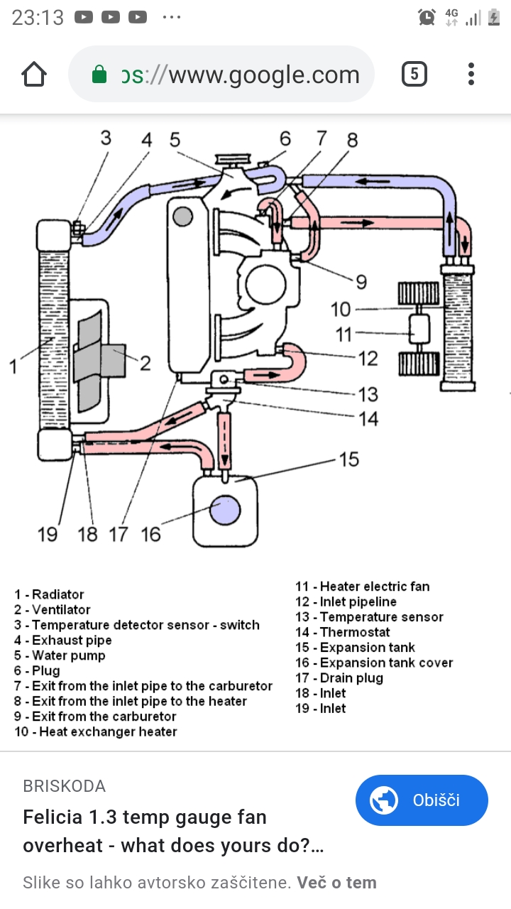

I like the idea of making a separate intake manifold. Probably less work thain modifying the existing one. And since you mention heating, take a look at this diagram
It realy does run great with all the heating. My “carbouratorised” Mercedes runs like crap in cold weather, ice forms on the intake manifold…
But its quite complicated and it is possible coolant is connected to the block via the manifold… something l do not want to fiddle with if l build a new manifold.

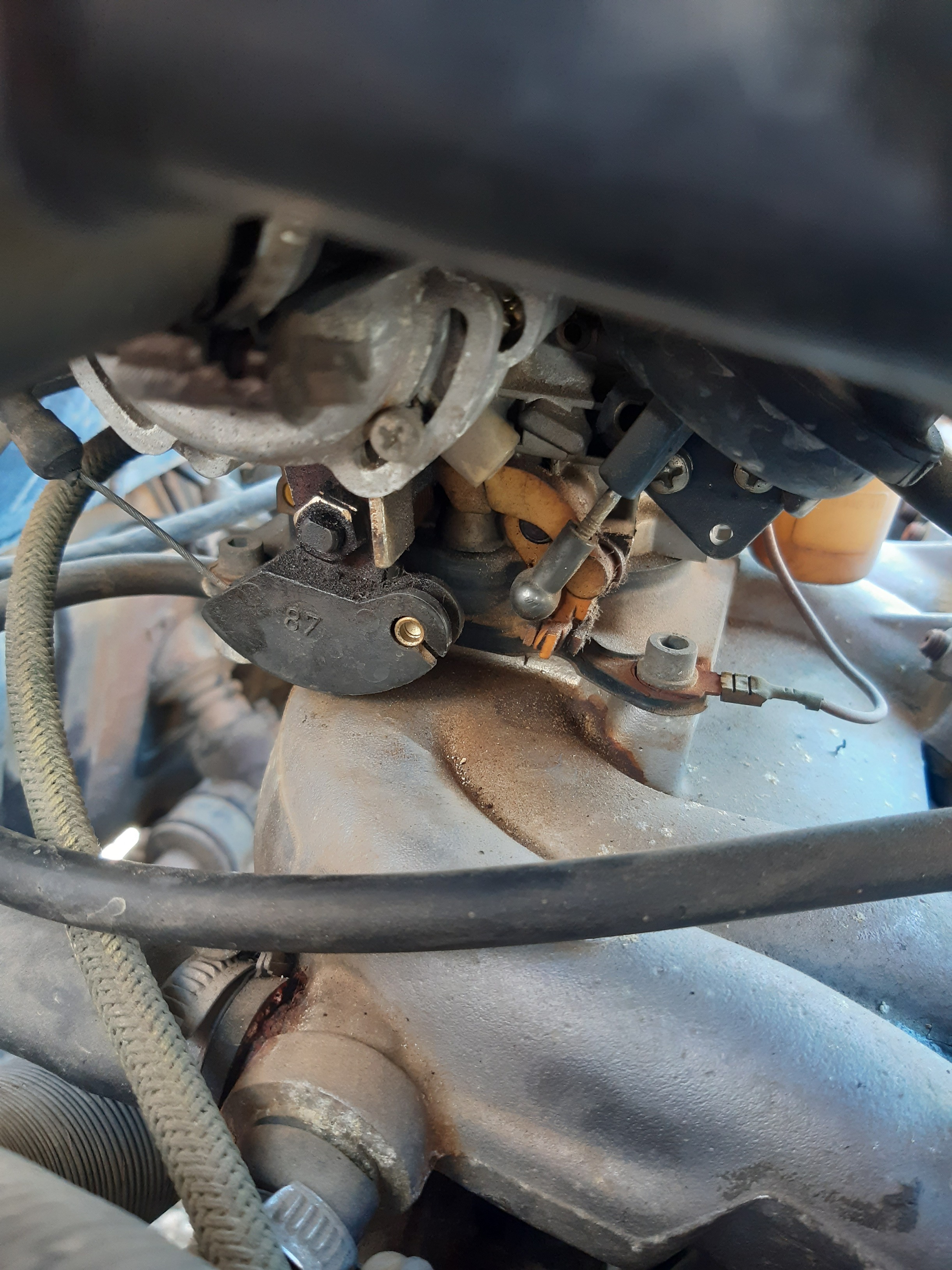

Is there room to rize the carburettor 40 – 50 mm up from the intake manifold?
Or is it “watermantel connected” to the intake manifold?
Pictures would help organising thougths…Reveiling room in all directions (for arriving gasline and airline)

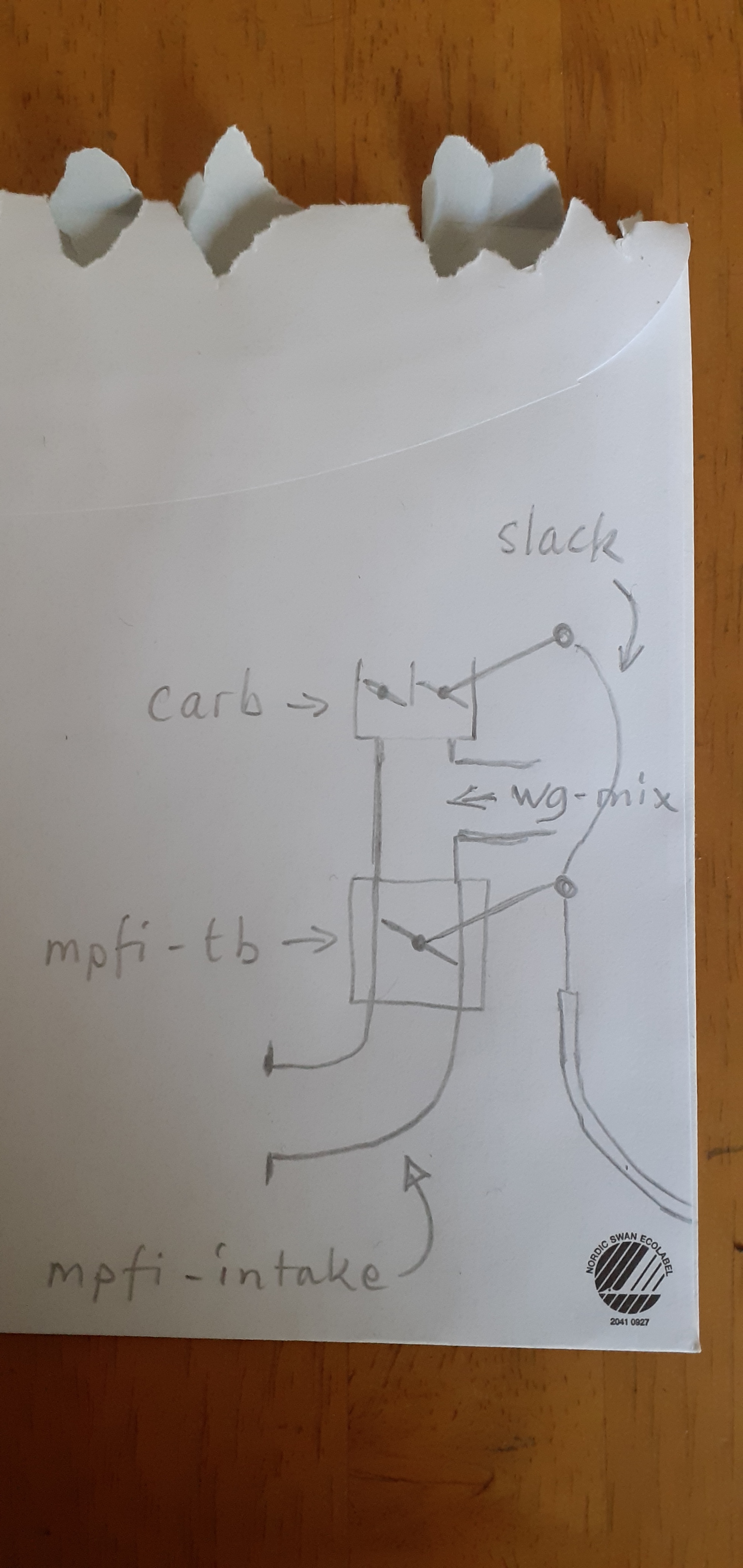

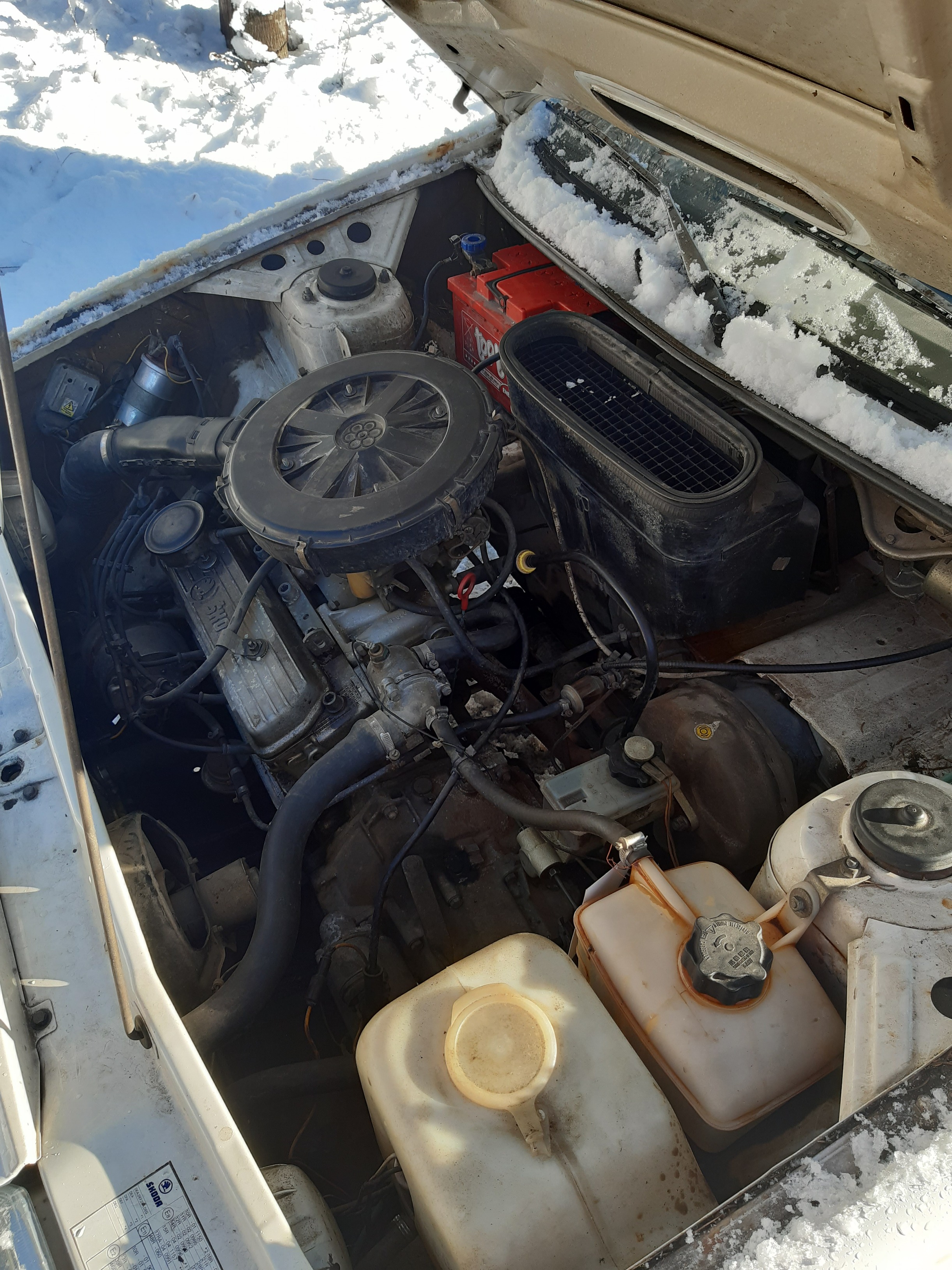

Now that know your engine is turned 180° compared to later models, I’m beginning to wonder if a mpfi intake will fit.
Anyway this was my first thinking:
Max, yes, the intake manifold is connected to heater water on a couple of spots. That is why l can not drill it like l did on my Mercedes.
I think l can lift that much if l take the air filter off. But no more thain that.
JO, we are on the same thod then. Thank you for the skiz.

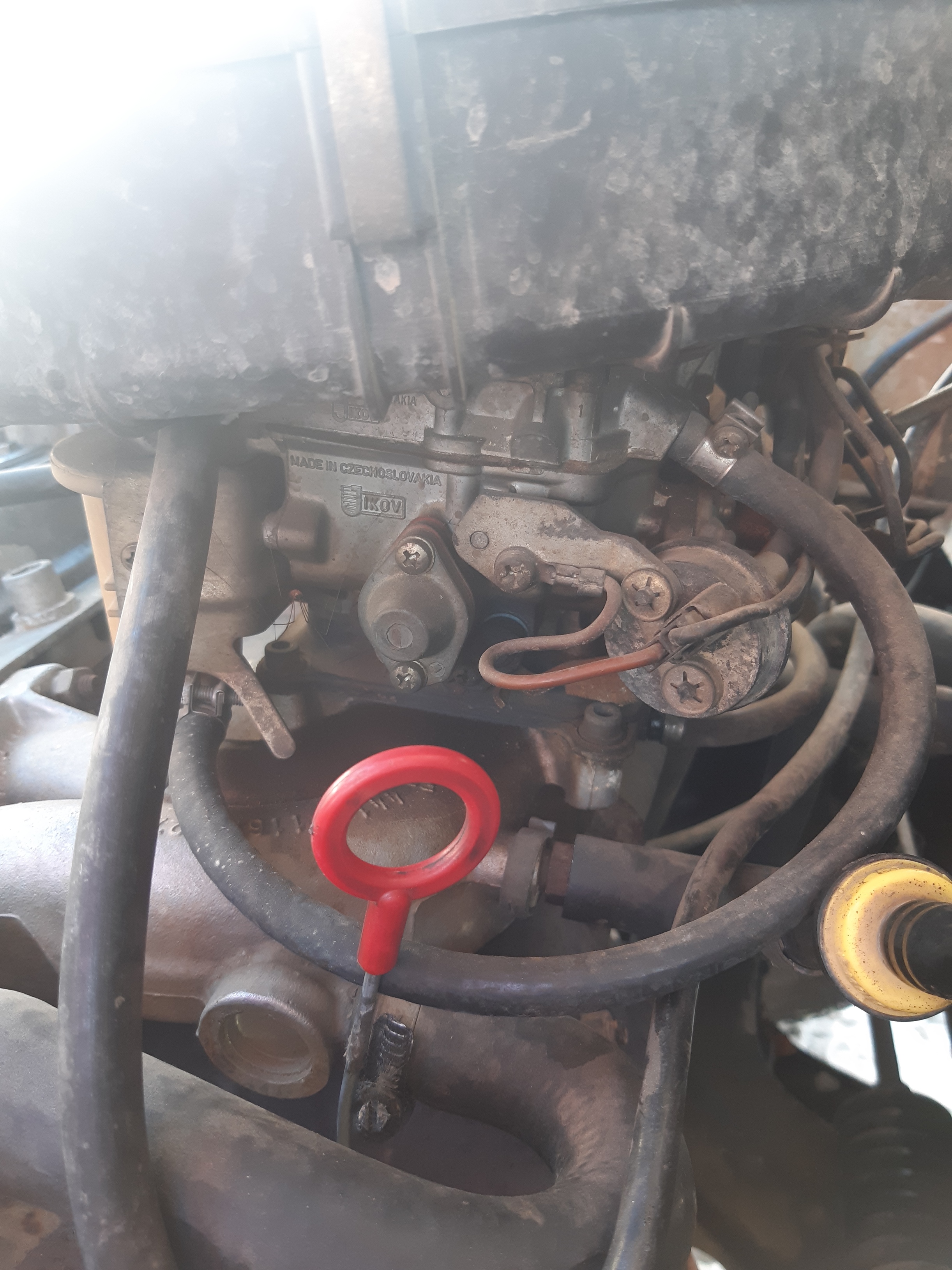

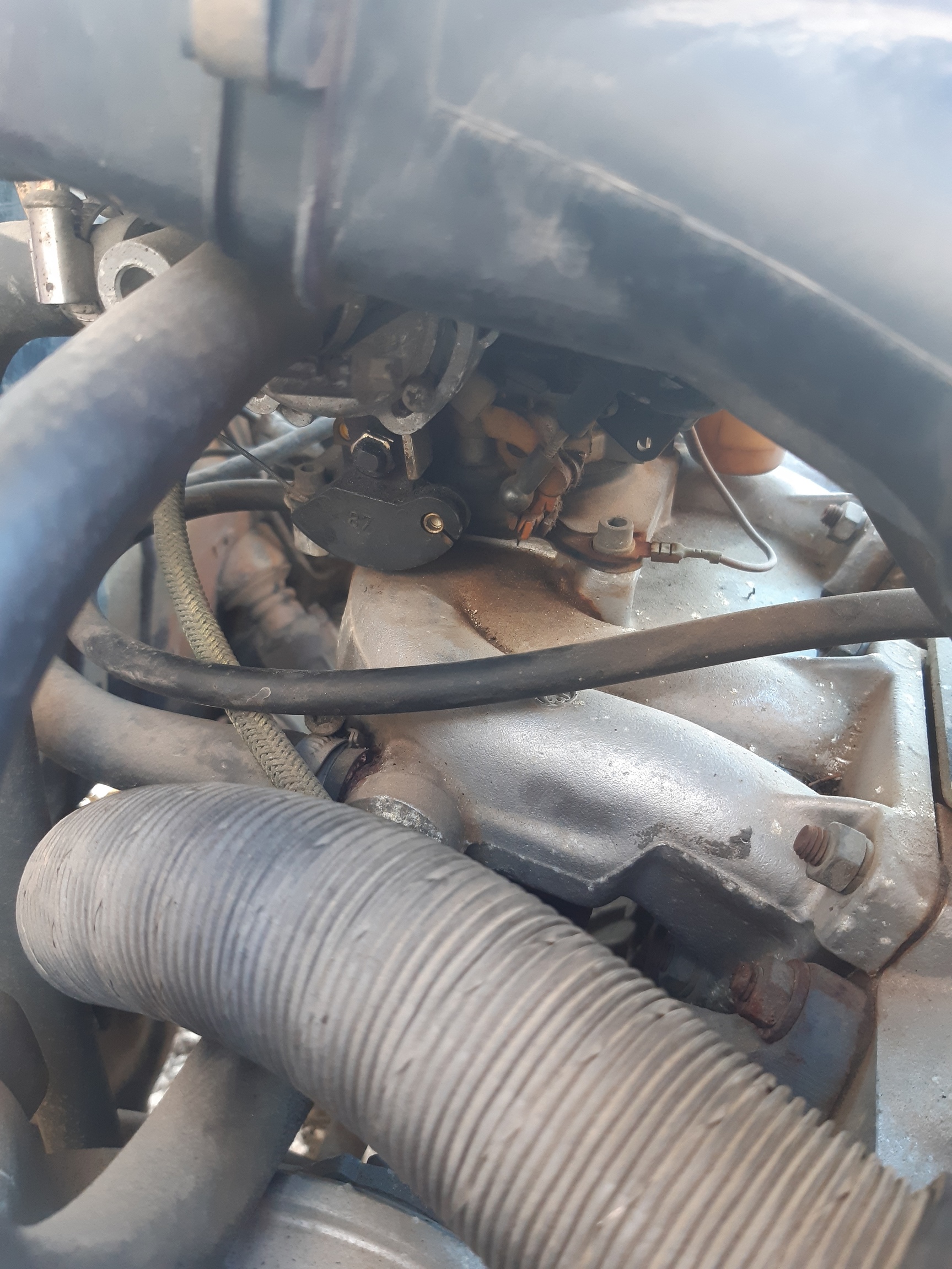

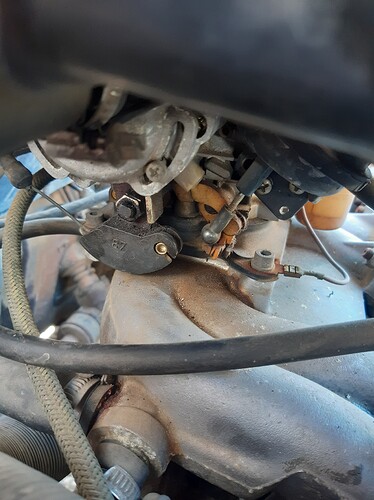

Here are some pics of the carb/manifold
Maybe a flat box could be squized in between carb and intake manifold? Fed by a separate tb to the side. That would be pretty much a standard “under the carb” setup.

Yes that is the direction l am thinking of. Ons negative side thugh. This way some idle mix will still be sucked trugh the carb…
Mike, criminal indeed. There are practicaly no official dealers for US vehicles here so every vehicle was shiped here privately, hence the price. Spare parts are just about non existant allso.
Workhorses like this Škoda are cheap but rarely sold because noone wants to let them go. Diesels are somewhat more common thugh…
Cars like this Škoda go for about 1500$ here. A few months ago l missed a Škoda with a 75hp mpfi. Called minutes to late. Funny cheap too, 300$. But l payed just as much for this one so thats not to bad either, just a bit more fuss with the carb…
…depending on what the idle adjustment is like. Some type of bypass or a simple stop bolt for the butterfly action ? Either way it won’t dribble much.
To much of my surprice, this carb is actualy quite complicated. Electronic and mechanic. It has a good warmup system, and possibly even idle control. Nothing like the all mechanical carb l am used to from my MB.
It has a bypass port as far as l know.
You are probably right. I do not mind a few drops of petrol ror idle but l like the gasifier to breath allso while idleing. Mabee riseing idle will solve that

Anyway, we looked at the carb of the Škoda and he pointed out this carb has a electeic idle shutoff valve. Disconnecting it kills the engine instantly. Unfortunaly it doesent shut off the main jets. But this means l can build a “horse shoe” adapter under the carb like discussed previously without idleing fuel dribleing in with the woodgas.
