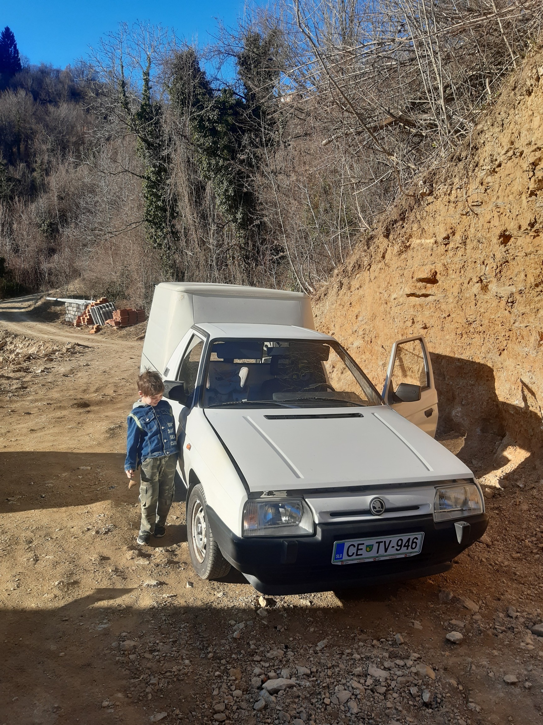

The vehicle in question is this one
A 93 škoda, 1.3l carburated engine. Pushrod OHV. 57hp. Not the first choice for woodgas but suitible trucks here are about as common as a honest politician. The truck is light thugh so the power is good on dino.
I will post detailed pictures later but for now, l can say l love it already :smile: everything is so simple and mechanical. And SPACEOUS!!

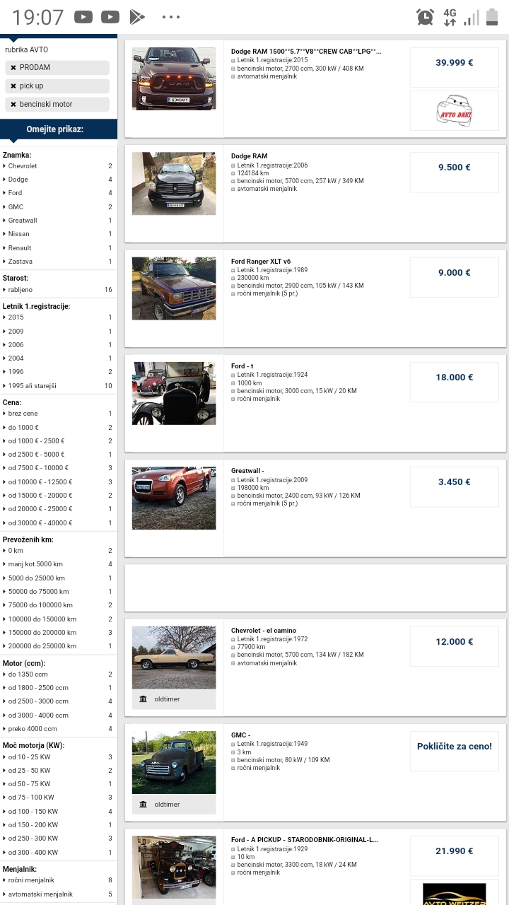

Thierry, thats the problem. There are none. Been looking for a better candidate for years. All l kept finding was looking like this
Junk, crazy expencive or museum peaces.
Museum peices would be fun but also crazy expensive by the time you got them to be usable… :disappointed:
I so love the old 30s and 40s body styles but I would want a much more modern driveline and suspension.
That truck you got looks like a bargain to me. Reminds me of my first truck a Dodge Ram 50 I loved that small truck you could park it anywhere.
