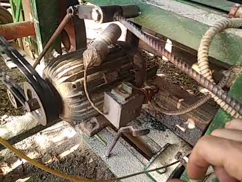

Mechanism for easier starting, because it often blew my fuses when starting 16A, the wheels are iron and heavy
Here I am trying to show some details on the saw, the wooden oak guides for the saw blade, cleaning and oiling the surface of the wheels with oil, here is a container shaped around the wheel, with some oil in it, a cotton strip is soaked in it, which slowly raises the liquid and emits it outside under the felt, … but there is also a starting mechanism and a three-phase capacitor for reactive energy compensation, so the conductors are less current loaded and the consumption is probably 10-20% lower

You could also use reduced voltage for starting. The 75kw induction furnace I had required a low voltage starter due to the mass of the generator. Mine was mechanical with a transformer but I have one from an old grain elevator I tore down decades ago, The elevator was set up to operate on single phase with line shafts. The low voltage starter was one that used rods in metal cups filled with salt water to have variable voltage to the motor as it started up.’
I only have 3kw 1450rpm on my band saw, it’s a bit too small.
I have a new 7.5kw 1450rpm motor, but only have 16amp fuses, any idea if I can use this motor?
Your total consumption on 16A is good for 11kW Jan, so that should be ok as long as you don’t run a lot of other things at the same time

Do you think I need a y d start before I try?

I would try it first, fuses are cheap.
But there isn’t that much mass that needs to start spinning so I don’t think it needs it.
I could be wrong but like I said, fuses are cheap :smile:
Ok, then I’ll buy an electric cord and test if it works first.
