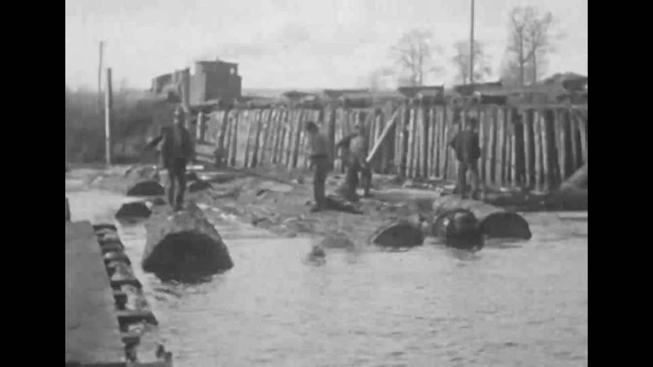

Not a small mill by any means, but the pictures I shared a while back about Aberdeen and Hoqiuam logging museum this is one town over in Montesano part of the big lumber industry that built Washington state no audio just black and white video of the whole logging/milling/ shipping industry
