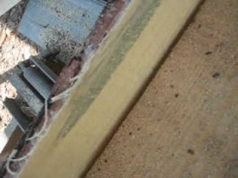

Mechanism for easier starting, because it often blew my fuses when starting 16A, the wheels are iron and heavy
Here I am trying to show some details on the saw, the wooden oak guides for the saw blade, cleaning and oiling the surface of the wheels with oil, here is a container shaped around the wheel, with some oil in it, a cotton strip is soaked in it, which slowly raises the liquid and emits it outside under the felt, … but there is also a starting mechanism and a three-phase capacitor for reactive energy compensation, so the conductors are less current loaded and the consumption is probably 10-20% lower
Thought this pretty genius
