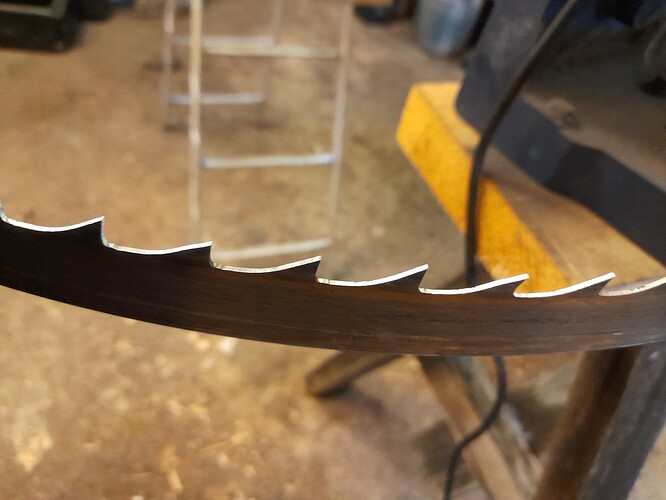

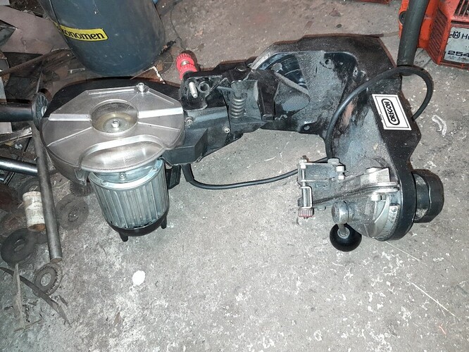

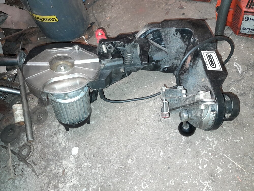

What do you think, is the corner too sharp on the tooth?
Do I need to redo the profile and get it rounder?
Hi Jan,
What have you set the angle to? The Wood Mizer blades I sharpen vary between 10 degrees ( for harder wood ) and 15 degrees ( for very soft wood). I set mine for 12.5 degrees for a compromise. The steeper angle is supposed to help pull the blade through the wood for faster cutting. I haven’t really noticed that big of a difference. I think getting the corner of the tooth " sticky " sharp and the set of the tooth more important. The blades come with about .020 ( twenty thousanths of an inch ) set and you lose 2 or 3 thou every time you sharpen. I will set up to 30 thou if I am cutting really soft wood or spruce with big knots. Below about 16-18 thou the sawdust will pack tightly on the board. I should post a video but not sure how to go about it.
Buzz
Darrell,
Video: have to start a YouTube channel or equivalent, upload your video there, then post a link to the video on the forum here. You can directly upload still photos and PDF files. I am sure there are other ways, but that is the common method. The video does not have to be public, it can remain “unlisted” on the YT channel. :cowboy_hat_face:

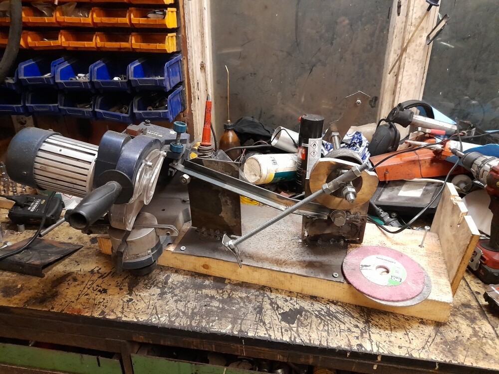

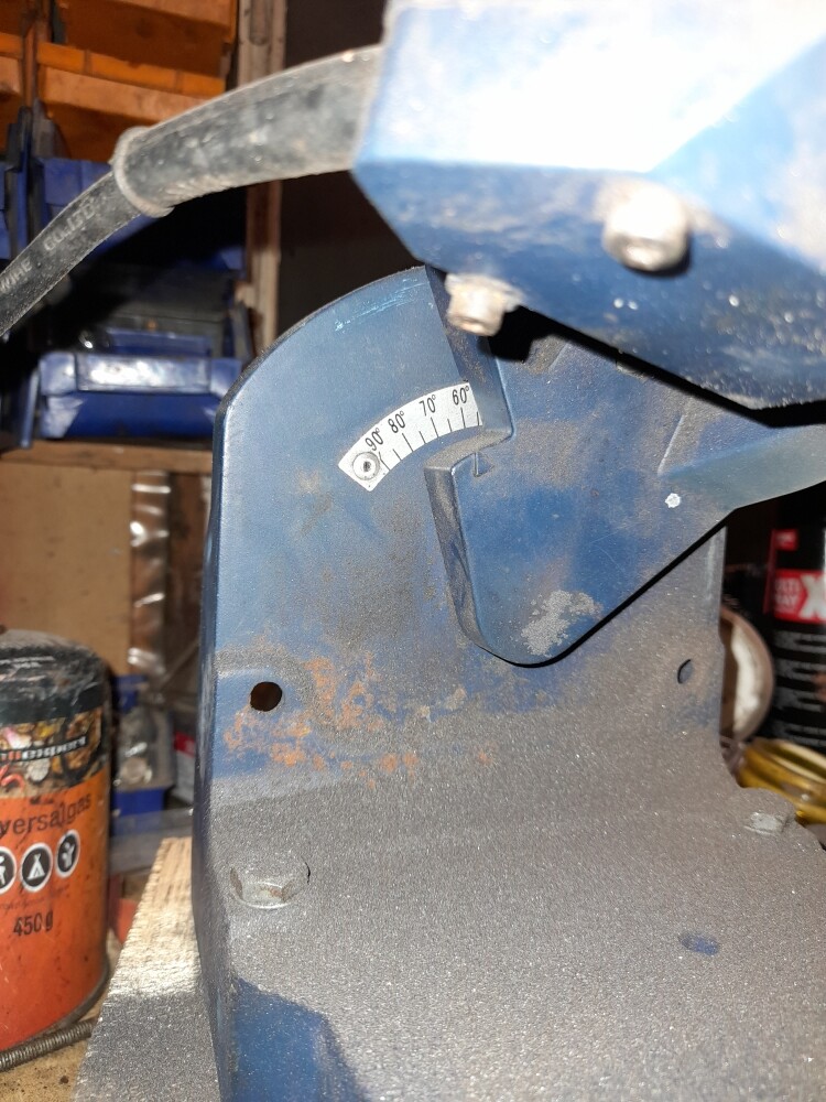

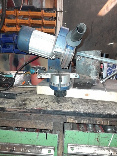

Ok, I had 17 degrees, so I change it to 12 degrees, the set I have not looked at yet, I have to do something so I can fix it too.
Thought to try with the diamond disc that I have in the other machine, it is thicker, should be better rounding at the bottom of the tooth then.
What kind of grinding wheel do you have?
I have the wheel that comes with Wood Mizer grinder. It is .5 cm x 15 cm and a pretty regular grinding wheel. My setup is basically the same as yours but a little fancier. It was supposed to be water cooled but I stopped using it and have not noticed a big difference. My grinder runs on a cam through a linkage and is a gentle cut down the face with a deeper grind on the gullet to take out micro cracks and up the back of the tooth to finish. I watched how Wayne grinds his blades and I do not know how his blades last so long without grinding the gullet. The new grinders have diamond studded wheels that are shaped to the tooth and grind all parts at the same time. It runs in an oil bath.

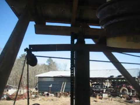

Hello Jan .
My sawmill sawing head is heavy and would be hard to raise up and down with man power . I have a counter balance ( about 75 pounds ) on the head that neutralize the weight to make it easy for up and down.
The small chain and pockets hold the head in place and keeps the unit parallel . Very little weight on the small chain and sprockets .
Hi Wayne.
I have tried watching your movies, but do not see if you have chains for both the top and bottom of the saw?
Hello Jan .
This video is not very clear but hope you can make it out .
Looks like a beautiful day in the south there Wayne! Nothing like our dreary drizzling weather we have here, not to good for drying wood out
Thank you so much Wayne.
Then I understand how to do, my son thought that my saw was too light for wires that I have, that it does not stretch it, I will put on some weight and try if it makes any difference.
Yes Marcus .
About 65F and and plenty of sun .
