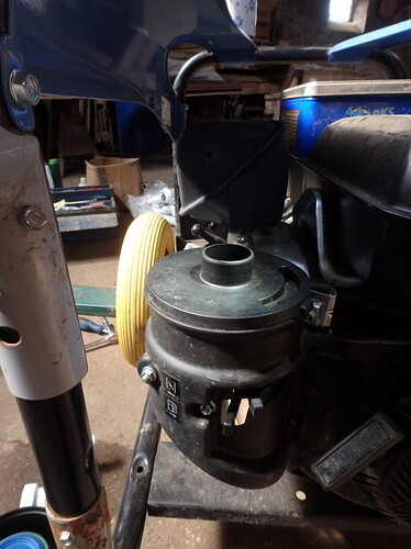

Q 2. I’ve attached a photo of the air intake with the Kohler filter removed and you can see that there’s a very convenient spigot sticking up which fits some old sink waste pipe I have perfectly!
If I could connect to this there’d be no need to make an adaptor to fit the carb, and it would be much easier to convert the generator back to petrol if I want to (I use it for work and won’t always be able to use charcoal on site so switching back-and-forth easily would be good).
Would connecting to this spigot be a problem do you think? It also means that the fuel line remains in place if I end up using the petrol start up rather than a blower.

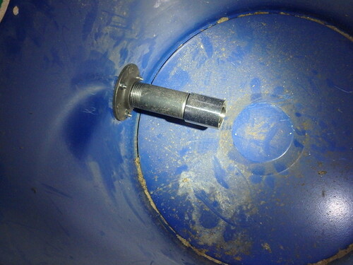

Looks like you are on a good start. Can we see the inside of the gasifier too? Namely the nozzle. Its the most important part of a gasifier…
As for startup, with the engine runing on the residue fuel from the bowl it will make your head hurt, specialy for a beginer. But there is a simpler way! I started gasifiers many times with a hand powered inflator. You know, the ones fot kitty pools and inflatable boats. They both suck and push air, depending on tha way they are connected, and usualy pull air trugh both upstroke and downstroke
Hi Kristijan
I’m not sure I can post any more pictures yet but for the nozzle I’ve pretty much followed the Simple-Fire design (1" pipe threaded both ends) except that I found a stainless connector with a female thread that fits the end of the pipe, maybe about 2" long, which brings the assembly to a wee bit short of the middle of the reactor.

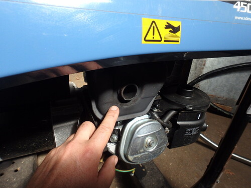

Q 3. The other photo shows that there’s another very convenient spigot on the silencer (once the cowl and spark arrestor are removed) which just happens to fit the flexible exhaust pipe for the exhaust return!
There must be a reason for all these wonderful flukes? I always feel that things like that don’t just happen by chance! Can I omit removing the silencer (muffler)?

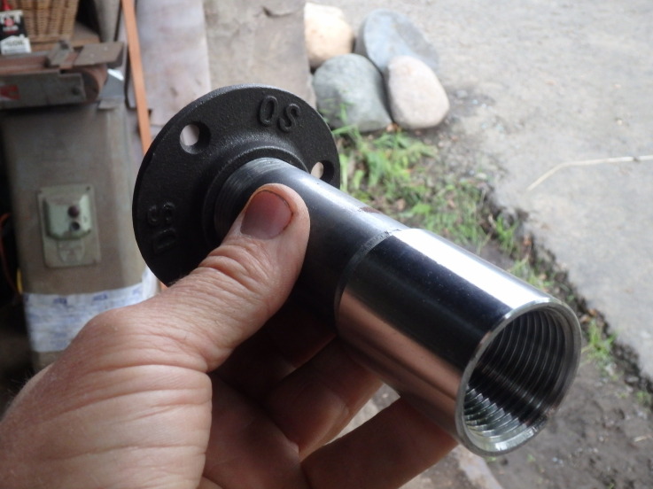

Ok did a couple more hours of work on the gasifier today and also took some photos of the nozzle.

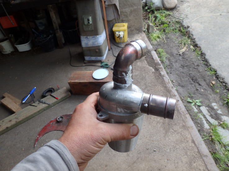

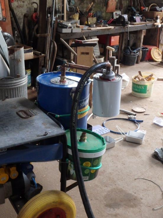

Couple more pictures of the proceedings today, mostly assembling and sealing things up with the silicone + some very sloppy brazing.
I’m wondering whether that cyclone is going to be too small…
If it is aluminum then it might corrode over time faster than steel would. That nozzle is alright for getting used to it but what some guys do is make a steel flute.
You could adapt this into your system as it is. Take a length of steel pipe with two or three holes pointing in the same direction. You could just cap off the end of the pipe flute.
Just screw that pipe into your existing flange and point the flute holes upwards.
The Gilmore style nozzle works in an emergency but will eventually burn away.
Some guys use a singular nozzle pointing upwards from the bottom but the flute does essentially the same thing with sideways orientation.
