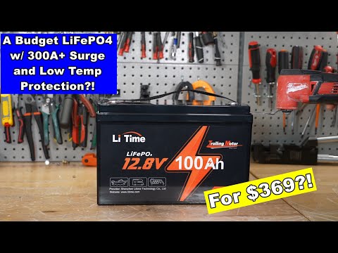

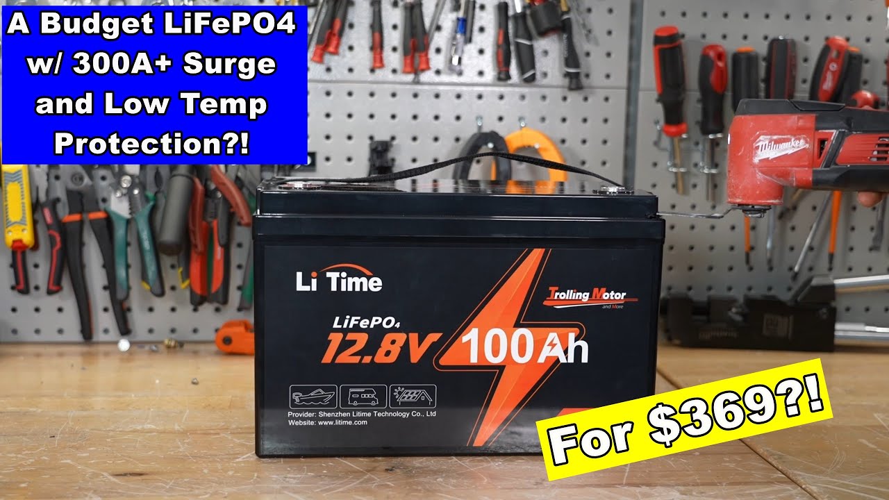

I’m sure a lot of you follow this guy but in case you don’t. Pretty close to what you would pay for a pair of six volt Trojans though a lot less AH’s . Not sure what that means between lead acid and Lithium. I would learn how to convert those EV batteries to house power. They will be plentiful.

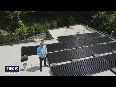

This is a video, and he does a decent explaining more in laymans terms the differences between micro inverters, string inverters, and how shading affects panel performance. This is his 10 year video for his system.
He is claiming his system has paid for itself in 10 years which is probably true. Given they have high rates in california, and he is doing time of day shifting to avoid the high evening rates. And certainly the original $10k system after tax rebates wasn’t 10k.
Apparently the powerwall allows you to use the cheap grid-tie inverter to keep power on during a power outage. Which I hadn’t ever thought about, but it makes sense.
