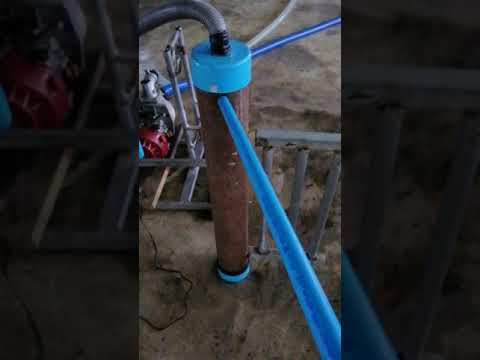

Koen, I am very curious what it looks like inside the 4" gasifier pipe?
(video 1)
Hi Billy,
Its a straight open pipe inside, about 120 cm long (48"), filled with charcoal, nozzle lit at the bottom/side
diameters of the pipe vary between 4 and 6"
Hi Koen ,  you mention nozzle on the bottom side , and i did notice a glow while it was running so i presume that the nozzles are horizontal on  those builds  have you made in roads with a decent material ? or are you using TIG type nozles in your small 4  and 6 inch dia pipe gasifiers ?
Hi Dave,
They build them with 15mm hole in the side ( like a small nipple female thread ) or just a hole with a nut welded on the outside.
Just to remember that simple also works…
All other options requires in depth thinking and add more to the difficulty level…
Whenever something goes wrong they ask my advice on how they can improve themselves…
I am actually surprised how fast things get picked up once they start doing by their own idea’s and how well some builds work…
As where i aim for highest power output, they are already happy when the engine runs and the pump pumps water…
Hi Koen , so let me get my head round this , you mean they just drill a hole in the side of the tube and weld a pipe nipple in and allow that to burn out ?  if you have any close up pics that would be handy to look at and understand  how they even manage a few hours run time .
