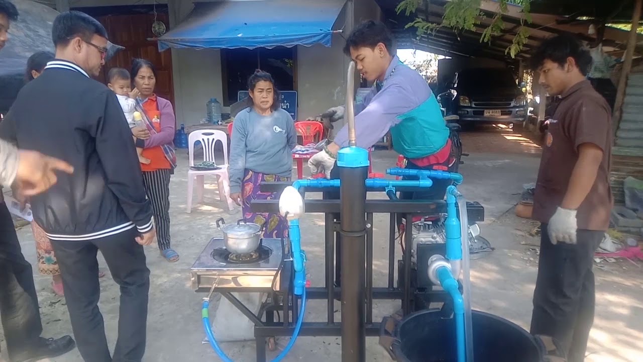

Thanks for the video Koen

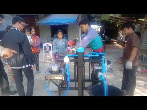

Koen; Is the young lady that stepped in to set the flame on the stove; teaching the class? TomC

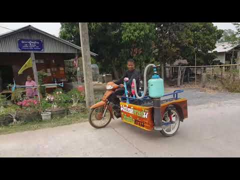

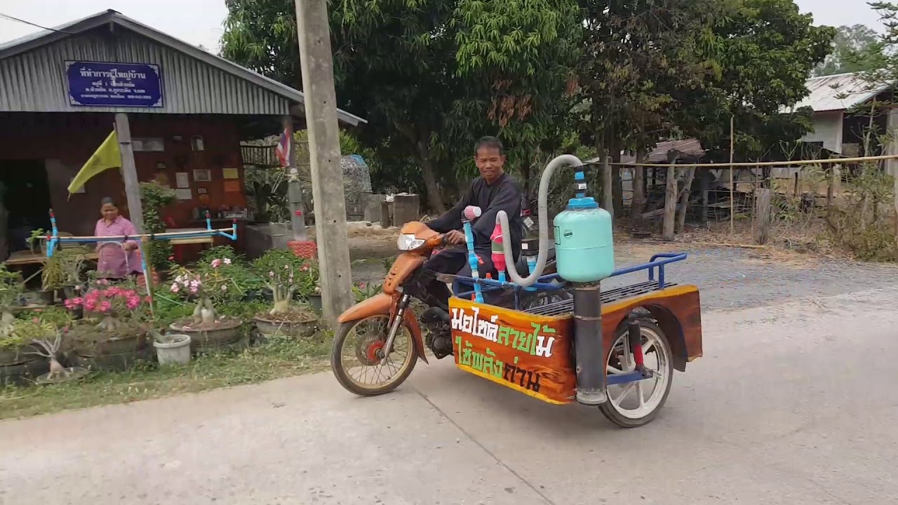

Are the motorbikes two-stroke? If so, how are the engines oiled?
Can you share details of the most durable nozzle design currently being used?
It seems that as the father of the ThaiFire, you have started an energy revolution. I’m sure you are getting a lot of satisfaction in seeing what has been done in response to your efforts to promote this technology.
Koen; Could you possibly teach these people how to increase the compression ratio, of their engines by filing the heads down . The extra power would really help the performance of the tricycle. TomC
I am not sure about Thailand but in the Philippines it is common that they change the drive sprocket size to get more power rather than speed. They also mill the cylinder head some. It is unbelievable the loads these scooters move over there.

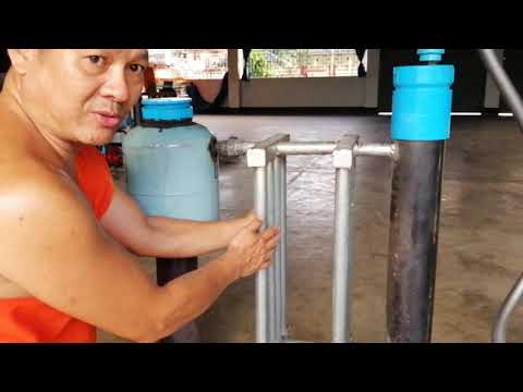

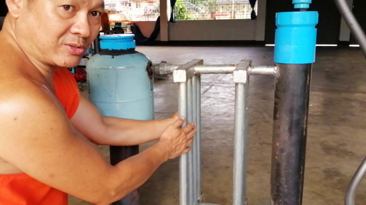

How is the fine filter arranged, two pipes fit, one pipe comes out, what’s inside the filter?
The last pipe functions as cyclone/cooler, the top have a foam sponge in it as filter
Tom,
One guy claims that he has used the following method on many racing small engines: up the compression a bit by eliminating the head gasket. Lap block and head with valve grinding compound on a piece of thick plate glass. Use a small amount of gasket goo (just enough to seal without squeezing into cylinder).
