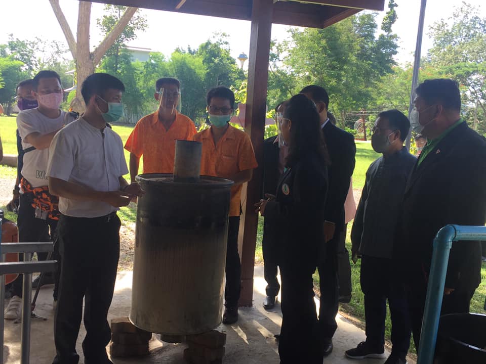

The government support the nationwide training on the energy needs for farmers and rural villagers.

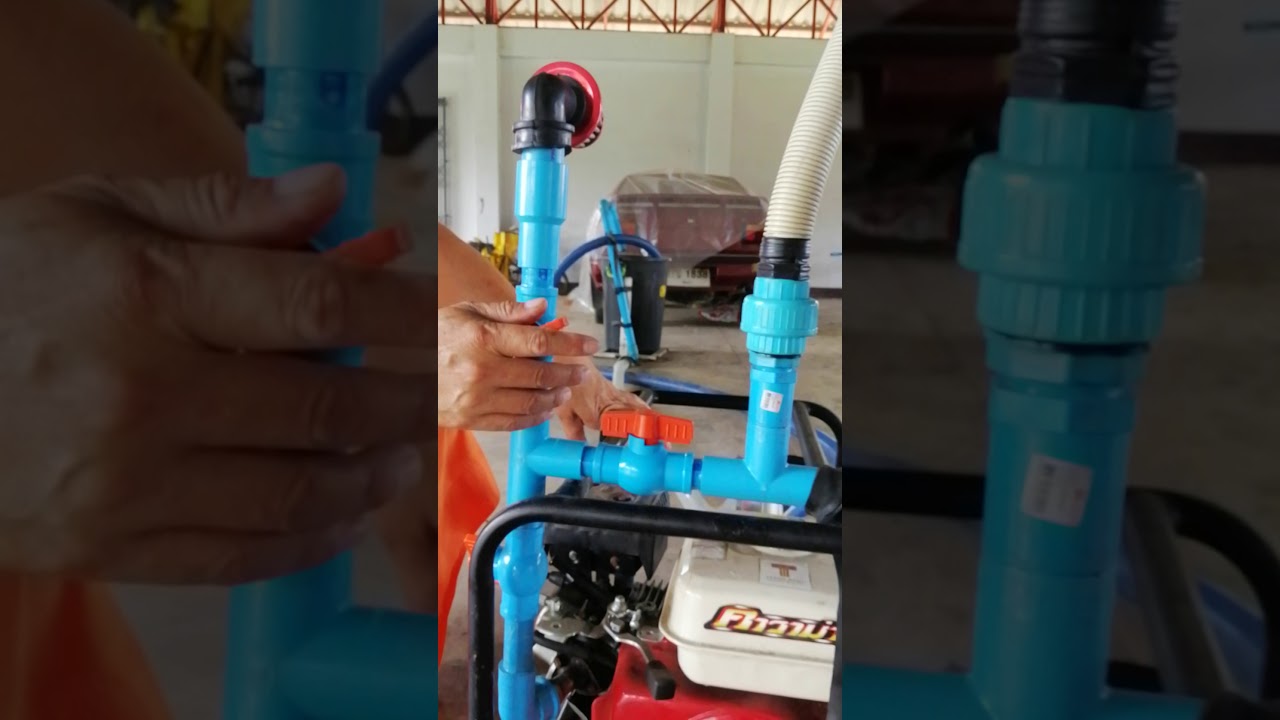

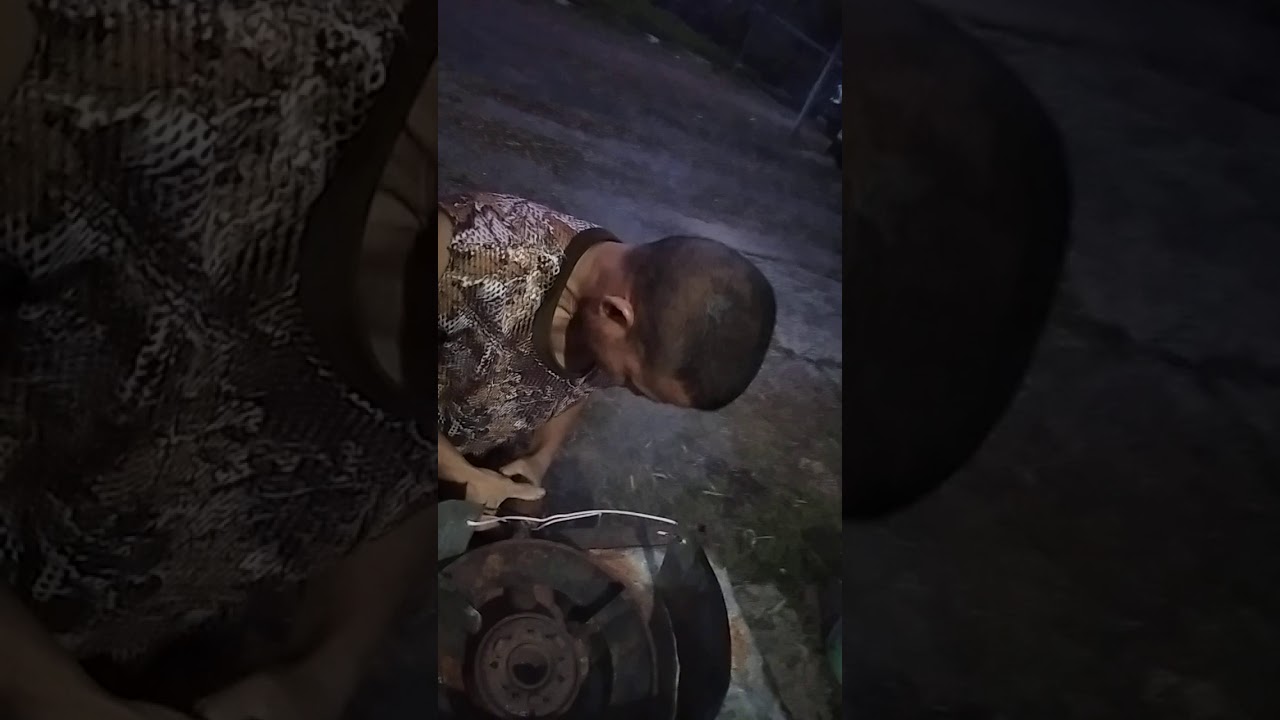

Trainings video for DIY builders…

It is not a success, it is a feat, think of all the gasifiers if they work at the same time, now and in the future, this must represent a good bundle of KW, knowing that under its latutides, the biomass grows quickly, it’s a master stroke. especially without overloading the air with CO2, and an energy within reach of all social strata, again congratulations.
Koen; Could you give us a little sonopsis of what we are looking at-- in English? I’m sure you have something that you want us to get out of these, but I for one only speak two languages-- Emglish and profanity. TomC
Hi Tom,
Looking at the explaining for purpose of education.
The different steps and what can be done with it.
Explaining how it works, steps involved, size of components , nothing special or nothing you don’t know already.
I also post this at DOW and point them towards the importance of their work.
trying to get them to look at the work thats also been done by others ( here on Dow )
Kinda make them feel proud , doing things and being on the world stage …

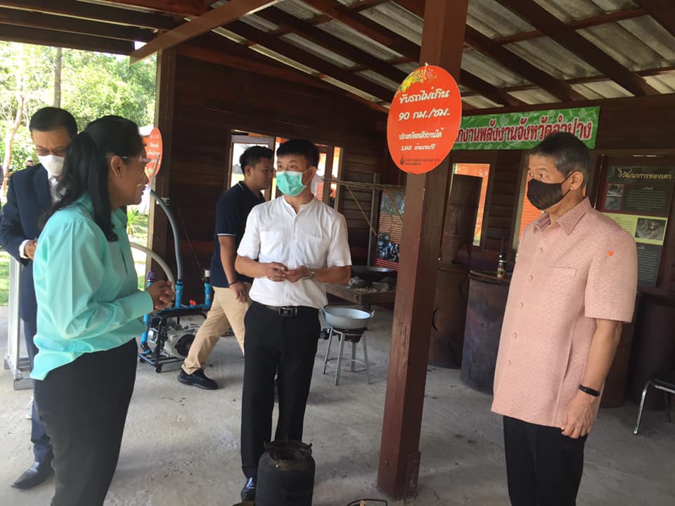

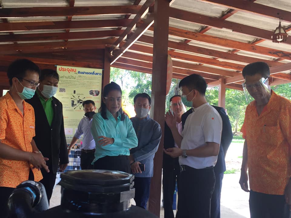

Ministry of energy with educational entity… Science Center for Education… The future engineers
