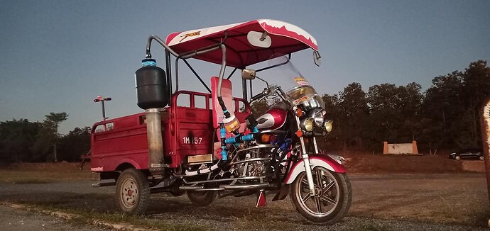

Koen, is that motorcycle a shaft drive or chain drive? And how did you bend your pipe?
Over here, motorcycles are too expensive to play with.
Nice !
Hi Jeff,
I doubt that the motorcycle owner is playing, if you mean wasteful frivolity. Over there everything is too expensive to play with.
Also, I am thankful for your beautiful work that looks seriously playful to me.
Hi Jef,
This one is shaft driven
There are kits available for / with rear axle , shaft and special gear, that fits on nearly any bike/engine

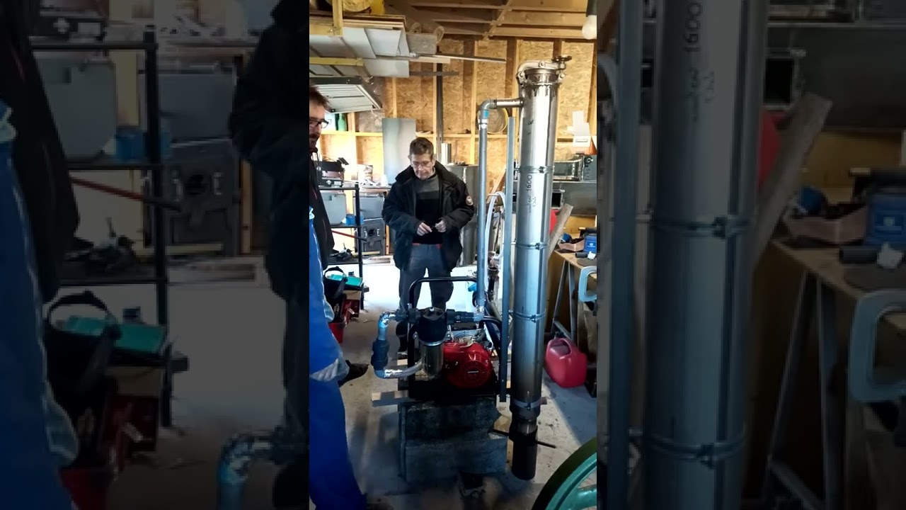

I got some kind of junk mail from Spanner re2
So I looked them up . They got project running again in Thailand
With the newly installed wood gasifiers from Spanner Re², the biomass power plant manufacturer from Lower Bavaria is getting a failed wood gas project from a non-Re² manufacturer in Thailand up and running.
Proven wood gas technology from Spanner Re²
In the repowering project, two biomass power plants from Spanner Re² with a total output of around 140 kWel and 260 kWth of the type “HKA 70” were installed. The customer’s existing old contracts were integrated into the project. An expansion with further biomass power plants from Spanner Re² is currently being planned.

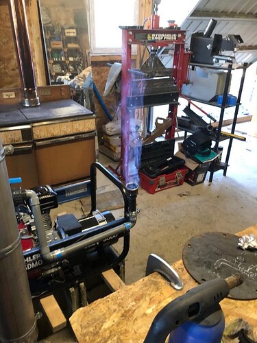

Thanks Koen, very interesting. My easiest suply would still be sawdust. This looks like a very easy way. Would it be engine grade gas? Edit, of course not. Stupid question.
Btw, the only word I understood was gasifier.
I see a long pipe going to the burner. Naturally this will cool the gas. I think a lot of tar, vinegar and water will condense in there. Perhaps these byproducts could be collected and used?
