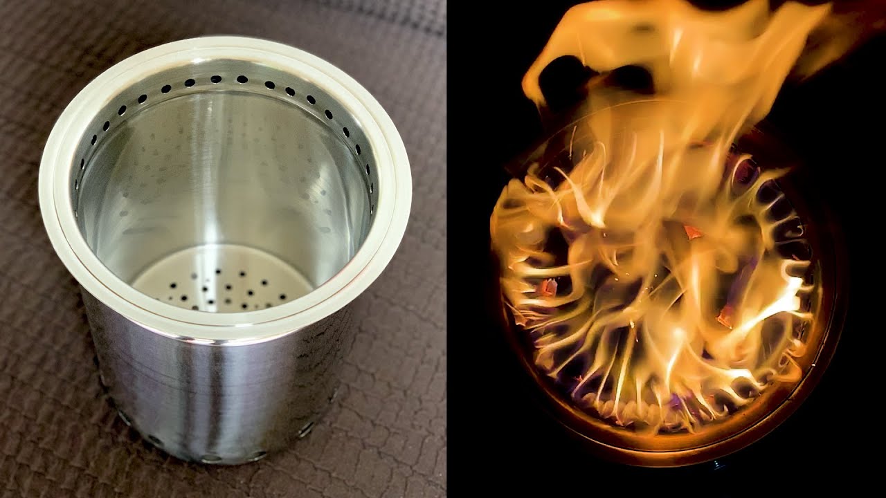

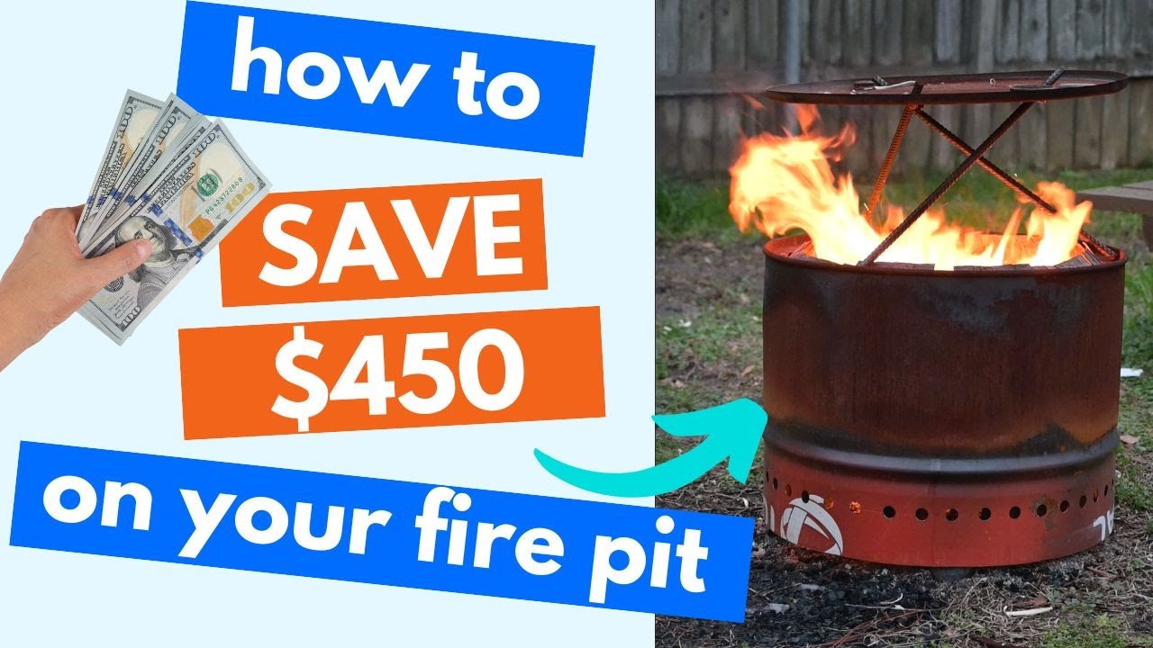

Does anyone have the design considerations for a smokless fire pit. I have a 55 gallon barrel and a 40 or 50 gallon hot water heater tank to work with. I need to boil water in a large 15 gallon pot very shortly. ![]()
I was going to do something like:
But make it taller and use the water heater tank on the inside which should be thicker metal so I could put more wood in it. But I don’t see any of these with any sort of ash clean out. So what do you do when you get a bunch of ash in it? I probably can’t pick up a full pot. I can’t have coals on the ground per the township rules. Any ideas?

I think I will just end up cutting a barrel in half, then use a lid on top. with a hole in it big enough to slide the roughly half the water heater tank in.
I am trying to figure out the ideal hole sizes and placement because ideally the secondary air reaches the middle.  maybe I am overthinking it. ![]()
And if I do that, am I going to be able to get away with fireplace sized chunks cut in half or will I have to get them smaller? Everything I have seen with solo stoves uses really small chunks.
