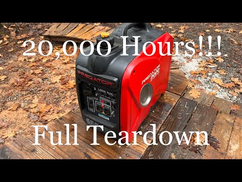

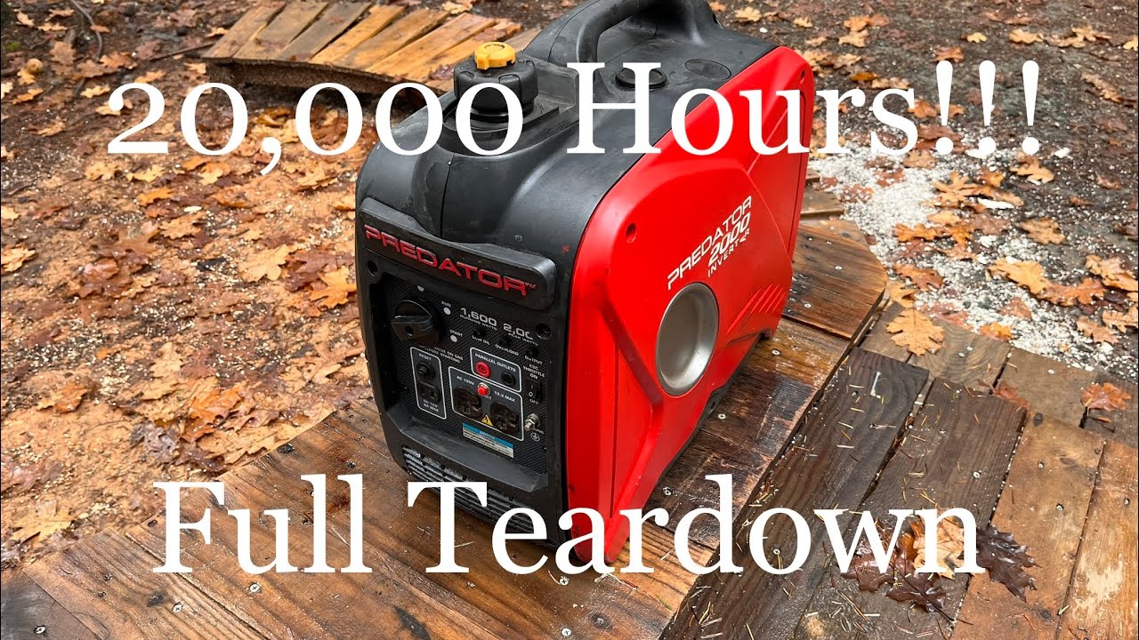

Here watch this one that popped up to my attention. You will have to slow the playing speed down to .25 and still have to click on, and off pause, a lot to see the details. I watched especially to see the manufacturing design for heats managements and the actual assembly quality. Impressive.
I do believe the man did use this little 79cc engine as continuously as possible for his claimed 2 1/2 years. With hundred and hundreds of stops to refuel. And later to do a lot of oil level topping up. So not an actual 20,000 hours running. But still outstanding.
Interestingly; he makes no claims for any of the exclusive-use super brands of oils like AMSOIL; Redline; Royal Purple. No claims for a super oil supplement either.
Then a video popped up with a guy choosing to run three of these Predator 2000’s in parallel. Sounds like the old multi-engine bombers planes or 50’s air liners.
I know a guy from a homesteading site I’ve been on for a long time. Been off-grid for 14 years and only got PV in the last three or four. Before that his sole source of power was a couple of 2000 W Honda inverter generators. Admittedly he had a small engine repair shop for a while, so he had skills, but he claimed 23000 and 24000 hours out of his generators. I was a little skeptical but he insisted he was not blowing smoke up our exit ports. Only problems I remember him mentioning was some kind of nylon gear set, maybe he recoil starter, wearing out. Kind of make me understand why someone would spend all the extra money for the Honda.
I have an extreme example of a heavily abused 2000w briefcase generator from Harbor Freight. It was given to me in a locked up state. Plastic body rotten from the sun. Someone used it to power an electric compressor and other tools for a roofer. Acetone+ATF mix down the spark plug hole, and a wrench on the crankshaft gently working back and forth got it loose.
I don’t know how many hours were on it, but I’m 99% sure it locked up from a lack of oil changes or even topping off. I’ve yet to make a frame for it. I tested it with a 1400w heat gun and it works.
Couple of three-four factors in-play for these extremely high hours of engine life claims is that in both cases the engine was never allowed to go cold. And in generator duties they were never actually ever low RPM idled.
Very well proven and observable that an IC engine set up for best internal clearances for warmed up running will have increased internal wear and rings blow-by until all up to stabilized running temperatures.The combustion exposed surfaces of the piston top; valves faces; and the in cylinder head combustion chamber then all up to good fuels ionization temperatures. The fuels carbons then used as fuels and not freed carbons depositing/coating.
Kept above a low idle RPM the crankcase is sucked clean of vapors and fumes better.
The engine oil at at heated/RPM pumped distributed better and more evenly. Splash/flung oil lubricated better too.
The most abused small engine I have is on the garden rototiller. Only has ever gotten one tank of fuel ran through it in any year. Year after year. Even changing the oil every year it puffs blue oil smoke now.
The second most abused in on the log splitter. I cold start it up nearly daily sometimes 250 days of the year for one wheelbarrows worth of fire wood fine splitting. 20 minute runs. Still good compression with little oil consumption. The benefit being using Castrol 5W-50 Fully synthetic oil changed twice a year. And letting it to run those 20 minutes after every cold start at 2400-2800 RPM to heat the oil; evaporate-out , and suck out the internal condensates.
Just my observations.
