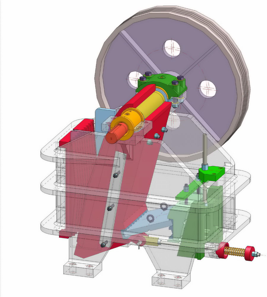

Щековая дробилка 300×160 с бензиновым двигателем 7лс. подробности в описании.
all slovenians have stone crushers, so also we “need” one…planned is a little machine for producing some sand as we have here a ideal , not so hard stone…

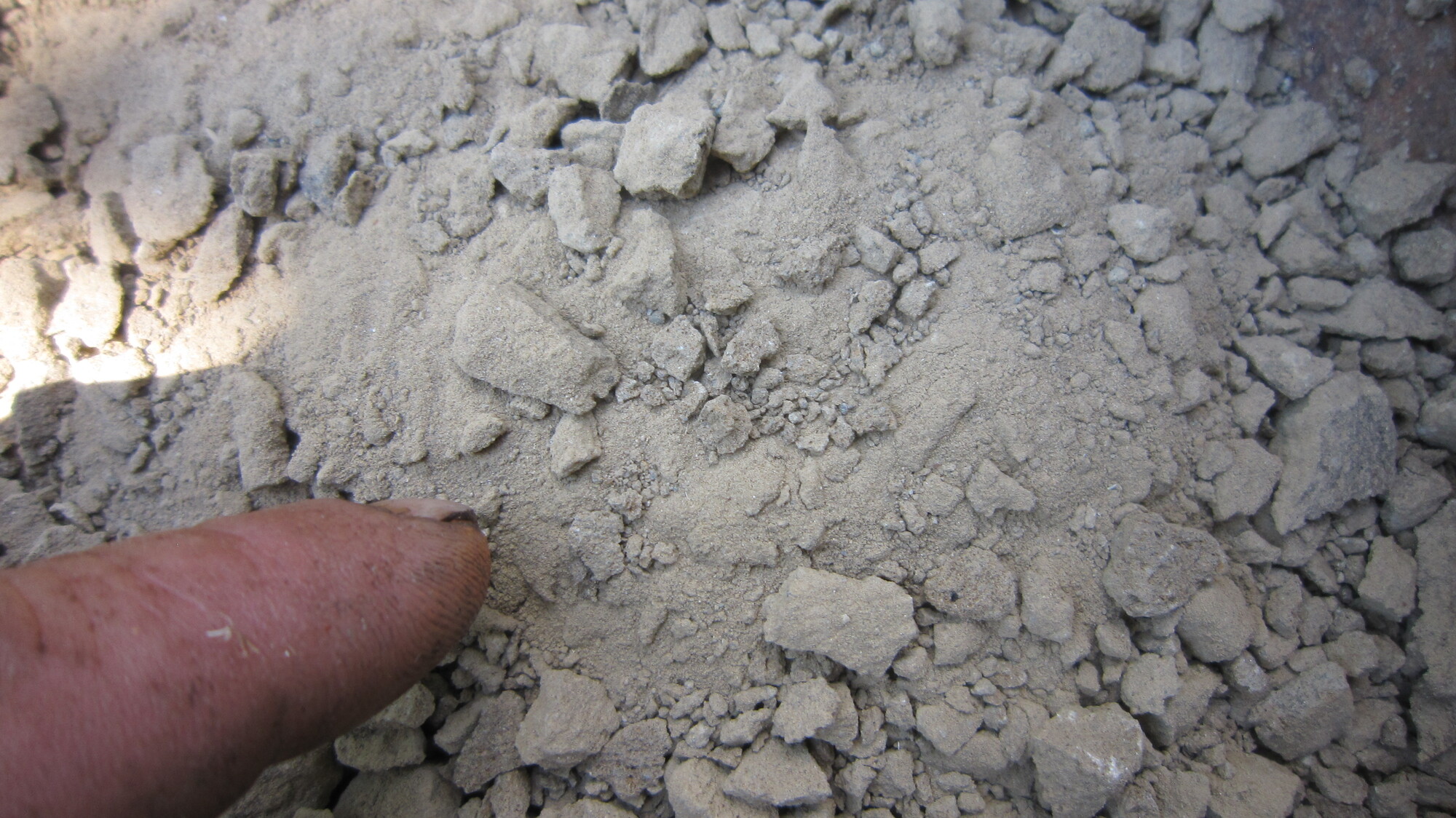

this is the stone crushed with a hand hammer, a kind of sand stone

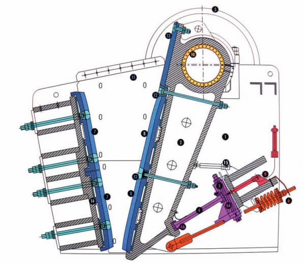

a lot of self builds are to find in the internet…now i look for informations and scrap, and have a question to tone: your ratzinger crusher has ball bearings or bronce bearings on the excenter plate?

I wonder as you, would a wide bronze bearing be better, or a row of sturdy roller bearings?

from my experience i would recommend to pay extra attention to toggle plate geometry, minor changes there drastically change crusher operation.
Giorgio, I think all the bearings on the Razinger are roller bearings, …
If you are interested in the geometry and any details, he will measure and draw them, it is actually as Andris said, the way the jaws move is very important and also the speed of rotation, too fast rotation is not good, because the material does not have time to descend lower between the jaws and the grinding slows down.

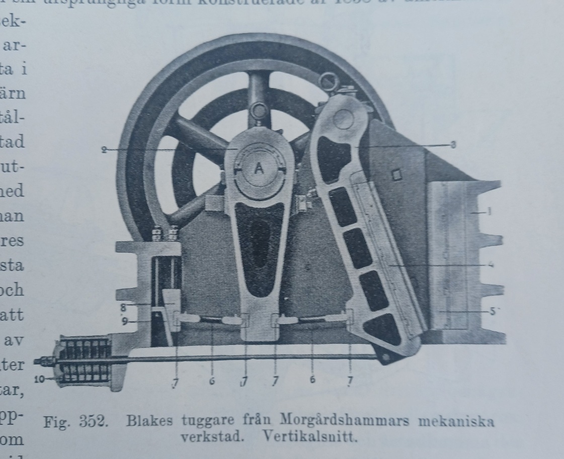

Here comes a picture from an old book, this is called: blakes crusher, after its inventor.
This is maybe how i would build mine, observe the linkage mechanism, more complicated? I don’t know?
göran, the topic is for discussions and finding best and easiest solutions…i understood there are two different systems of linkage, a simple one with the excenter direct on the crusher plate and one like this on your design…advantages and disadvantages?
