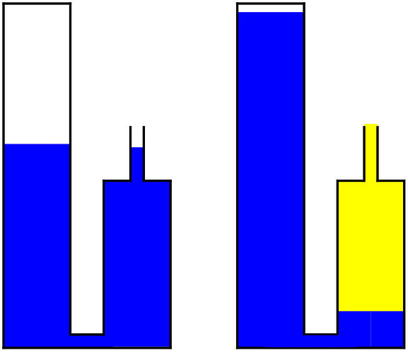

I use this kind of setup…
the gas is getting compressed into a vessel, replacing the water.
the second vessel acts as an air cushion to increase the pressure in the tanks…,
The gas never comes in contact with the air or oxygen and can never comes in the second tank.
Blue is the water, left tank is without the gas
Yellow is the gas, at the right , replacing the water.
Koen,
This is a great idea. Very safe and does the job nicely. That’s the kind of thinking I was looking for This topic should be it’s own thread so it can be refered to by those thinking of storing gas.

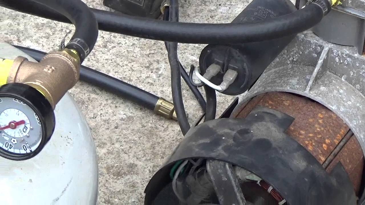

And see how much gas it holds at 100 psi,with 5 gallon water bubler to be safer, That air leak in his air pump head gasket, seems like it might draw in extra air that dident get drawed in above the grait whare it was depleated in the gas makeing fire tube.allthough i do like the idea of brian w and put the propane storage tank inside of another tank maybe bolted to the cement with air holes on top and bottom, to keep any external leaks from building up. ALLTHOUGH I AM NOT RECOMENDING STOREING WOOD GAS.
