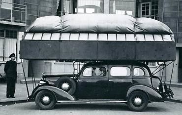

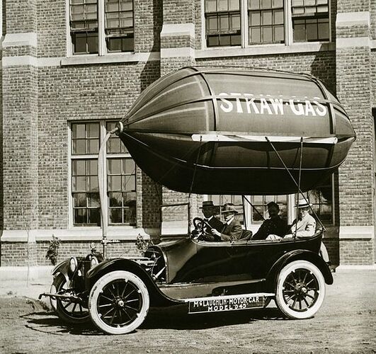

I see guys storing woodgas to 90+ lbs. in propane tanks. I don’t think you can go more than 30 or 40 lbs in a rubber bladder? I don’t know. I do know I’ve seen old pics of cars and buses storing woodgas on top of the roof. I would like to rid myself of as much dependency on oil as possible. That is my goal. Oil companies have made my life miserable. I agree about the safety factors…That is the main reason for the discussion.
allso farmers store methane fuel from cow crap.I am not sure ware the farms are,i am sure they have safety senser shut offs built in too a sereies of lines ,before the fuel gets stored ,it must be cheched for oxegen, as it is being made and then stored, I am not trying to be condesending, only trying too help be safe.those bus tanks on the roof are like ballons, as the fuel leaves , the bladder tank shernks,too keep air out,till the gas is gone, like a ballon.That gas likely was monitored for oxegen before it was loaded in the ballons.Happy new Year YOUR GASIFIER IN THE VIDIO LOOKS GREAT, KEEP US POSTED/ BBB

Just had to throw the Haleson motorcycle in because it was so cool
That is a very cool motorcycle. Check out the size of the ‘gas’ tank in the second picture! I wonder what kind of range they had with that. I would have to guess it wasn’t very far.
One thing to note on the bladders is: As far as I know, they only used a few of them on rare occasions and only for a very short time period. Those HUGE bladders gave only a very low range but were effectively driving around with a “Hindenburg” on top of your car. Very low benefit for extremely high risk.
Remember “Just because some guy did it and took a picture of it, does NOT mean it is a good idea”.
Ha Ha Ha. These pics are for entertainment. I’m not advocating going back to driving with balloons on our vehicles…please. I’m advocating having a reasonable discussion on the viability of storing woodgas for later use as it is done around the world in biomass bladders instead of storing it in propane tanks. Safety and responsible storage is a possible need someday. WE are woodgassers!!.

sorry about freeking out on wood gas storage,as the pictures show they did it in ww2 ,safty design oxegen monitor ,should not be too hard too build.At least i would want too have a gas oxegen monitor system in line and tank, not sure what kind or type of meters would work good ,good subject.
