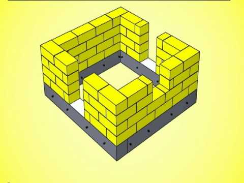

Hi you all, I found this video that could be of interest in a contruction method.
take a look al this one in Spain. A full 2 floor house made of straw blocks
