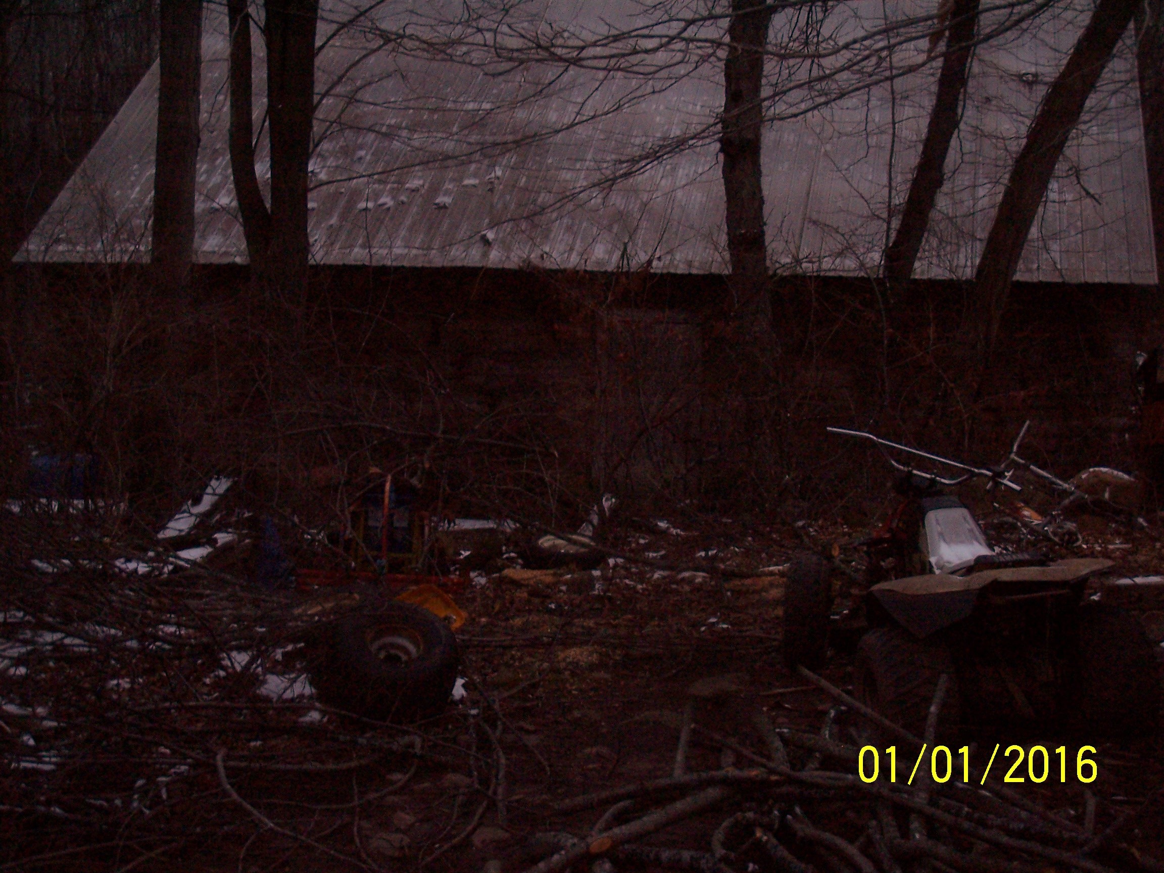

40 x 40 keeps me out of the cold 8-10 hours a day.
