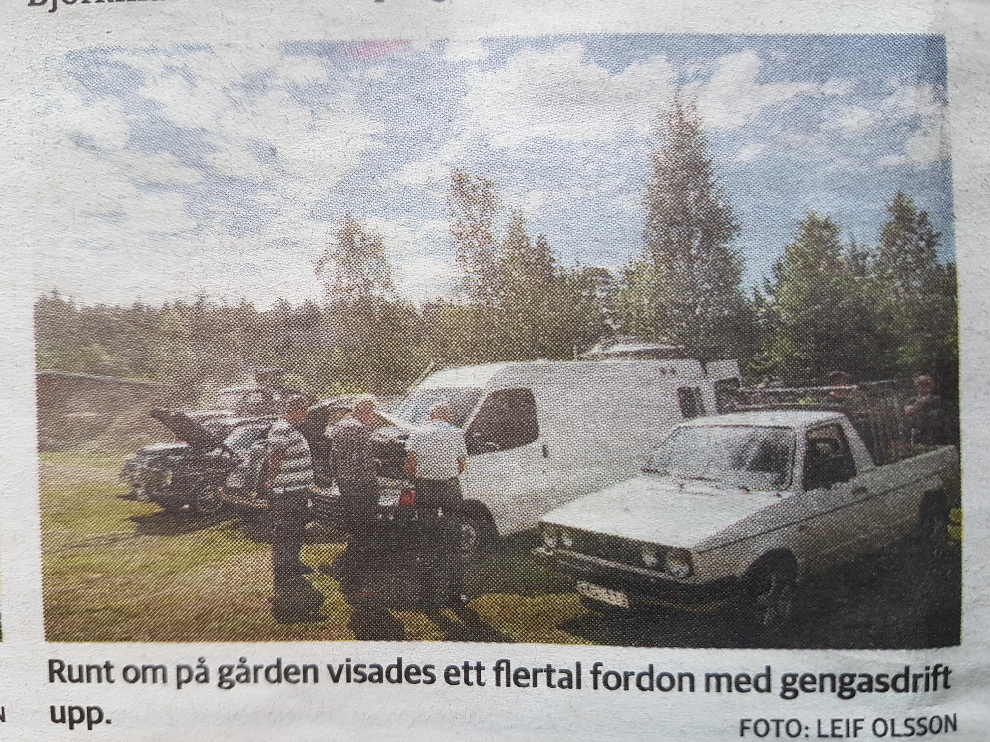

Look at those van pictures.
That is an American/Canadian “slant-six” Chrysler/Dodge I-6 pushrod overhead valve cam-in-block engine transplanted into a later model European van chassis/body.
LONG engine. Why the grill cross member cut-out.
J-I-C Steve Unruh
Huh…good catch… Steve’s a MOPAR man.
Right Steve. He was allowed only half a gallon of gasoline tank to do that engine swap. Reduced woodgas power registration was ok. However this engine is turbo charged 1.0 bar which is when it starts knocking, even on woodgas. Higher charging the timing had to be lowered.
