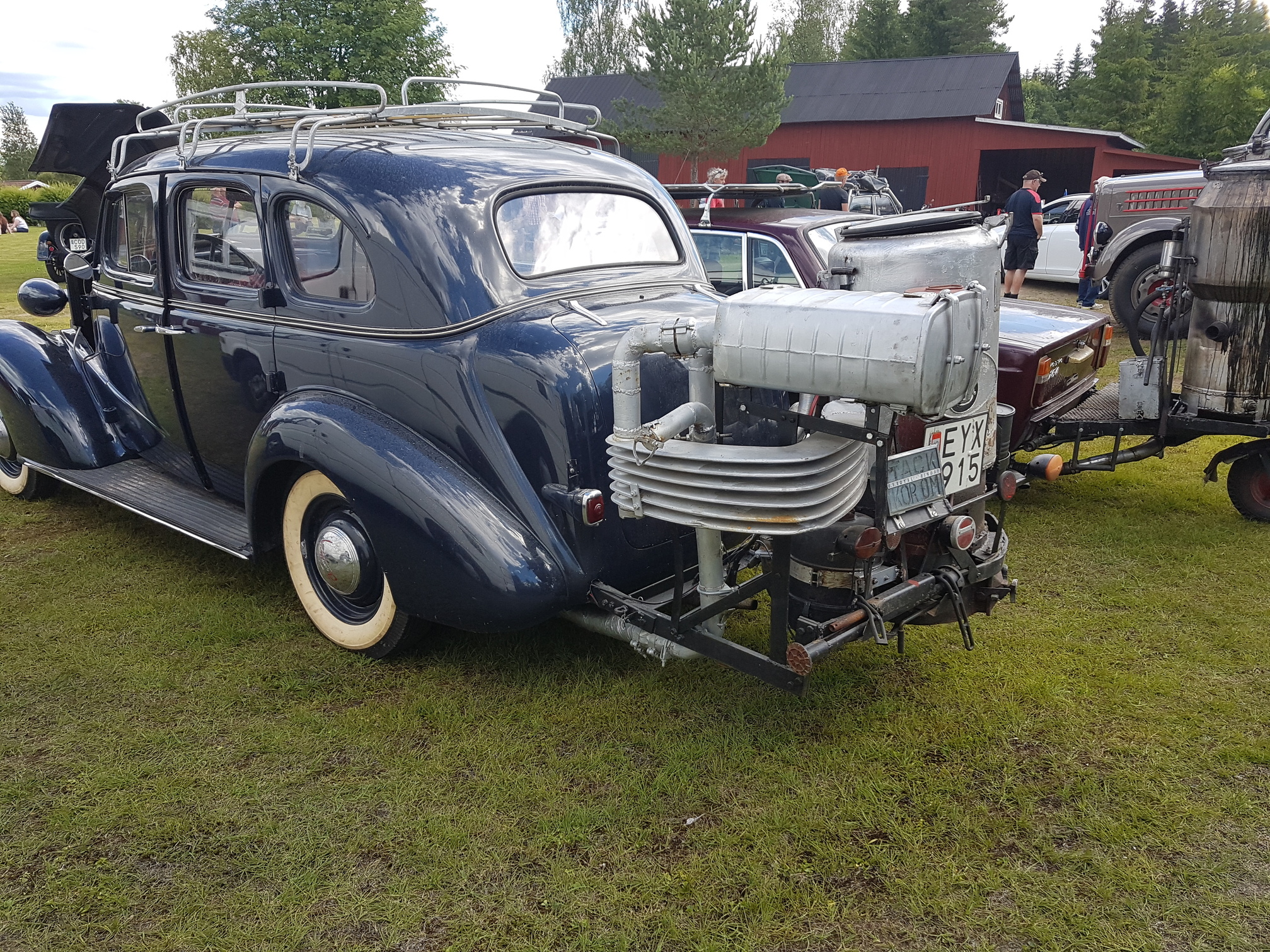

Pic 1-3 Nostalgia

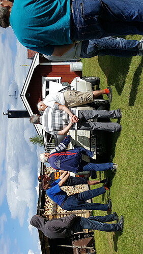

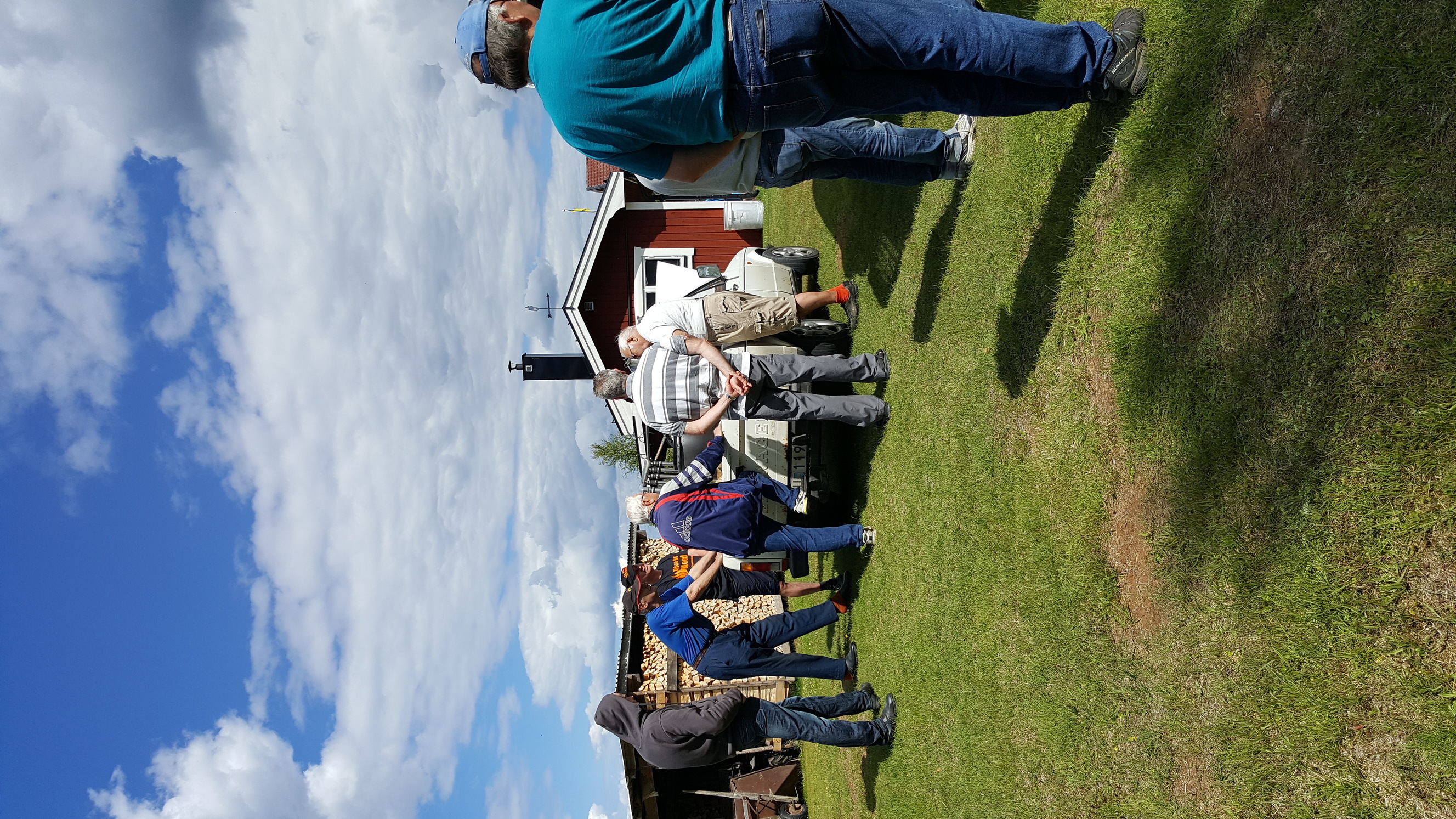

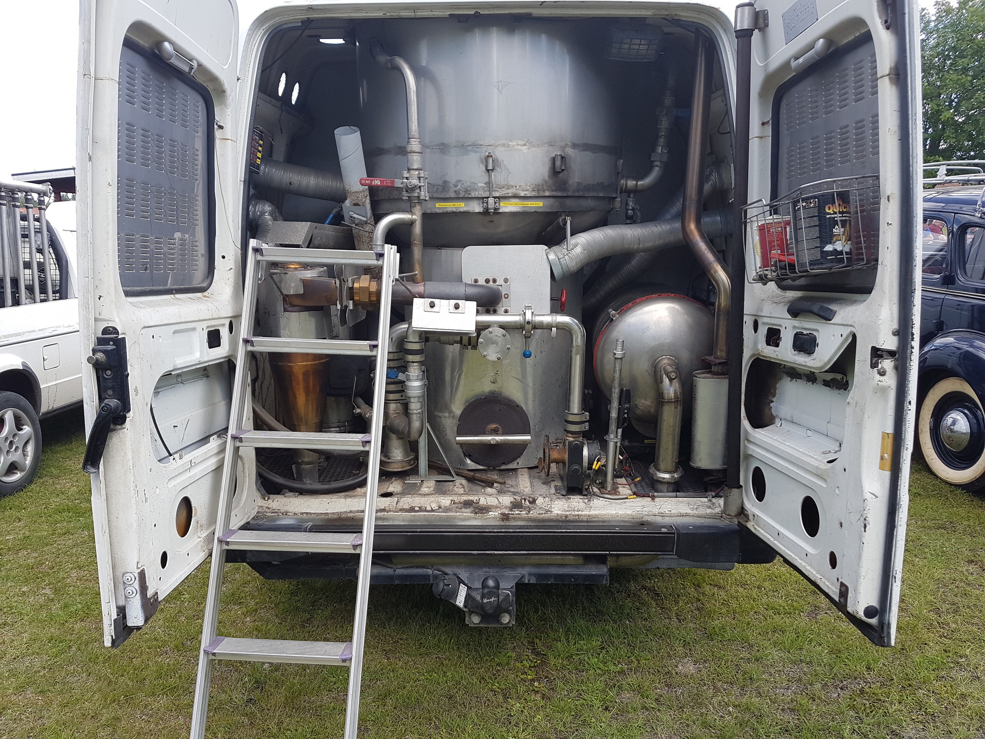

Pics 5-7 Van with monster hopper and turbo

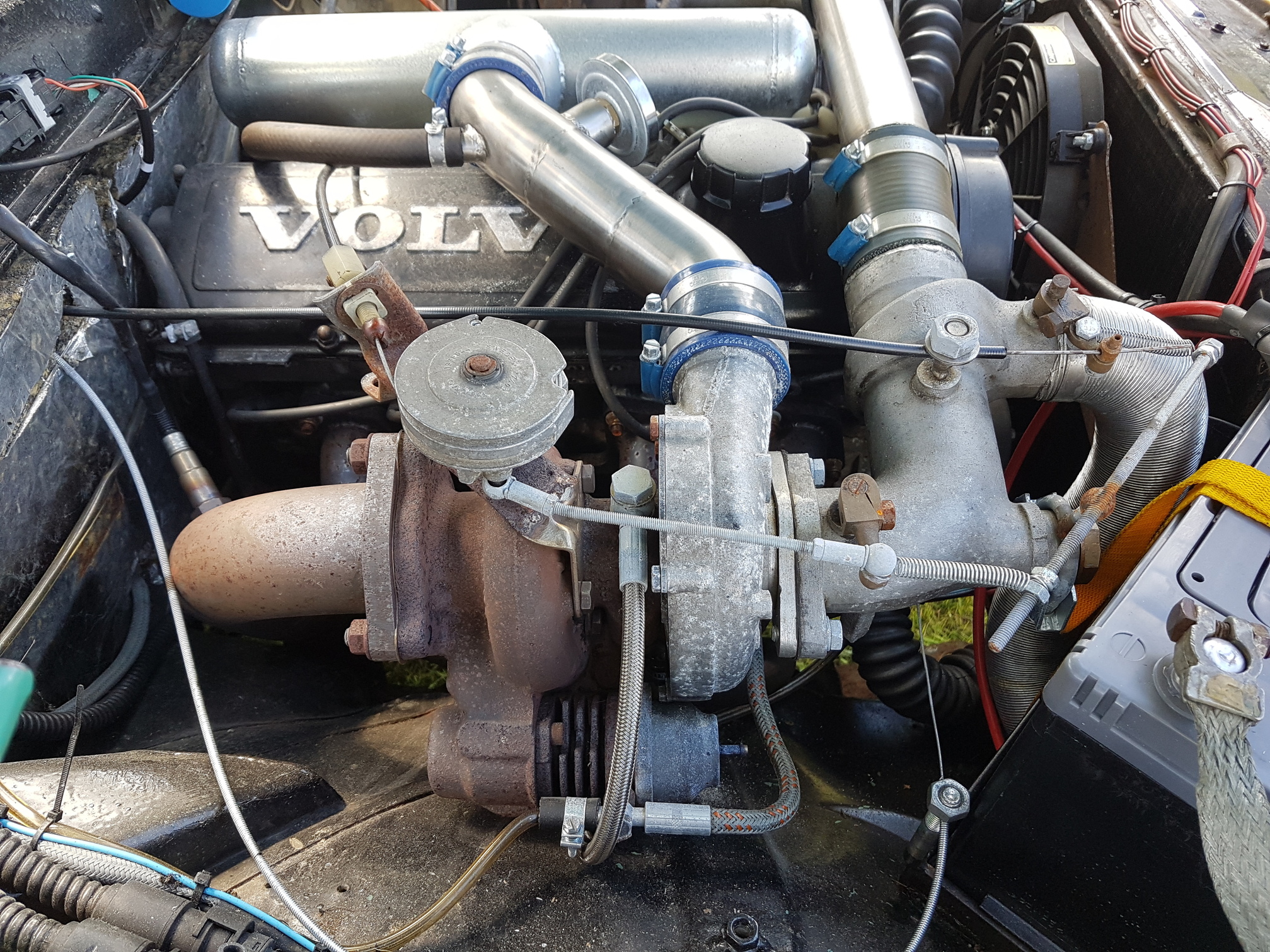

Pic 8-10 Volvo 142 with turbo

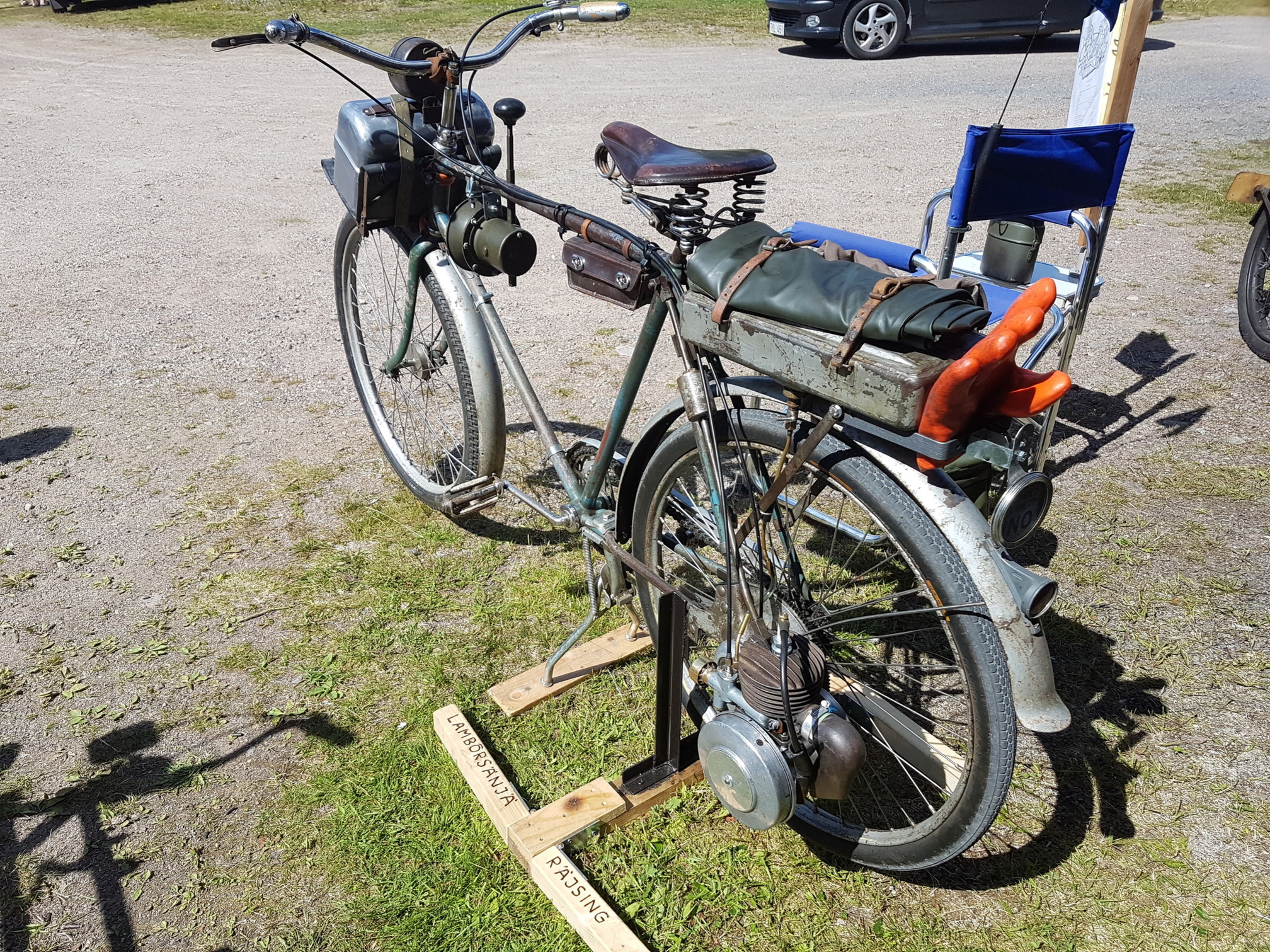

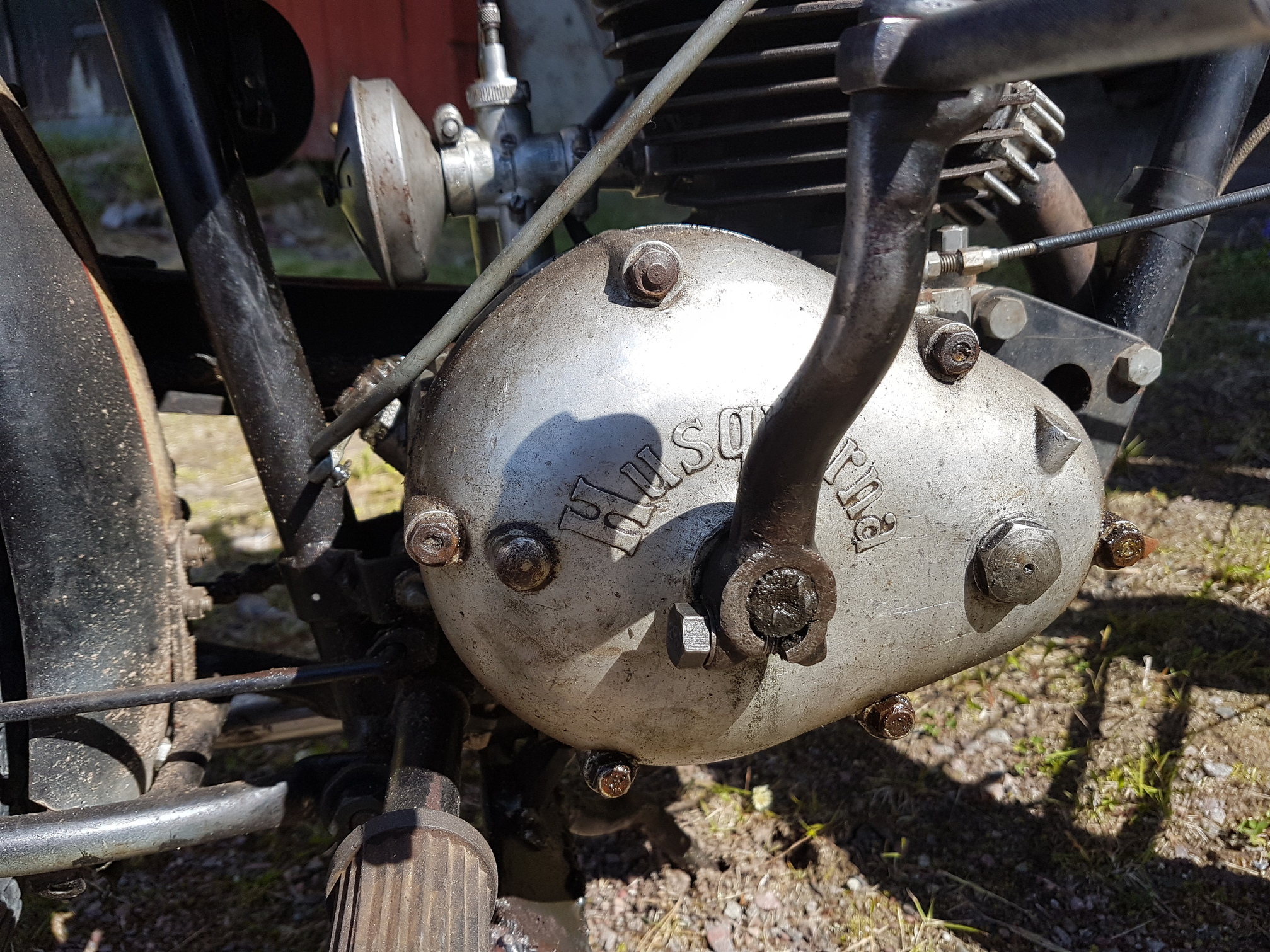

Pic 11-14 Old motorbikes. Not woodgased but…

A Husqvarna bike! That’s neat!
I think I’ve seen that van with the monster hopper somewhere before… Isn’t it fully computerized or something?
Yes, lots of gizmos on that one incl turbo. The hopper is good for 200+ miles. We agreed with my milage and that hopper we could drive for 1000 miles on one fill :smile:

Good looking 36Chevy even without the gasifier. I have seen the type of gasofier that is on the trailer but have no idea how it works with the tubes… are they for condensate? Was the Volvo originally eguipt with a turbo and just added wood gas?? What was that truck every one was trying to hide by standing around it??? Looked like it drew more attention than any other.

This van guy is 76 and from Köping, Sweden. Only 100 miles from here. We were so involved in discussions I didn´t catch his name. Sorry.
I guess you are talking about the cooler tower. Just cooler pipes.
No, the turbo was added with woodgasing. He told me he runs a low pressure, only 0.2 bar. Just enough to make the car run standard gasoline performance.

And I thought they only made chainsaws.
Interesting how the motor wheel gear clamps to the spokes. Must take some tweaking to get it aligned. Thanks for sharing !

Jan-Ola, that white van looks like a 2 ton vehicle. Even with the big hopper do know what the milage was before refilling and how many pounds per mile it would drive on.

So much interasting things there! What is the purpose of that cyclone filter in the engine compartment?
Ilike the turbo volvo too! Thats a wery neat solution of our problems if it works.

I dubt the van guy rips off that monster hopper every year :smile:
Hi Bob! Yes, that beast was a bit haevy. The hopper was good for 200+miles and he burned about 4-5 times more wood than I do at my 2 mpp.
That´s a condence catcher cyclone.[quote=“KristijanL, post:14, topic:3349”]

Yes, turbo seems to work good. However the Volvo guy told me his gasifier is sized the way that he doesn´t do idling at all.
