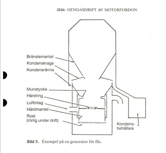

I found a writing about a Swedish generator that runs on chips, without any major changes, the biggest is probably a moving grate, faster start and better response, with chips versus block.
https://hosting.devo.se/smp/catview.html?method=start&viewMode=1&documentId=3216&pageNo=8
Hi Jan, that is the typical SMP-gasifier, evolved from 1974 models, built in cooperation with Volvo.
Nice you found this “library” of SMP (Statens maskinprovningar) they have done much tests with woodgas, much “ordered” from ÖEF (Överstyrelsen för Ekonomiskt Försvar)
I think it was Ă–EF that required a gasifier for chips, due to good fuel supplies (wood chips reserves, available at paper mills.
(Ă–EF=Head of economical defense)

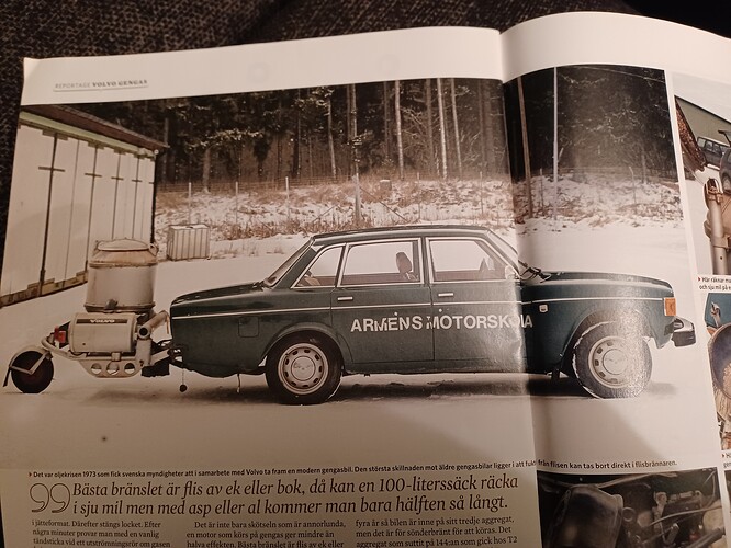

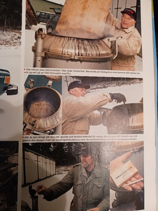

Edit: i just found these pic’s of a 1974 version, there are only minor differences, i think the one on the drawing are the taller type, for trucks and tractors?

Hi Jan, what i’ve heard there was a lot of problem with bridging, on “smooth” roads It ran just fine on, little bumpy, dirt roads.
There was also the opposite problem, with packed, tight charbed, on the smaller, car gasifier there was like a upside-down bucket, with holes along the sides, just over the hearth, to get like a controlled “dosage” or distribution of chips. At the larger gasifiers it was like a funnel over the hearth.
Ok, it’s like FEMA, sounds good to begin with.
Yes, exactly, this holds the chip load, not to stand it’s weight directly on the burn-zone/charbed, compacting it to much.
