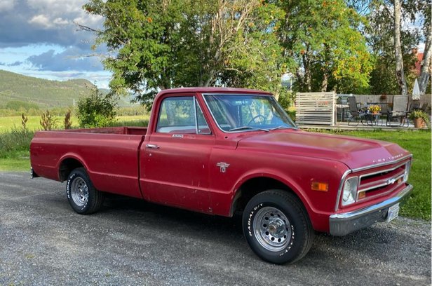

I think you should get a 1975 Chevy C10 1/2 ton truck. They make aftermarket complete chassis for them. (I think one came with a entire new drivetrain). You drop the cab and bed on them. Granted it will be expensive but essentially it is almost a brand new truck, that looks old and rides a lot smoother or goes faster (since a lot of them are made for hotrods) and you don’t have to deal with inspections.
Since it will rust out, you can replace all the sheet metal with stainless.
The kicker is, your whole drivetrain can be customized for woodgas, and you will be able to beat Tone’s tractor racing. :slight_smile:
There are about 20 C10s for sale in Sweden. This is the least expensive one. $16,600 :tired_face: Most are at least twice that price.
If you are going to do the whole frame replacement, you just need a cab and a bed and a few other parts, which means you need a junker with a vin so you can get a title.
No C10 junkers to be found. It seems they have all been restored. Whenever people spend $10,000+ in shipping alone - to get US vehicles over here - they don’t let them just sit and rot.
