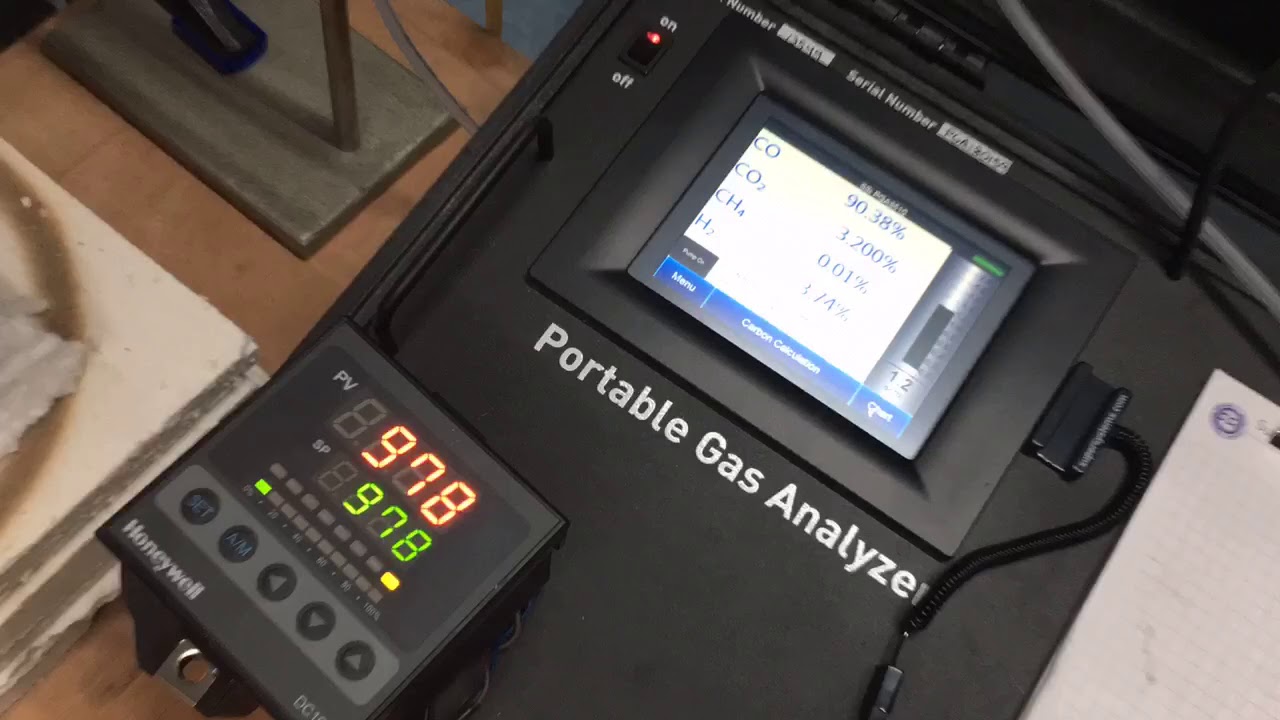

If you check this clip, then you see the reduction of the CO2 starting at a certain temperature and nearing complete at 1250ºC ( input gas was 100 % CO2 ) at the end i did have the insert probes molten (stainless steel) as well the Kanthal heating elements…
