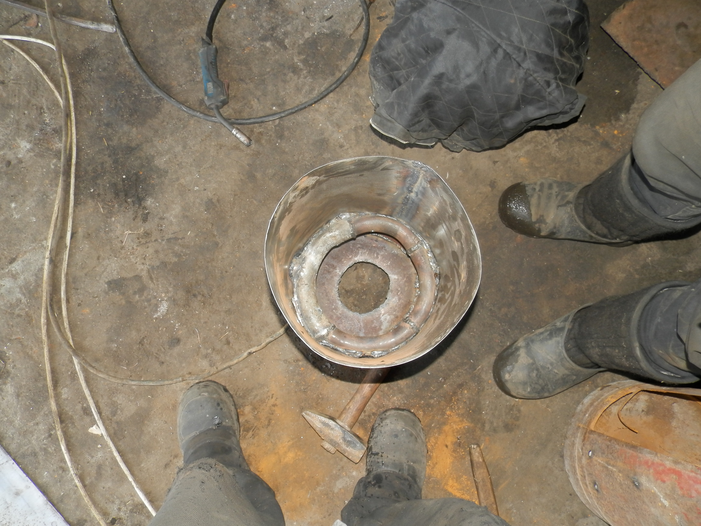

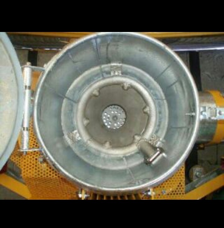

What did you use to bend that pipe the nozzles are in, Joni? I’d sure like to see more details of that unit.

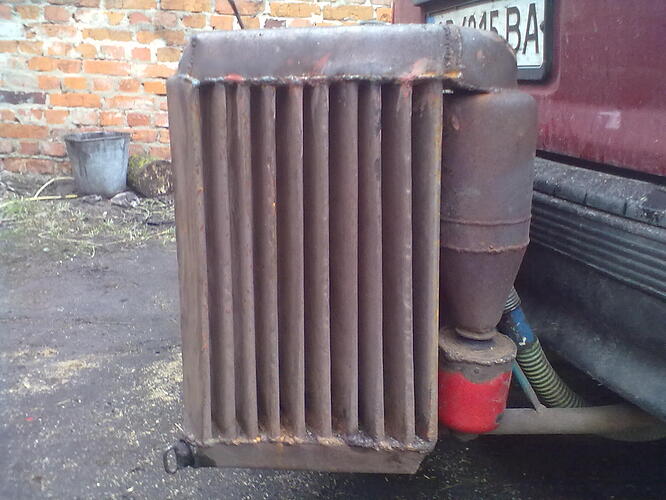

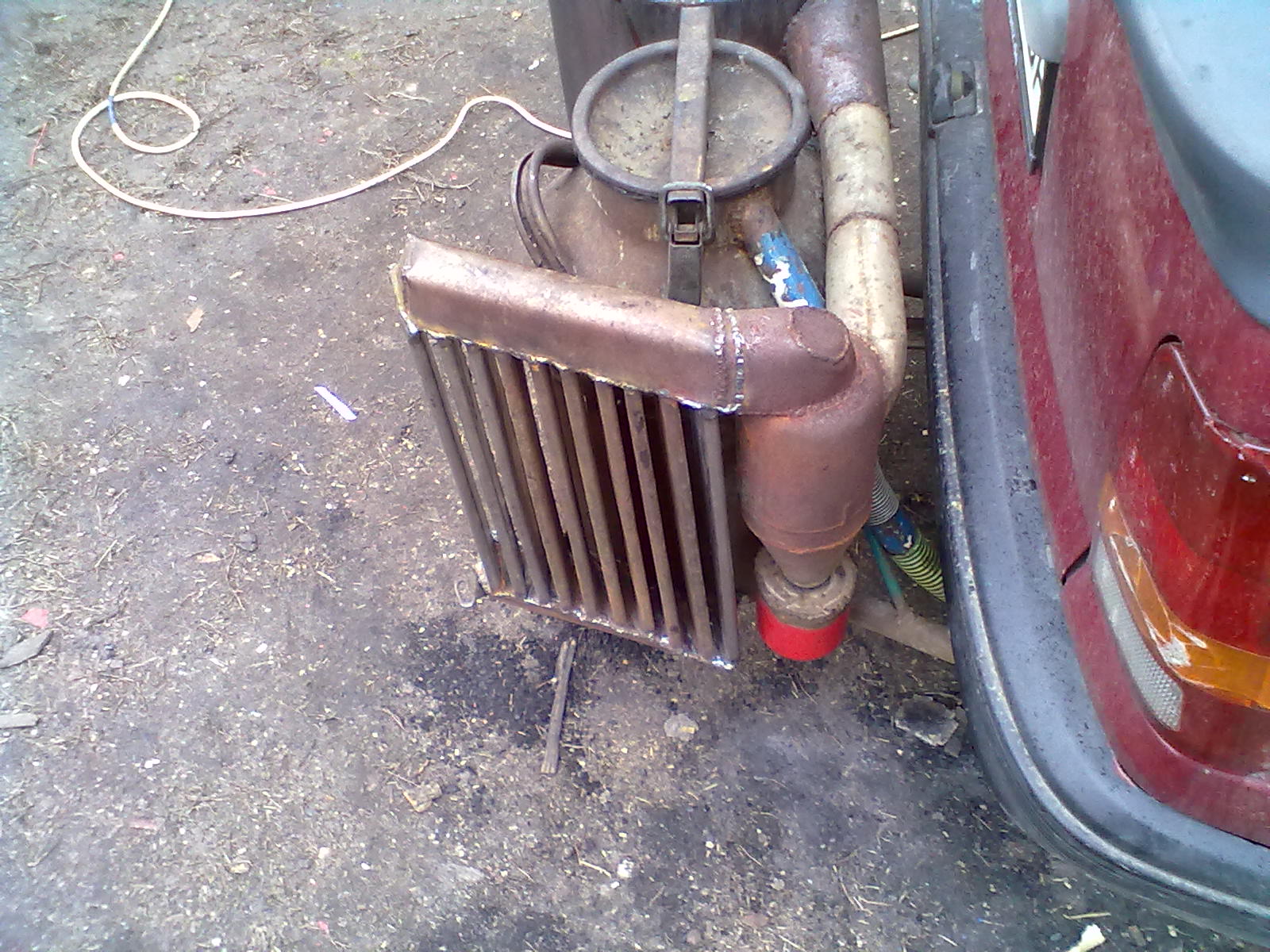

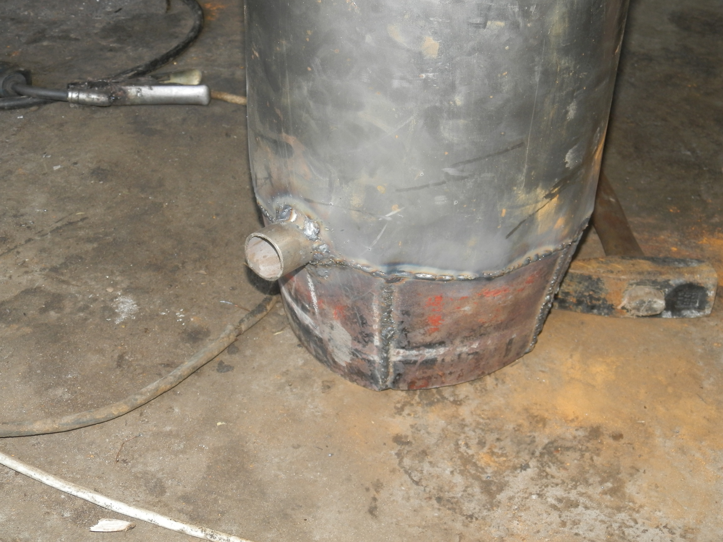

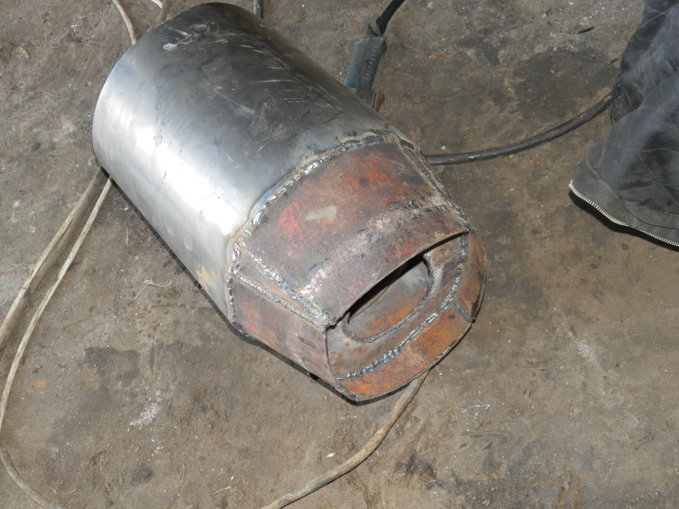

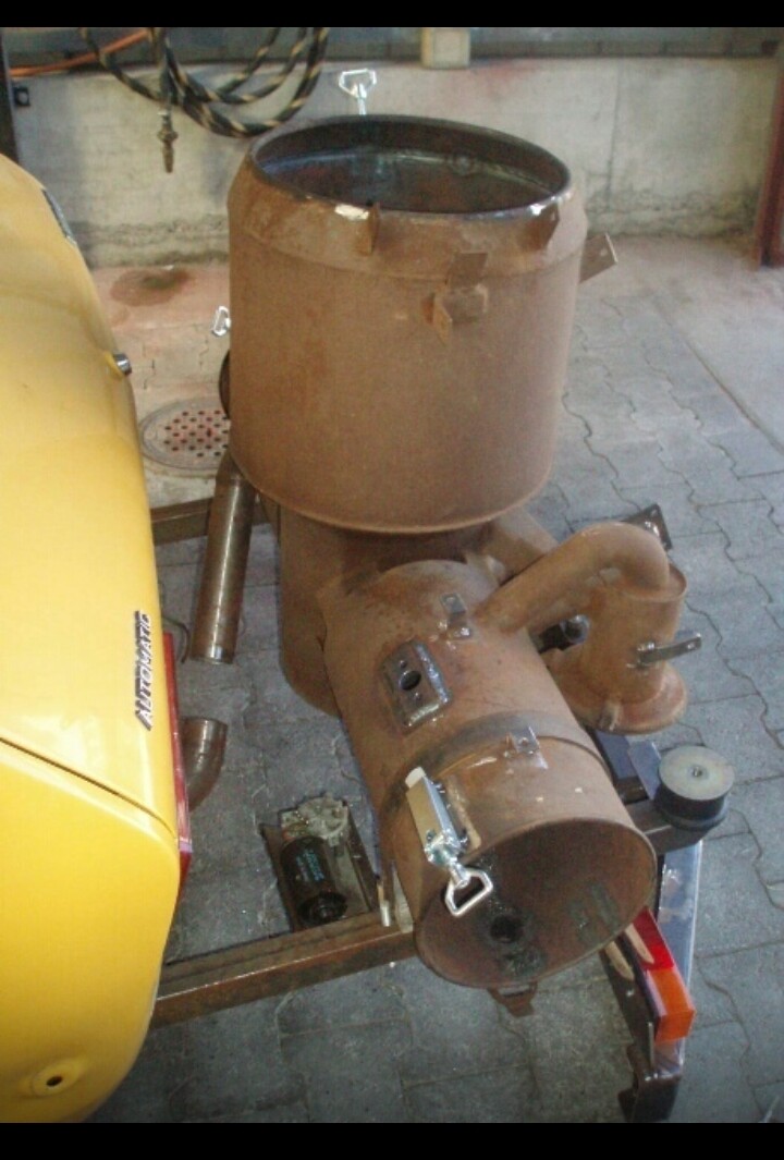

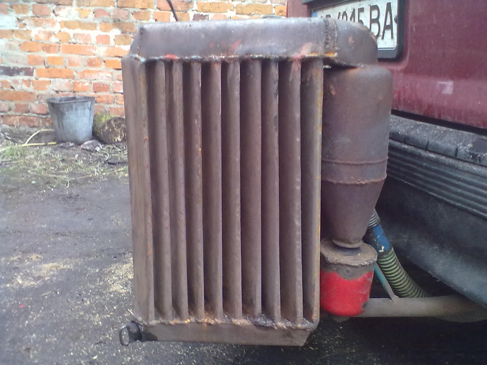

the unit couldn’t be easier! My 4.0 version was a copy of it (tuned to my motor) and was supplemented with a bunker heating. She showed herself well and it was very easy to assemble it. At the time when I used this system, I did not yet have information about such a design of the cleaning system, so I decided to go further. Returning now to this system, I think that this is a very good and workable thing. When making my gas generator to make an air nozzle ring for the air nozzles, I just bought four 3/4 "steel water pipe corners and welded them in a circle.
these are the photos that we managed to find about my version # 4.:grin:
the process of working on the gasifier version # 4 го
enamel finish would prevent erosion pin hole of gasifier

this is a cross cut of the WISCO-gasifier Joni is referring to:
Just scroll down a bit. Truly a clever and compact design.
It is the web page and car of Daniel Hagen in Switzerland. Many of you should know him.

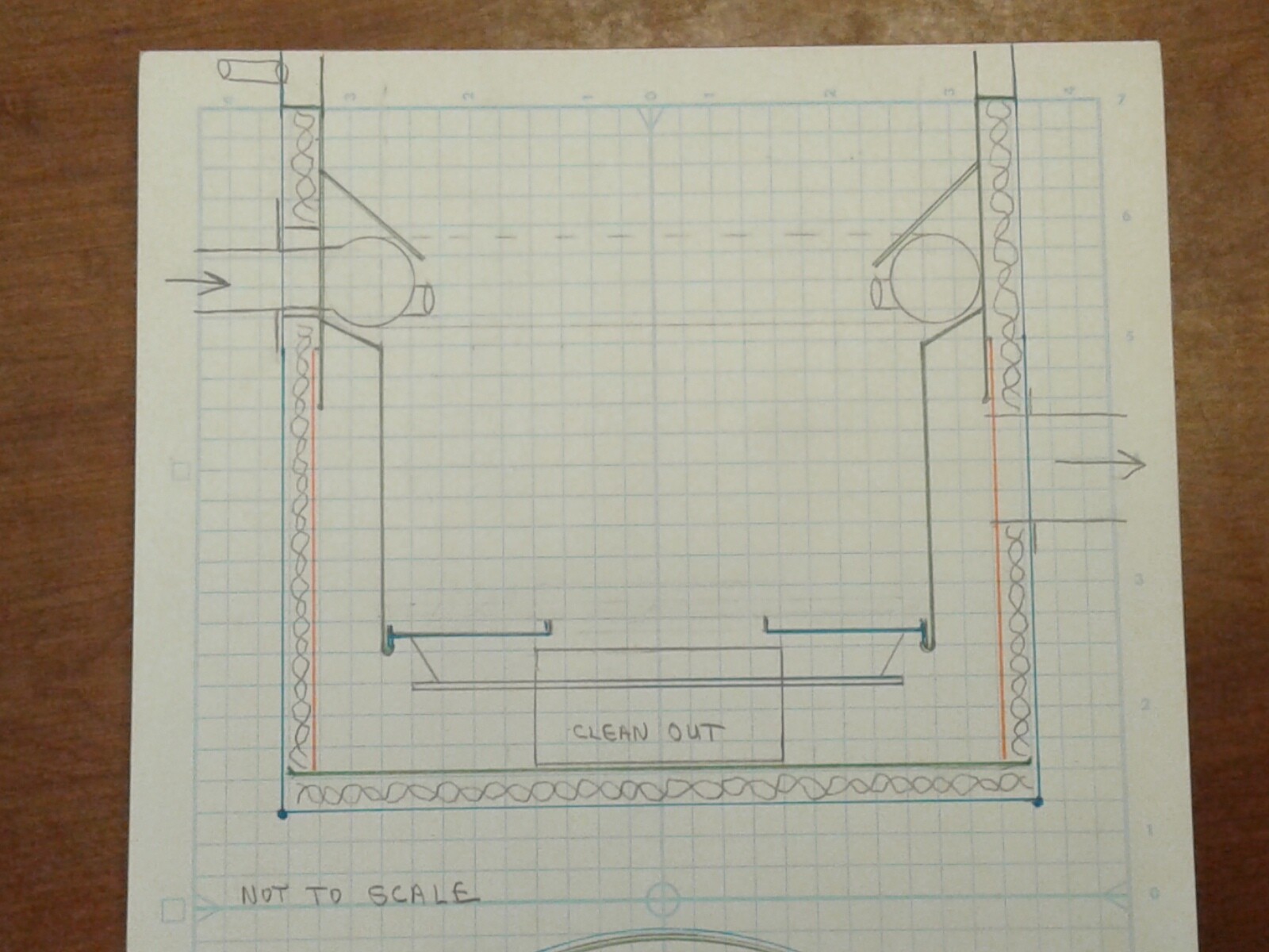

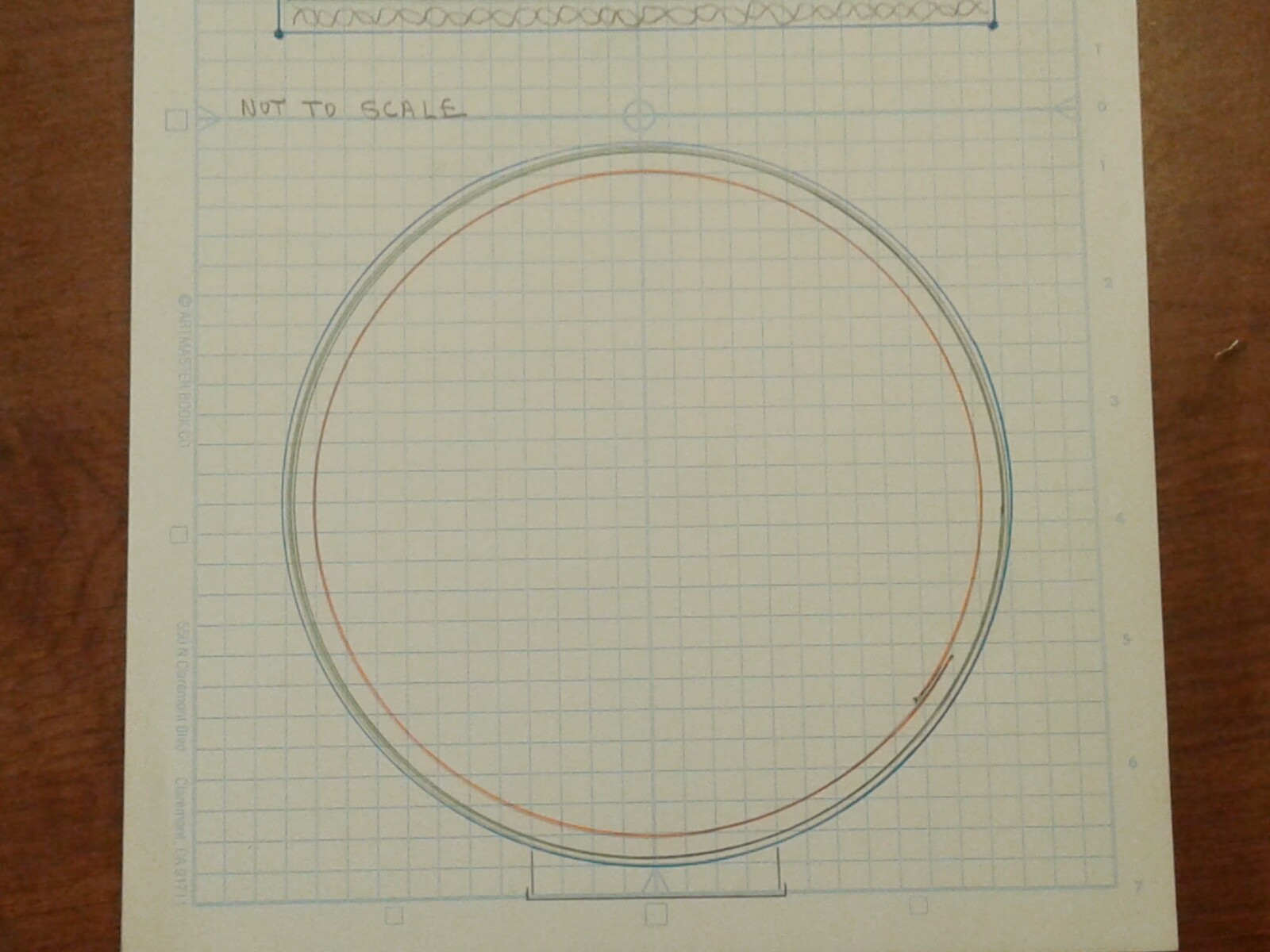

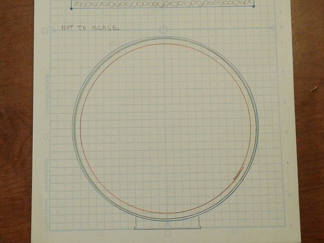

The Barrel in a Barrel in a Barrel has change thanks to Joni and other members you know who you are. The problem I have is I want to build everything way to heavy so the only way I can build a light weight gasifer is to copy a proven design that will work on my Subrau Outback. The drawings above is what I think mite work. As always your input is always welcome, I like constructive criticism and you can hurt my feels because I have alright be wrong on this build from the starting of the first drawings. Lol
You just got to love it.
Bobmac,

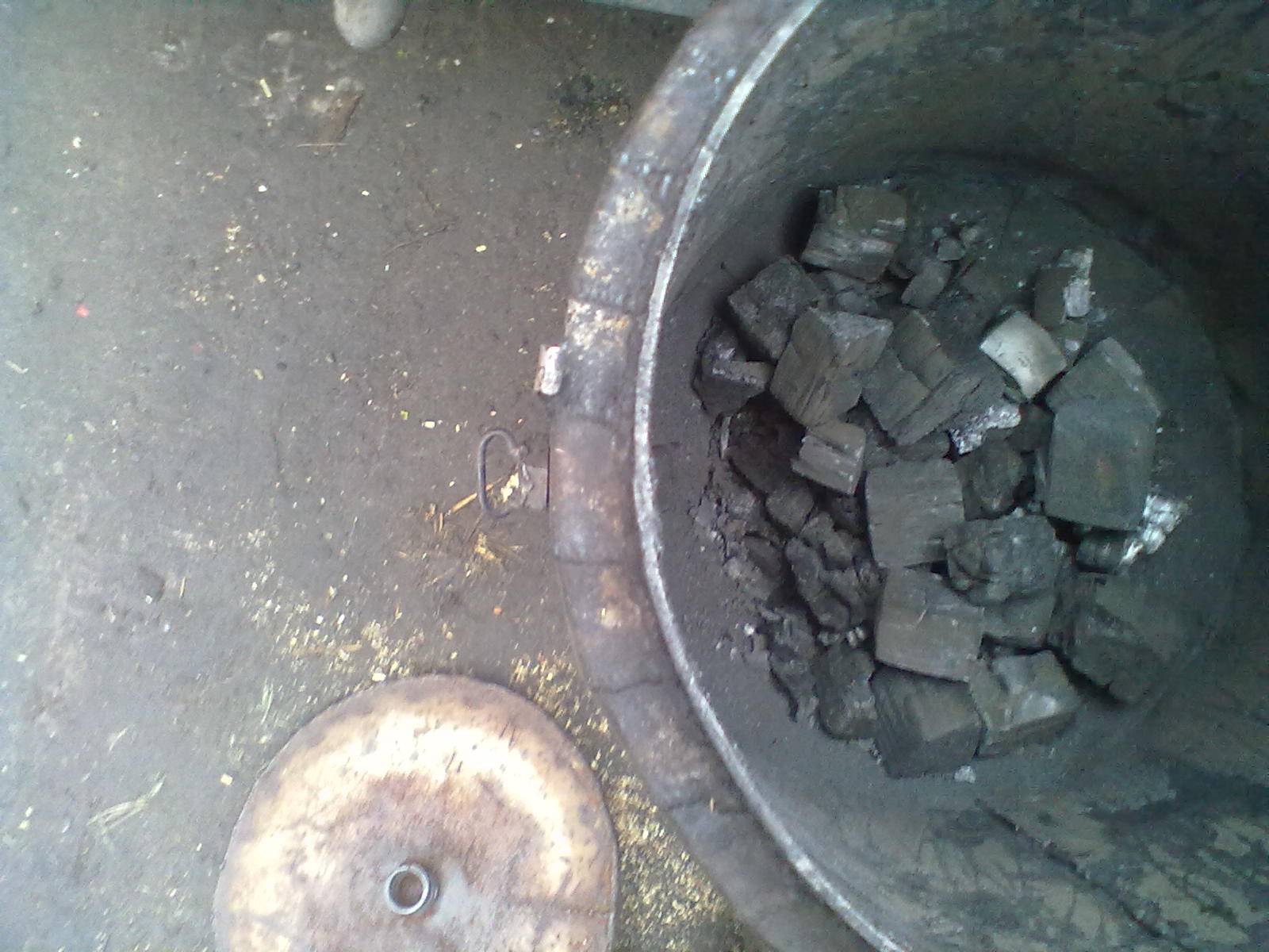

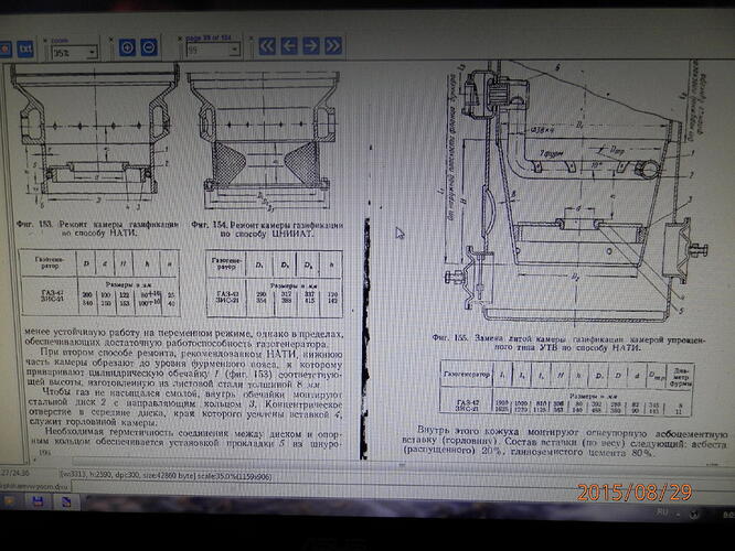

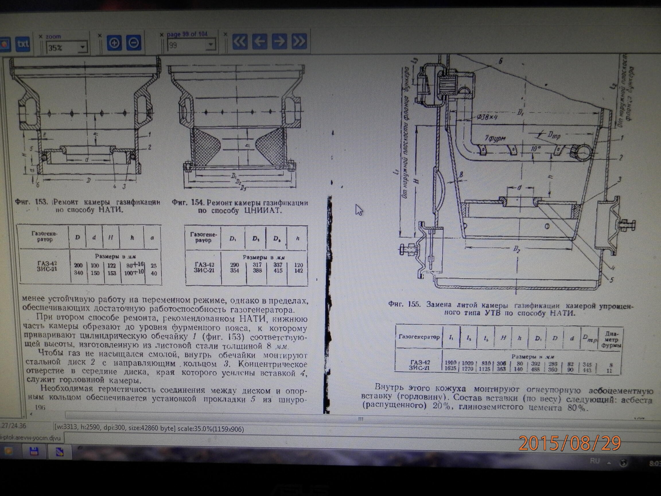

all this is good, but you need to raise the tuyeres upwards by about 10-15 degrees, and you do not need an “umbrella” above the air supply ring, it will be made with coal … You need to be guided by this picture.
That gas generator (with air supply through a pipe is designed for a 5.5 liter engine but with a low compression ratio (6: 1). And one more thing, I would make a grill. The tables show the dimensions for engines 3.25 and 5.5 liters.

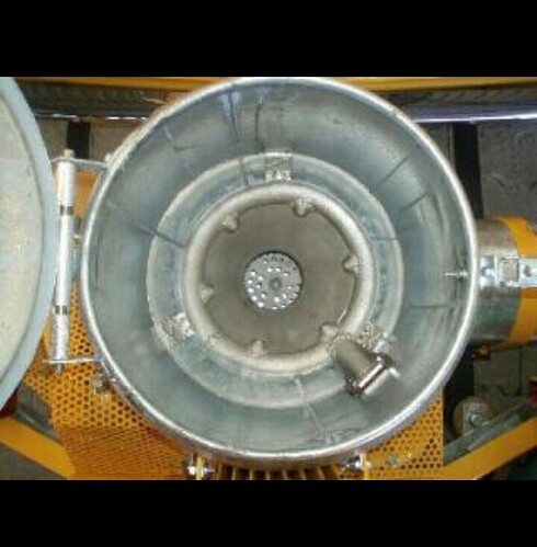

What is that business where the pipe to the nozzle ring feeds through the shell. I wish I could expand this view.
