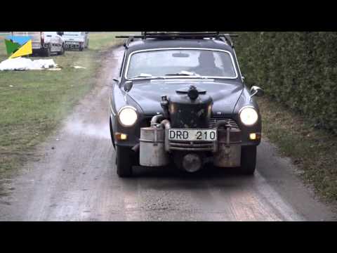

I would like to know more about this gasifier.
https://youtu.be/WZxWt7ZgXKc

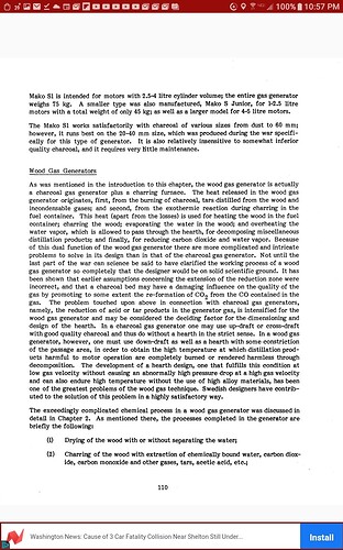

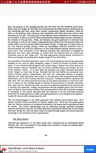

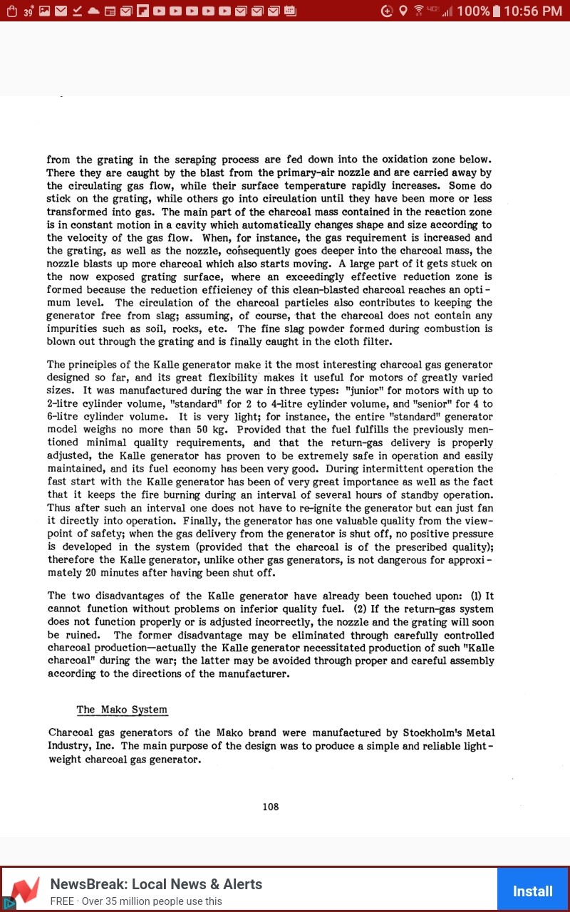

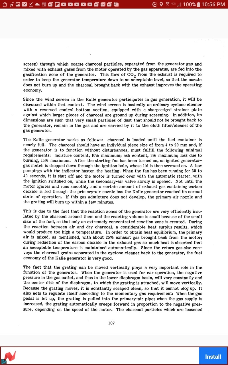

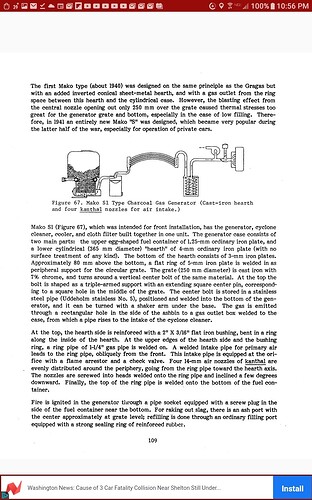

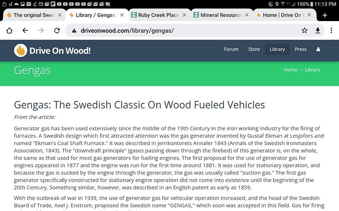

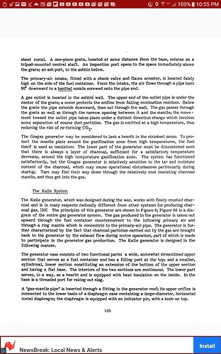

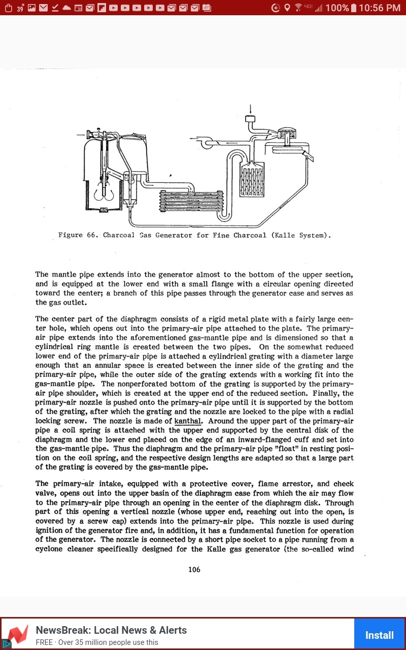

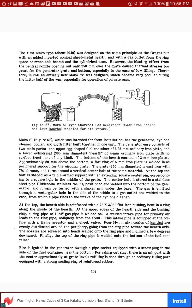

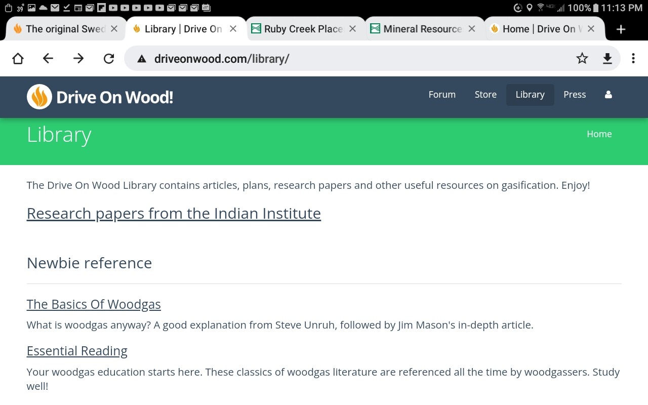

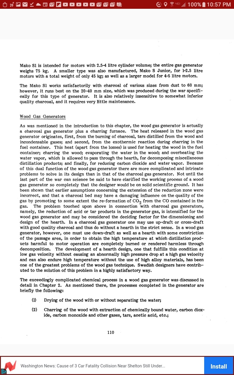

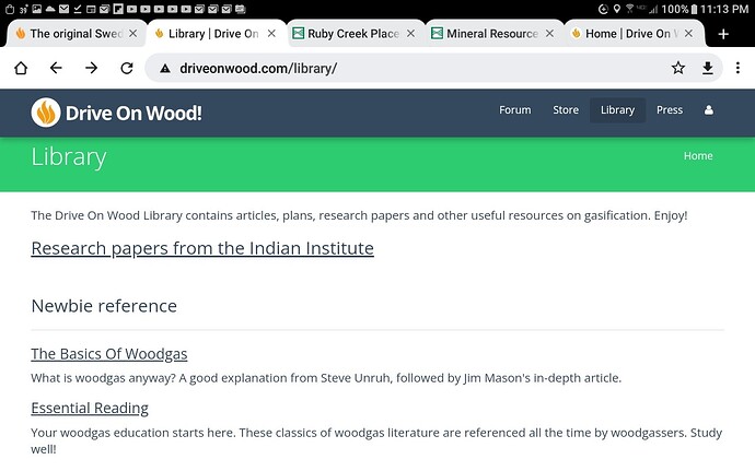

Hi Joni, here is a diagram and some information on this gasifer.

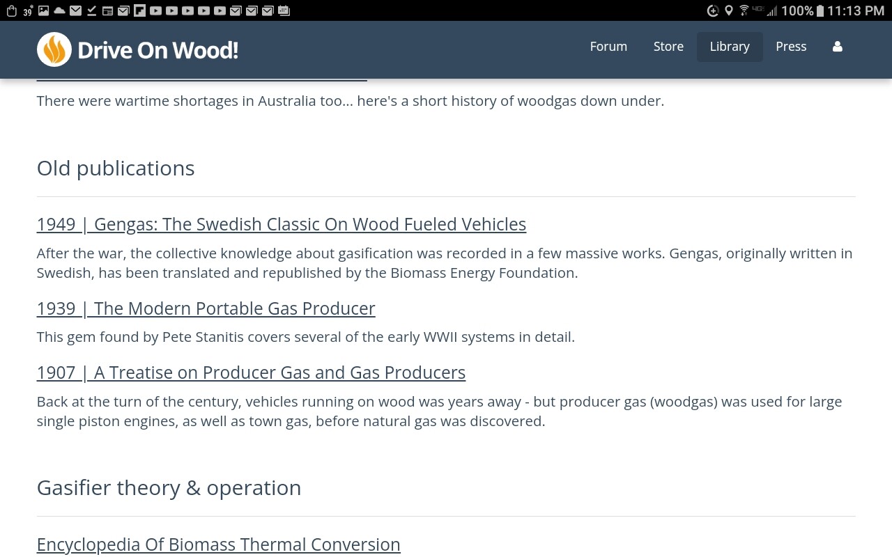

You will find this information in our Library under Swedish gengas the first down load.
BobMac you must have a steel trap mind to have FIRST read this information Bulk. Then remembered and able to bring out just the relevant sections.

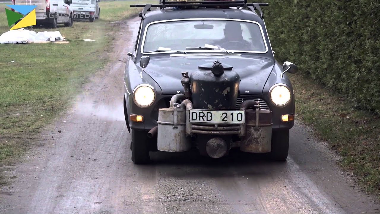

So on the video Volvo front mounted system . . . .
the obvious central branched double wyed air-in system . . . answered here . . .
I believe now it IS A CHARCOAL designed system. That top smaller pipe branch from the vehicle grill side is probably engine exhaust bled in. EGR for heat moderation.
The in-place charcoal was obviously pre-made of larger wood sections than the twigs chop and cones he was overtop refilling with.
So he was fuel supplementing.
Note how extensive he was rodding down to clear the char fines made and raw wood hollows made.
So no magic eats all forest floor raked up duff system.
Just a damn good old operator knowing how he could stretch a systems capabilities.
Very interesting the mid-text explanations on the MACO system. Started as a central air jet. To heat stressful at fuel load run downs. “Char-glow”.
Evolved then to an air ring with individual replaceable jet nozzles. But down draft on a charcoal system.
60 years later and we have evolved back with Kristijans double flute charcoal down draft system. Ha! Able to use a bit of wood mix, too.

Yes it is a charcoal system, in the video when looking into the hopper the only wood I saw was little twigs small sticks. The larger pieces were charcoal all about the same size.
Interesting build on it’s internal working parts. Not simple to build.
I remember reading this write up a few years ago and the drawing of the system.
