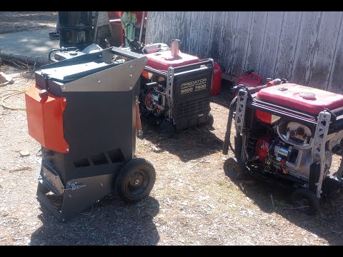

Ok so this is for Matt. This is what i have been working on this winter. New shop, upgraded my plasma cutter and worked on my gasafier. Im sure u can see where my inspiration comes from. Hopefully flare test next weekend.Processing: 20240420_083309.jpg…

Your pics didnt load would love to see them!
ok well try again
Just returned from the shop. A few more photos.
Man you must really want a job here? lol
I would think that it was a build from Matt’s shop. Good job!
I just watch and pay attention to what works and that is what i strive for. Im getting much better in designing and plasma cutting and welding. I love metal.
Awesome workmanship, I love the smiley face you put in.

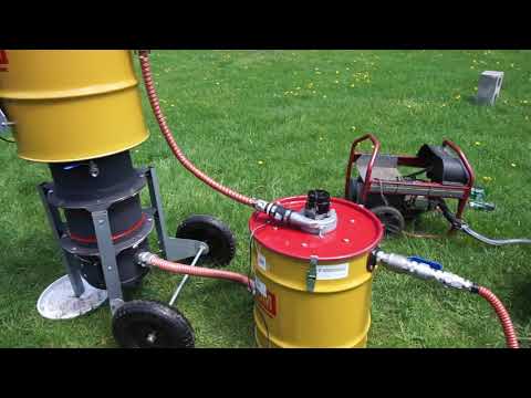

Ok first test run was a success. I had to run it on store bought charcoal for now. 30gal hopper is a lot to fill. This was so much easier to run than the ammo can. Next is to get cracking on my own charcoal. This is awesome!!
You are going to have to do something else at the output. We added a gas cooler to the back of those machines. The gas is too hot for that hose.
