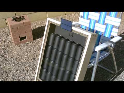

They collect heat pretty well, when it is sunny out the problem is heat losses especially in the winter. Most hoops houses are meant to extend the growing season for a month or two in the spring and fall. If you want a year round greenhouse, it won’t be cost effective without lots of insulation, like insulated glass and most likely heat storage which can be thermal mass heating like rocks.
Instead of mirrors which get expensive, passive solar thermal panels to collect heat, might be a better solution. In this video his heater is going from 42F to 150F. There are plenty of other designs. They are basically a black box.

It is basically an insulated box, and if you have access to leftover building materials, you can do it really cheap. It is called passive solar heating. I have seen clear fiberglass corrogated roofing material they use for skylights as well as glass, clear plastic. then just foam insulation. You can pump the air into your shop, your house, your greenhouse, etc. and then fold it up at the end of winter and stack it out of the way.
Honestly, you could probably make it out of a pallet by knocking off like the top boards, lining it with insulation then putting a cover over it. IF you want water, then you just run a hose or tube in it, then pump water through it. It adds complication and cost. The way to make it work is using stuff cheap and free. Simply because PV is so cheap, if you are buying everything new, it ends up to be about the same price as solar panels and less useful.
THANKS for the info-that looks not to hard to build, are you sure it is only in the 40’s degrees F and putting out 150 F- that sounds to good to be true, we get fair emount of sun most of the winter time,spring and fall. THAT LOOKS WELL WORTH BUILDING.
