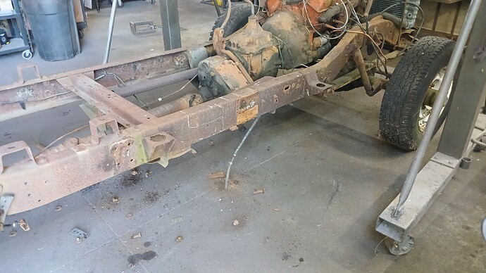

Its sitting out back I dont have room in the shop right now. I chopped the frame down to short box spec’s and have to order new leafs for it and dont have the funds for that. So I need to get the chassis built before I can drop the cab back onto it. You need to buy a gasifier so I can order truck parts!! Tom!! :slight_smile:

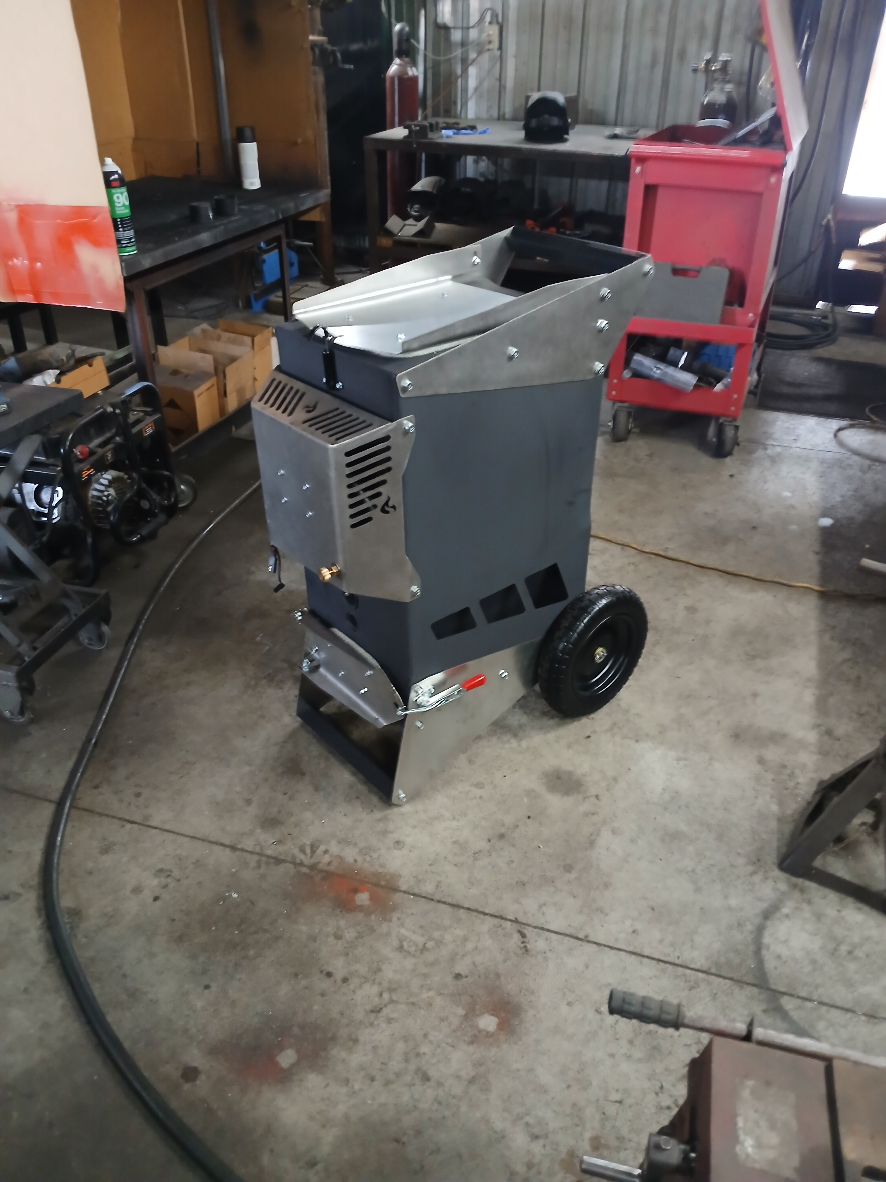

Going the Swedish way with alle the stainless? Looking good! Your plasma cutter is doing a great job, no room for mistakes with stainless.
Yeah its three times more expensive.
A sheet of 60X120 14 ga mild steel P&O is roughly $120 bucks
A sheet of 304 SS same size and ga is $370 bucks.
I only weld the what is now the pump shield and I only have to stitch weld that together and then the Blower adapter and jet.
The rest of trhe parts I just have to clean up after the CNC Plasma and hit with an orbital and call it good. I dont have to paint it so I dont have that cost. But I go thru a LOT flap wheels grinding the edges off.

No I dont think that will work. Just need good quality flap wheels and they tear that stuff off. This is the back side anyways. Then I run it around outer edge perpendicular to the faces sides. It dont take long and Id rather do that then paint.
But yeah that was why I made this change as the paint dont hold up and those parts start to surface rust.

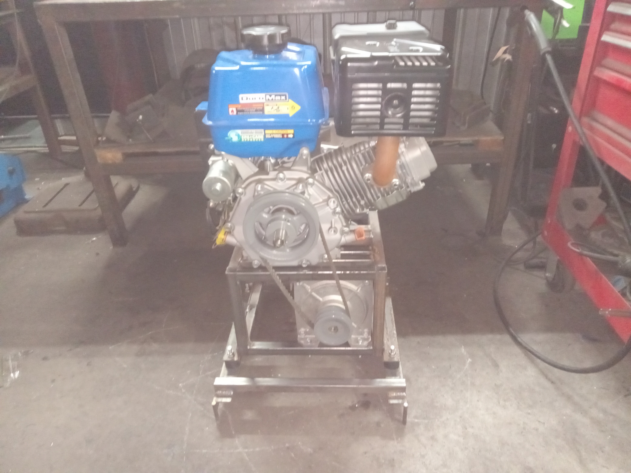

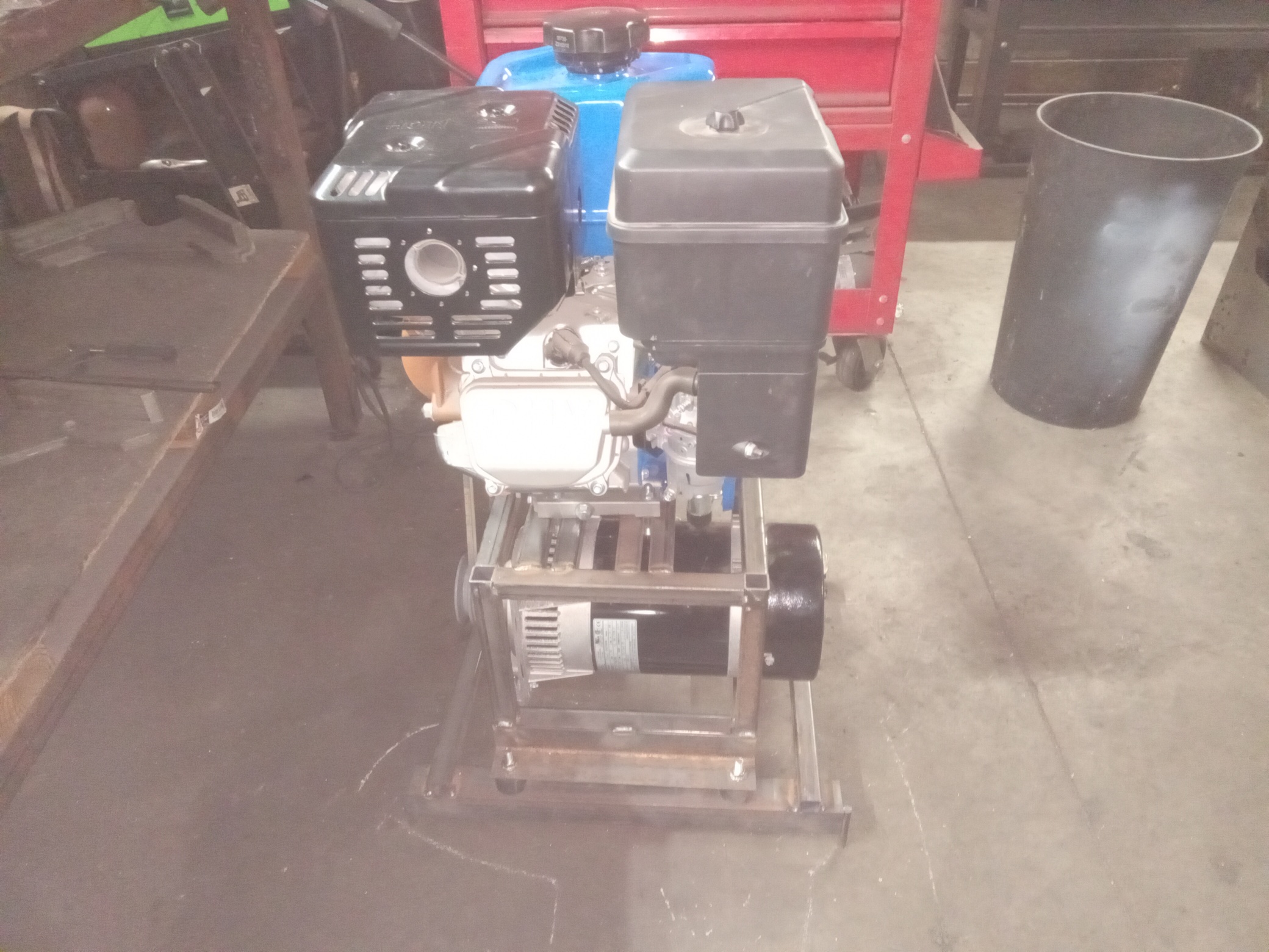

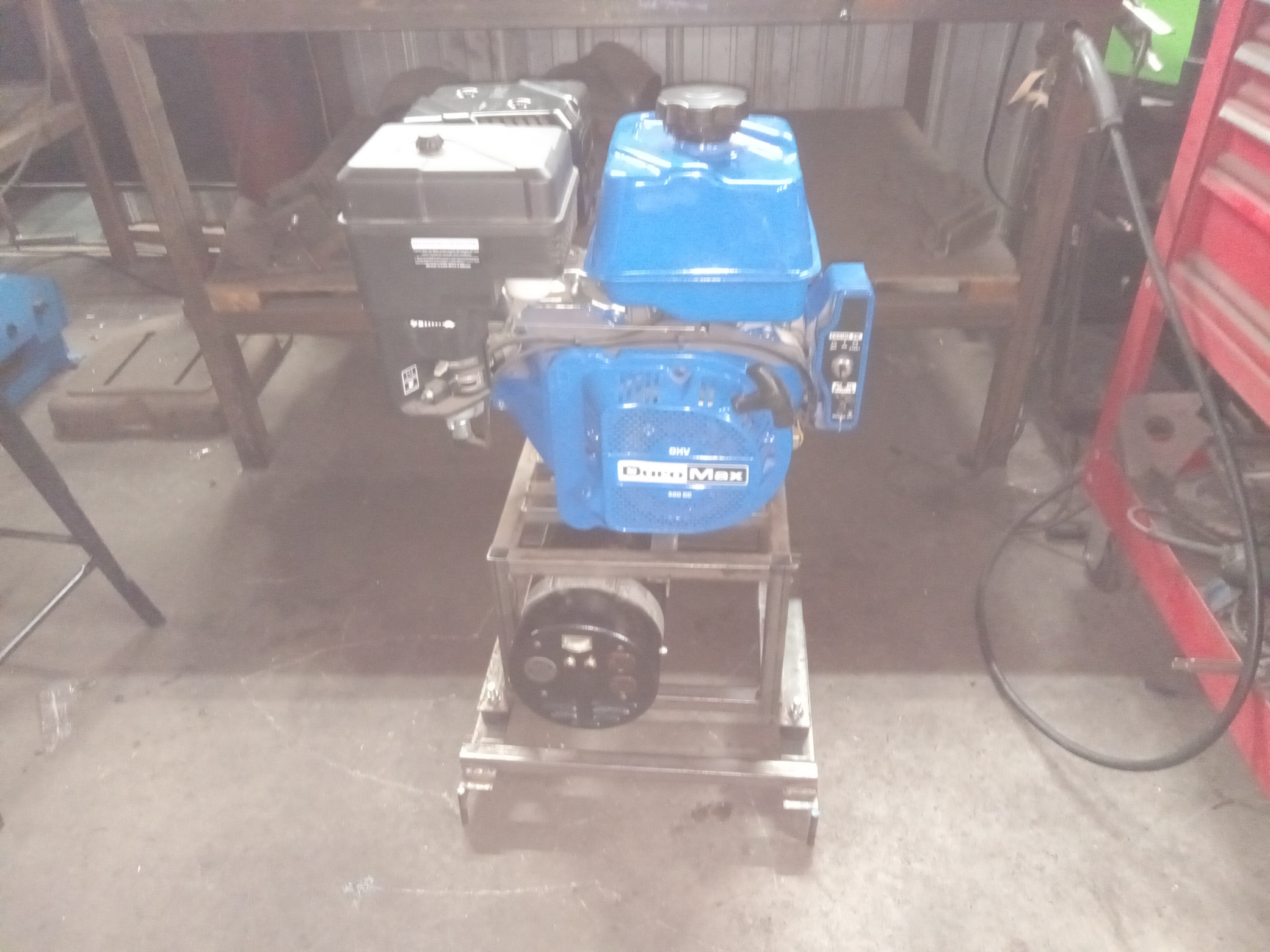

Built this today. This wil be a new product that should be easy to manufacture. It will just be this frame with pulley set to fit what ever range of engine displacement desired and then there is a base it will sit on. Now that I can 3D print belt guards that will make it viable to re produce. Then later there will be an 80/20 frame set that the user can DIY thier own panels. Ill just get a mark up and pass it along.
This will be a better solution for off grid folks than just buying an all new generator every year. These off the shelf generators just are not worth the effort to rebuild them. So with this set up its designed around the NorthStar 5500 belt drive generator head. When this straight shaft engine needs overhall, it can be easiliy removed and re ringed or get a new one and then re build it later for next years overhaul.

What is going on here?? This is a 3600 rpm head. I have a 3.45" on the gen head (3.45 X 2 = 6.9" ) < Right?? So on the motor I put a 5.95" sheave so its actually undersize to get more rpm. What am I missing. Am I miss calculating using diamters instead of circumfrance?
Yeah blew to many volts in that chargeverter and cooked it. :frowning: really bumbed about that as that is a really good charger.
So I hooked it up to the onboard charger in the EG4 as that has a read out and yeah I cant even run it at idle at its lowest RPM and its outputing 140 volts.
Well after some more fiddling. Its actually right. The issue there is no volage regulator and the chargers are too sensitive. So I have to put a space heater to load it down to get the voltage in range then shut it off at the right time once the charger engages and takes over the load. What a PITA.
Im looking at either reducing the sheave on the engine or enlarging the one on the gen head. I think Im going to go with a 1 inch larger one on the gen head. I think going bigger will be better as that will have more belt surface area plus more inertia verses reducing; if I go smaller on the engine side.
Either way the engine will have more RPM inertia plus farther into the power curve. So hopefully I can then get in voltage range and it will sustain loading from the charger without falling out of range.
