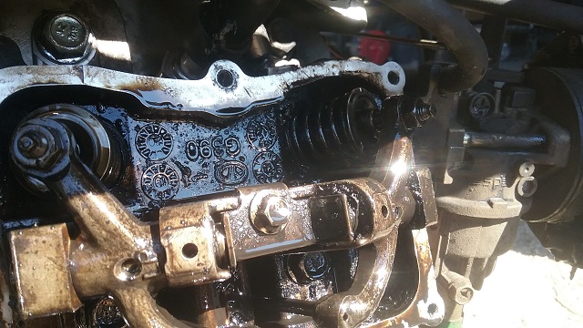

I popped off the valve cover the other to inspect for grease accumulation. I thought for sure there would be a big glob of grease sitting in there. Nope looks all normal, it probably just melts away into the oil. As long as its not excesive should be ok and if your making that much tar oil needs frequent changing anyways.

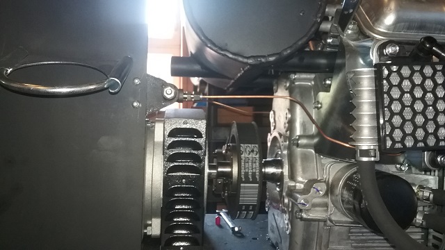

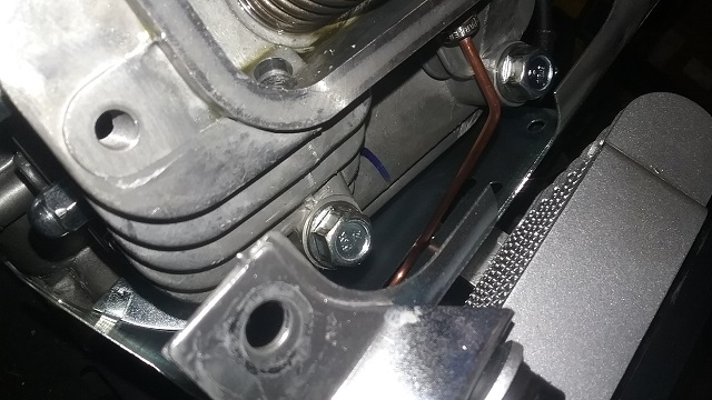

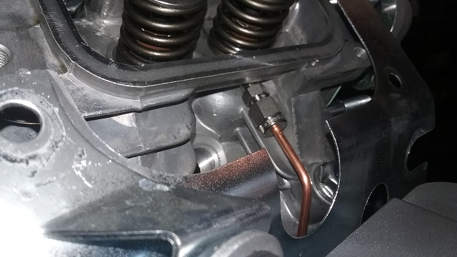

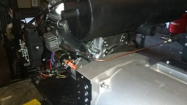

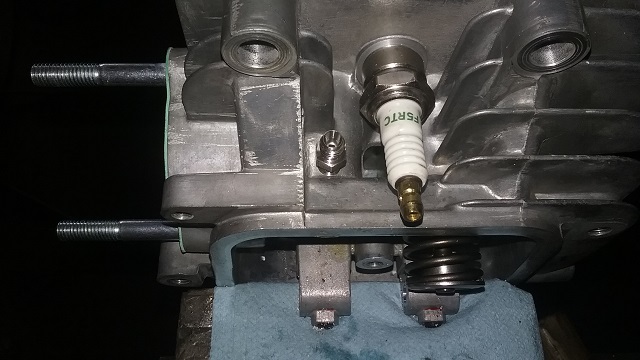

So I did the grease fitting install on the Predator twin, turned out very nice here are few pics Ill follow up tomorrow with the rest of the install. Been pretty busy the last week and half writing code for the next gen system. Ive learned a great deal with I2C communication in a very short time. Its really cool how it works and has freed up a lot of inputs as this only requires two wires.

So here are the other pics of this completed. pretty straight forward.
