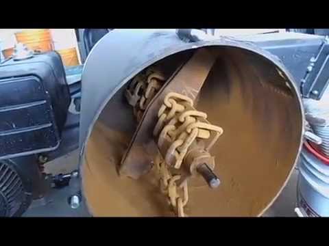

So here is a hammer mill for rock crushing. With something like this, a cheap wood chipper from Harbor Freight would work perfect for pellet milling. Even the mulcher feature could be used here.
