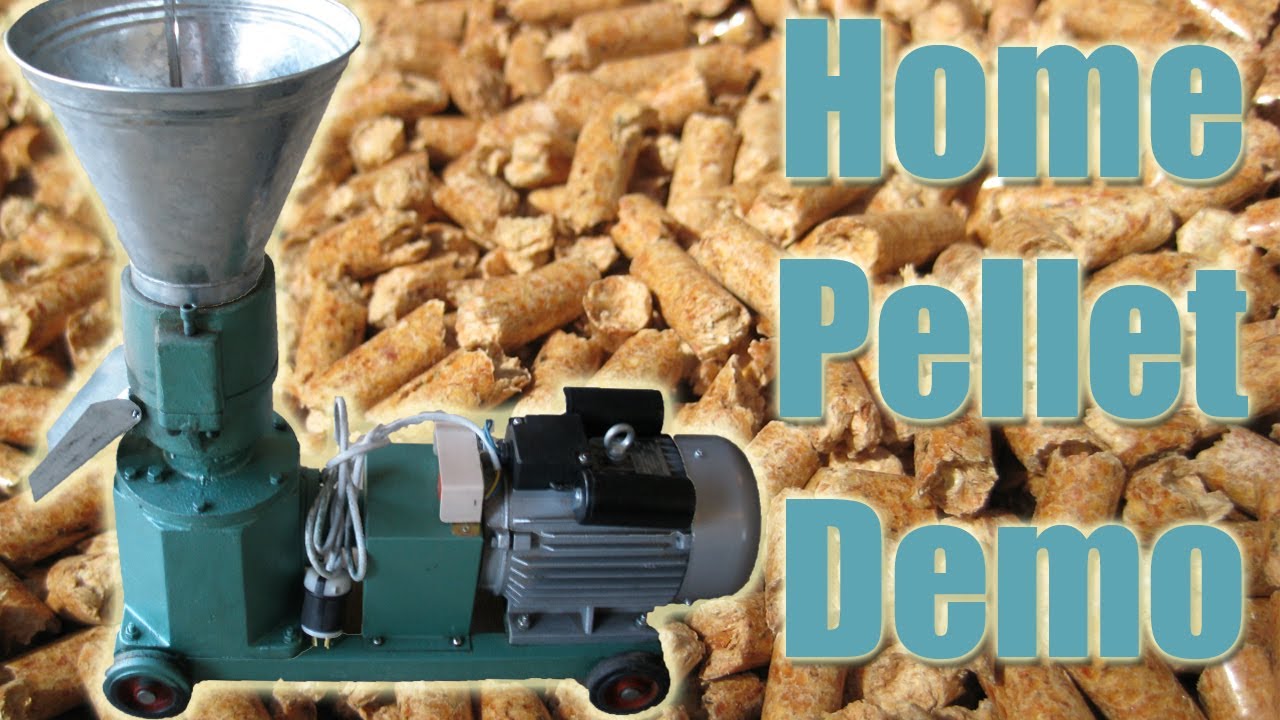

Note the steam pooring off these pellets. Granted this is a PTO driven unit; however, its still the same mill used with the small engine powered versions. The tractor is bit over kill here.
That is also the beauty of the pellet mill. You not just limited to woody biomass.
Watch this video too the end, if this can do this to Rocks it can certainly pulverized biomass. It does rather fast and effortless.

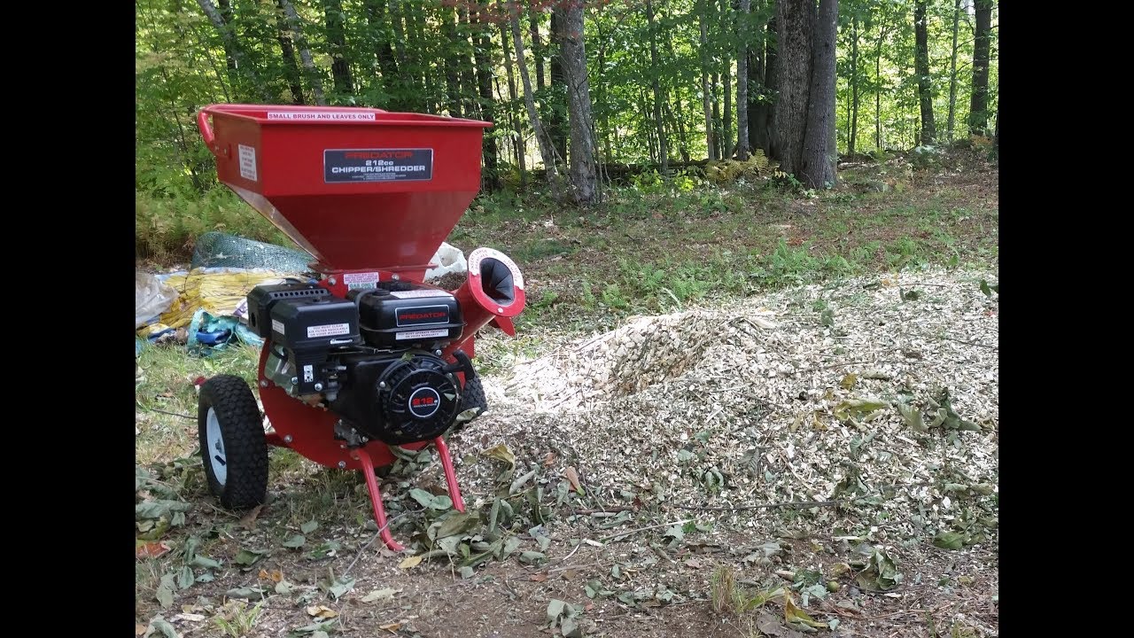

Harbor Fright chipper. Even though they dont make the best chips for gasifying. I love my little chipper and would be perfect for pellet milling. I attach the hammer mill directly to mine and also drive it from this chipper along with the pellet mill. So probably that same PTO driven pellet mill. The engine will be replaced with the 670 Predator V twin with fly wheel.

No just some heavy bearings a shaft with chain welded to it. Pretty easy. You could make your own pellet mill as well. There are some good videos how to make them.
I am planning to make a hydraulic ram type press for on-board process machines. I will most likely pursue that before making the all in one unit.
Just search Ebay and Amazon. But before you buy make sure you contact the seller and make sure they understand your usage first.
I will check out some of them Diy pellot mill vidios, see if i have enough tools too build i have no machine shop machines.
Just a couple of wood chip comments:
When I tried running my oversize wood chips through a hammer mill, all I got was a stringy mess.
Even with the largest screen I had.
Think twice about having loads of wood chips dumped in your yard.
  1. They start to heat up and to mold almost immediately, from the inside out.
  2. If the chipping was done in the spring, you really have a wet, stringy mess to deal with. Best chips are made after the leaves are off the trees.
  3. The largest wood chips (IMHO) are made with a disk chipper, not a drum chipper.
  4. You need to see where the chips came from. If the tree service is cleaning up brush, don’t bother. You need chips from a site where they are chipping large branches and/or whole trees.
    Greg Manning has said that he won’t ever chip anything smaller than 1 inch in diameter (or is it 2 cm up there in Canada?)
