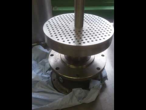

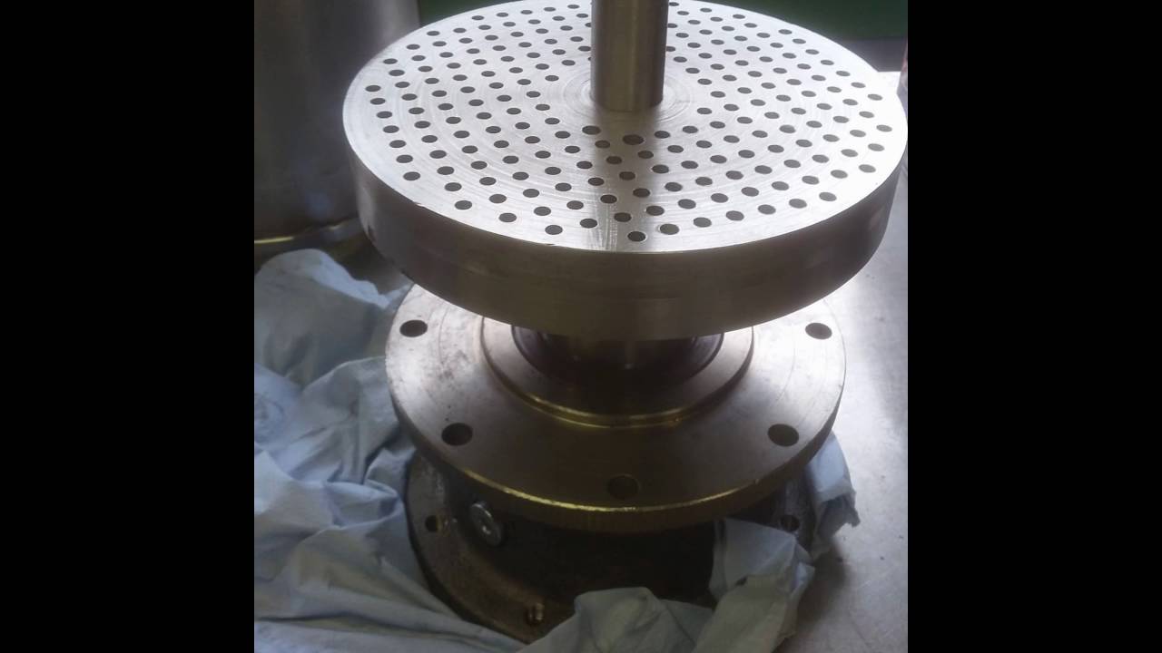

If you have a printer you can print out all the hole centers onto piece of paper then tape this to the stock peace for making the die. The precisely center punch all your holes. Your Welcome!!

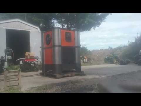

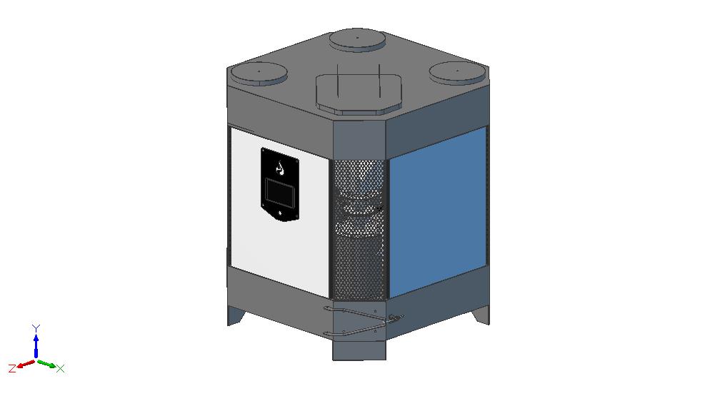

This machine CAD Model will have a 10 hour run time and produce 5 kW of power. It will sell for around $10,000.00 USD. This machine has a foot print of 1 meter x 1 meter this is extremely compact for a fully integrated machine output 5 kiW of power.
It would be impossible to to do this with any other biomass fueled machine in this foot print and compact size. The cost would be nearly twice this for the chip machine counter part. If you think that lady is putting in hard labor running that pellet mill that is nothing compared to sorting and dry chips.
Then if you are relying on this this for a daily off grid solution, and your constantly fiddling with it and dealing with engine stalling. You’ll get it.

Here if you want make a pellet mill. this is the cheap and easy way to do it.

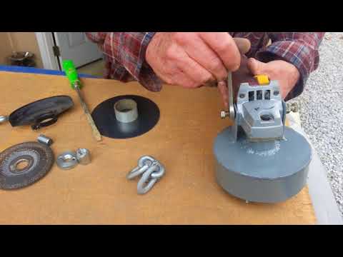

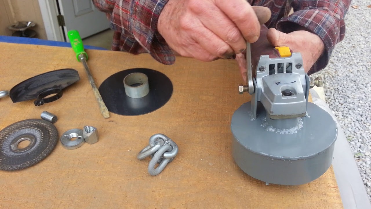

Here is your how too video. If this hand grinder can do this, I refuse to believe that this is “high energy input” 600 watts to do what that grinder does in seconds!!!

Im going to make mine; $350.00 bucks for the 5" die set is hard to beat. I can make the rest pretty easily.
