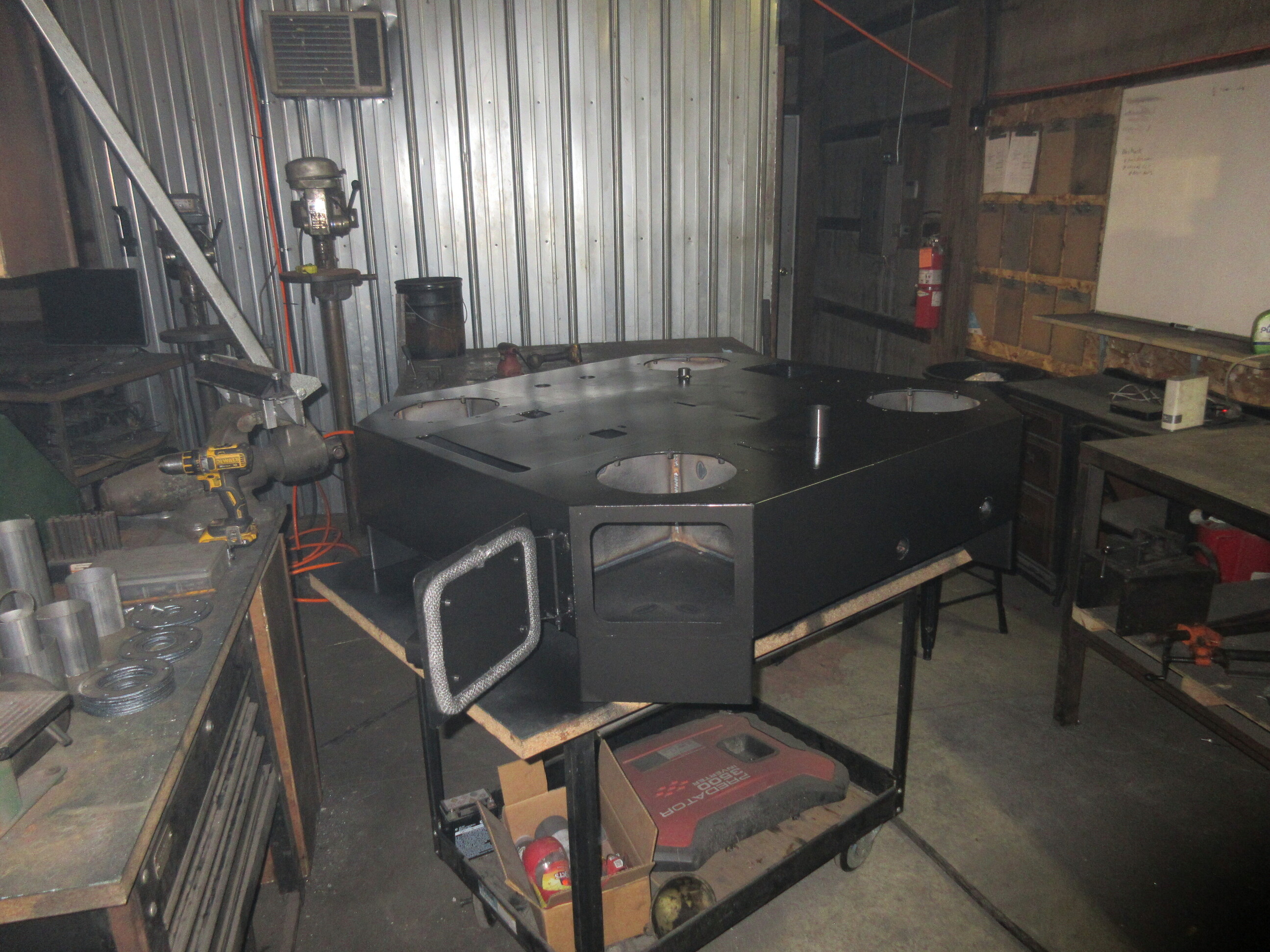

First base is complete, Ill start assembling the engine and generator it as soon as next week.
I have decided to re brand all products under the Fusion product line.
Hi matt R is this a toltal redesign change over from your earlyer models, what the main gain on this model from the other models may i ask. just curious & caint remember half what i read.
This gets away from roll forming processes and parts reduction. Eliminates the expensive SS cover shrouds, while opening up the unit so it can breath better. This model the liquid cooled gas chiller is eliminated, the auger feed is eliminated, the CHP is eliminated, the mid divider section is eliminated. Its design is cleaner and simpler and will help standard the build process.
CHP will come as an add on system reclaiming engine exhaust. The gas chiller can also be bought as an add on only if used for CHP. All the pumps and chiller systems added too much cost driving it beyond what the market is willing to pay.

Yeah so not going down that road, they want all that but dont want to pay the extra cost and only view the electrical output and dismiss the heat energy reclaim systems that add a ton of cost.
I can now build this 5 kW for $10,000.00 USD
That comes with a Honda GX 690 I might add.
There is a Try pillar design coming as well. This will replace the Utility / Works units. Im going to bower this design and build a try pillar stand alone gasifier system in this same format. So all new units will follow the same basic format and foundations.
